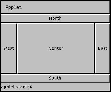

Here is an example of five buttons in an applet laid out using
the BorderLayout layout manager:
The code for this applet is as follows:
import java.awt.*;
import java.applet.Applet;
public class buttonDir extends Applet {
public void init() {
setLayout(new BorderLayout());
add(new Button("North"), BorderLayout.NORTH);
add(new Button("South"), BorderLayout.SOUTH);
add(new Button("East"), BorderLayout.EAST);
add(new Button("West"), BorderLayout.WEST);
add(new Button("Center"), BorderLayout.CENTER);
