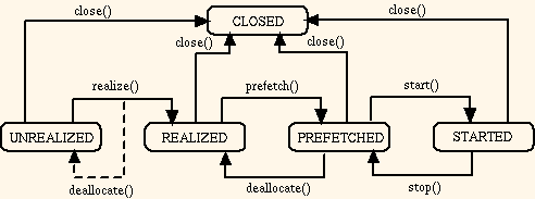

APlayer
has five states: UNREALIZED, REALIZED, PREFETCHED, STARTED, CLOSED.The purpose of these life-cycle states is to provide programmatic control over potentially time-consuming operations. For example, when a
Player
is first constructed, it's in the UNREALIZED state. Transitioned from UNREALIZED to REALIZED, thePlayer
performs the communication necessary to locate all of the resources it needs to function (such as communicating with a server or a file system). Therealize
method allows an application to initiate this potentially time-consuming process at an appropriate time.Typically, a
Player
moves from the UNREALIZED state to the REALIZED state, then to the PREFETCHED state, and finally on to the STARTED state.A
Player
stops when it reaches the end of media; when its stop time is reached; or when thestop
method is invoked. When that happens, thePlayer
moves from the STARTED state back to the PREFETCHED state. It is then ready to repeat the cycle.To use a
Player
, you must set up parameters to manage its movement through these life-cycle states and then move it through the states using thePlayer
's state transition methods.
This section describes the semantics of each of thePlayer
states.UNREALIZED State
APlayer
starts in the UNREALIZED state. An unrealizedPlayer
does not have enough information to acquire all the resources it needs to function.The following methods must not be used when the
Player
is in the UNREALIZED state.An
getContentType
setTimeBase
getTimeBase
setMediaTime
getControls
getControl
IllegalStateException
will be thrown.The
realize
method transitions thePlayer
from the UNREALIZED state to the REALIZED state.REALIZED State
APlayer
is in the REALIZED state when it has obtained the information required to acquire the media resources. Realizing aPlayer
can be a resource and time consuming process. ThePlayer
may have to communicate with a server, read a file, or interact with a set of objects.Although a realized
Player
does not have to acquire any resources, it is likely to have acquired all of the resources it needs except those that imply exclusive use of a scarce system resource, such as an audio device.Normally, a
Player
moves from the UNREALIZED state to the REALIZED state. Afterrealize
has been invoked on aPlayer
, the only way it can return to the UNREALIZED state is ifdeallocate
is invoked beforerealize
is completed. Once aPlayer
reaches the REALIZED state, it never returns to the UNREALIZED state. It remains in one of four states: REALIZED, PREFETCHED, STARTED or CLOSED.PREFETCHED State
Once realized, aPlayer
may still need to perform a number of time-consuming tasks before it is ready to be started. For example, it may need to acquire scarce or exclusive resources, fill buffers with media data, or perform other start-up processing. Callingprefetch
on thePlayer
carries out these tasks.Once a
Player
is in the PREFETCHED state, it may be started. Prefetching reduces the startup latency of aPlayer
to the minimum possible value.When a started
Player
stops, it returns to the PREFETCHED state.STARTED State
Once prefetched, aPlayer
can enter the STARTED state by calling thestart
method. A STARTEDPlayer
means thePlayer
is running and processing data. APlayer
returns to the PREFETCHED state when it stops, because thestop
method was invoked, it has reached the end of the media, or its stop time.When the
Player
moves from the PREFETCHED to the STARTED state, it posts aSTARTED
event. When it moves from the STARTED state to the PREFETCHED state, it posts aSTOPPED
,END_OF_MEDIA
orSTOPPED_AT_TIME
event depending on the reason it stopped.The following methods must not be used when the
Player
is in the STARTED state:An
setTimeBase
setLoopCount
will be thrown.CLOSED state
CallingTheclose
on thePlayer
puts it in the CLOSED state. In the CLOSED state, thePlayer
has released most of its resources and must not be used again.Player
's five states and the state transition methods are summarized in the following diagram:

If the Player
cannot obtain all
of the resources it needs, it throws a MediaException
When that happens, the Player
will not be able to
start. However, prefetch
may be called again when
the needed resource is later released perhaps by another
Player
or application.

.void start() throws MediaException
Player
as soon as possible.
If the Player
was previously stopped
by calling stop
or reaching a preset
stop time, it will resume playback
from where it was previously stopped. If the
Player
has reached the end of media,
calling start
will automatically
start the playback from the start of the media.
When start
returns successfully,
the Player
must have been started and
a STARTED
event will
be delivered to the registered PlayerListener
s.
However, the Player
is not guaranteed to be in
the STARTED state. The Player
may have
already stopped (in the PREFETCHED state) because
the media has 0 or a very short duration.
If start
is called when the Player
is in the UNREALIZED or REALIZED state,
it will implicitly call prefetch
If start
is in the STARTED state,
the request will be ignored.

.void stop() throws MediaException
Player
. It will pause the playback at
the current media time.
When stop
returns, the Player
is in the
PREFETCHED state.
A STOPPED
event will be delivered to the registered
PlayerListener
s.
If stop
is called on
a stopped Player
, the request is ignored.
java.lang.IllegalStateException
- Thrown if the Player
is in the CLOSED state.MediaException
cannot be stopped.void deallocate()
Player
When deallocate
returns, the Player
is in the UNREALIZED or REALIZED state.
If the Player
is blocked at
the realize
call while realizing, calling
deallocate
unblocks the realize
call and
returns the Player
Otherwise, calling deallocate
returns the
Player
If deallocate
state, the request is ignored.
If the Player
is STARTED
when deallocate
is called, deallocate
will implicitly call stop
on the Player
is in the CLOSED state.void close()
Player
and release its resources.
When the method returns, the Player
is in the
CLOSED state and can no longer be used.
A CLOSED
PlayerListener
s.
If close
is called on a closed Player
