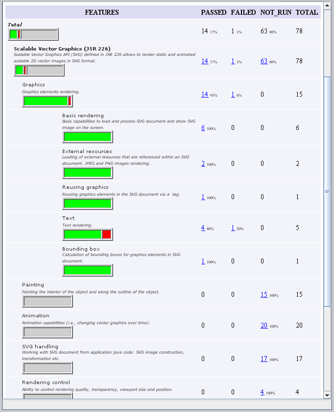

When a test pack has a feature definition file, test results can be reported by feature as shown in FIGURE 22-6. The feature-based report makes it easy to see what features have problems and which features have not been tested.
FIGURE 22-6 Feature-based Report
