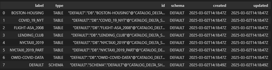

예제
import json
import pandas as pd
# catalog api function call
r = Catalog.get_catalog_entities('CATALOG_DELTA_SHARING_1')
# pandas data frame representation
j = json.loads(r)
pd.json_normalize(j)
