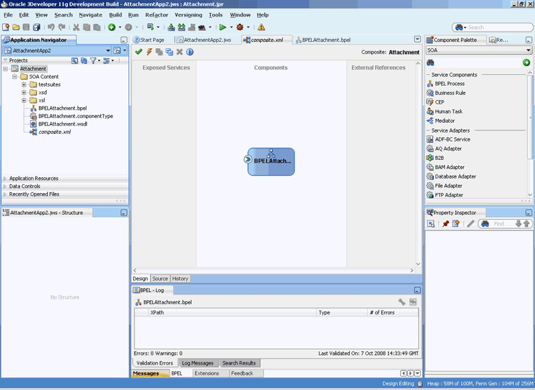

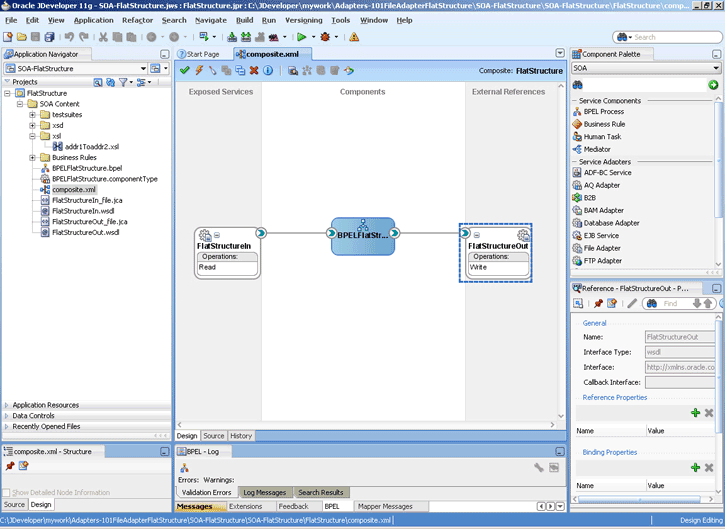

The Oracle File and FTP Adapters are automatically integrated with Oracle BPEL PM. When you drag and drop File Adapter for FTP Adapter from the Component Palette of JDeveloper BPEL Designer, the Adapter Configuration Wizard starts with a Welcome page, as shown in Figure 4-1.
Figure 4-1 The Adapter Configuration Wizard - Welcome Page
This wizard enables you to select and configure the Oracle File and FTP Adapters. The Adapter Configuration Wizard then prompts you to enter a service name, as shown in Figure 4-2.
Figure 4-2 The Adapter Configuration Wizard - Service Name Page
When configuration is complete, a WSDL and JCA file pair is created in the Application Navigator section of Oracle JDeveloper. (JDeveloper) This JCA file contains the configuration information you specify in the Adapter Configuration Wizard.

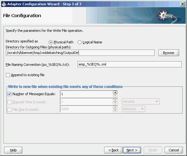

The outbound Oracle File and FTP Adapters have parameters for the outbound directory in which to write the file and the file naming convention to use.
You must use the Adapter Configuration Wizard to modify the configuration parameters, such as publish size, number of messages, and polling frequency.You must not manually change the value of these parameters in JCA files.

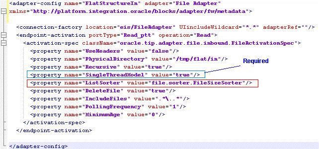

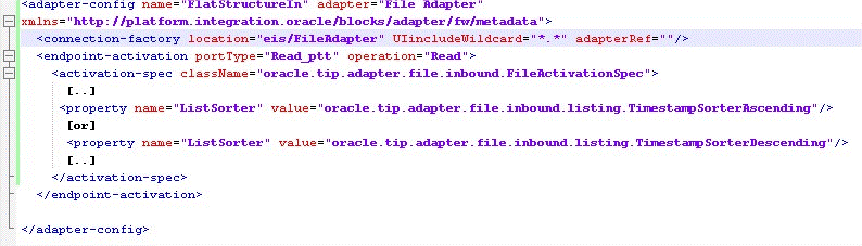

When files must be processed by Oracle File and FTP Adapters in a particular order, you must configure the sorting parameters. For example, you can configure the sorting parameters for Oracle File and FTP Adapters to process files in ascending or descending order by time stamps.
You must meet the following prerequisites for sorting scenarios of Oracle File and FTP Adapters:
Use a synchronous operation
Add the following property to the inbound JCA file:
<property name="ListSorter" value="oracle.tip.adapter.file.inbound.listing.TimestampSorterAscending"/> <property name="SingleThreadModel" value="true"/>

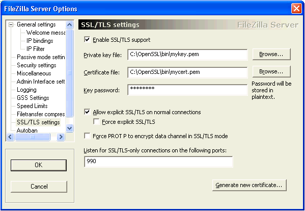

The Oracle FTP Adapter supports FTP over SSL (FTPS) and Secure FTP (SFTP) to enable secure file transfer over a network.
For more information, see Section 4.4.3, "Using Secure FTP with the Oracle FTP Adapter" and Section 4.4.4, "Using SFTP with Oracle FTP Adapter."

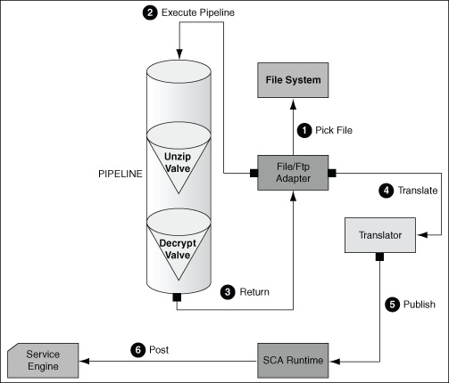

The mechanism for pre-processing and post-processing of files is configured as pipelines and valves. This section describes the concept of pipelines and valves.
A pipeline consists of a series of custom-defined valves. A pipeline loads a stream from the file system, subjects the stream to processing by an ordered sequence of valves, and after the processing returns the modified stream to the adapter.
A valve is the primary component of execution in a processing pipeline. A valve processes the content it receives and forwards the processed content to the next valve. For example, in a scenario where the Oracle File and FTP Adapters receive files that are encrypted and zipped, you can configure a pipeline with an unzip valve followed by a decryption valve. The unzip valve extracts the file content before forwarding it to the decryption valve, which decrypts the content and the final content is made available to the Oracle File or FTP Adapter as shown in Figure 4-4.

<adapter-config name="FileInUnzip" adapter="File Adapter"
xmlns="http://platform.integration.oracle/blocks/adapter/fw/metadata">
<connection-factory location="eis/FileAdapter" UIincludeWildcard="*.zip"
adapterRef=""/>
<endpoint-activation portType="Read_ptt" operation="Read">
<activation-spec
className="oracle.tip.adapter.file.inbound.FileActivationSpec">
<property../>
<property name="PipelineValves"
value="valves.SimpleUnzipValve,valves.SimpleDecryptValve"/>
</activation-spec>
</endpoint-activation>
</adapter-config>
There is no space after the comma (,) in the PipelineValves property value.Note:
If you configure a pipeline using the"PipelineValves" property, then you cannot configure additional metadata such as Re-entrant Valve and Batch Notification Handler. Additional metadata can be configured only with "PipelineFile" that is used for the XML-based approach.The re-entrant valve enables you to process individual entries within a zip file. In a scenario that involves processing all entries within a zip file, wherein each entry is encrypted using the Data Encryption Standard (DES), you can configure the valve by adding the reentrant="true" attribute to the unzip valve as follows:
<?xml version="1.0"?>
<pipeline xmlns="http://www.oracle.com/adapter/pipeline/">
<valves>
<valve reentrant="true">valves.ReentrantUnzipValve</valve>
<valve> valves.SimpleDecryptValve </valve>
</valves>
</pipeline>
In this example, the pipeline invokes the ReentrantUnzipValve and then the SimpleDecryptValve repeatedly in the same order until the entire zip file has been processed. In other words, the ReentrantUnzipValve is invoked first to return the data from the first zipped entry, which is then fed to the SimpleDecryptValve for decryption, and the final content is returned to the adapter. The process repeats until all the entries within the zip file are processed.
Additionally, the valve must set the message key using the setMessageKey() API. For more information refer to Appendix B, "An Unzip Valve for processing Multiple Files."
If there are translation errors for individual entries within the zip file, then entries with the translation errors are rejected and the other entries are processed.
If there are errors during the publish operation, then the publish operation is retried and the retry semantic holds. If the retry semantic does not hold, then the original file is rejected and the pipeline ends.
The BatchNotificationHandler API is used with the Oracle File and FTP Adapter inbound de-batchability. In a de-batching scenario, each file contains multiple messages, and some sort of bookkeeping is required for crash-recovery. This is facilitated by the BatchNotificationHandler API, which lets you receive notification from the pipeline whenever a batch begins, occurs, or ends. The following is the BatchNotificationHandler interface:
package oracle.tip.pc.services.pipeline; /* * Whenever the caller processes de-batchable files, each file can * have multiple messages and this handler allows the user to plug in * a notification mechanism into the pipeline. * * This is particularly useful in crash recovery situations */ public interface BatchNotificationHandler { /* * The Pipeline instance is set by the PipelineFactory when the * BatchNotificationHandler instance is created */ public void setPipeline(Pipeline pipeline); public Pipeline getPipeline(); /* * Called when the BatchNotificationHandler is instantiated */ public void initialize(); /* * Called by the adapter when a batch begins, the implementation must return * a BatchContext instance with the following information: * i) batchId: a unique id that will be returned every time onBatch is invoked by called * ii)line/col/record/offset: for error recovery cases */ public BatchContext onBatchBegin(); /* * Called by the adapter when a batch is submitted. The parameter holds the * line/column/record/offset for the successful batch that is published. * Here the implementation must save these in order to recover from crashes */ public void onBatch(BatchContext ctx); /* * Called by the adapter when a batch completes. This must be used to clean * up */ public void onBatchCompletion(boolean success); }
To use a pipeline with de-batching, you must configure the pipeline with a BatchNotificationHandler instance as follows:
<?xml version="1.0"?> <pipeline xmlns="http://www.oracle.com/adapter/pipeline/" batchNotificationHandler="oracle.tip.pc.services.pipeline.ConsoleBatchNotificationHandler"> <valves> <valve reentrant="true">valves.SimpleUnzipValve</valve> <valve>valves.SimpleDecryptValve</valve> </valves> </pipeline>

You can modify the default threading behavior of Oracle File and FTP Adapters. Modifying the threading model results in a modified throttling behavior of Oracle File and FTP Adapters. The following sections describe the modified threading behavior of the Oracle File and FTP Adapters:
The single threaded model is a modified threaded model that enables the poller to assume the role of a processor. The poller thread processes the files in the same thread. The global pool of processor threads is not used in this model. You can define the property for a single threaded model in the inbound JCA file as follows:
<activation-spec className="oracle.tip.adapter.file.inbound.FileActivationSpec"> <property../> <property name="SingleThreadModel" value="true"/> <property../> </activation-spec>
The partitioned threaded model is a modified threaded model in which the in-memory queue is partitioned and each composite application receives its own in-memory queue. The Oracle File and FTP Adapters are enabled to create their own processor threads rather than depend on the global pool of processor worker threads for processing the enqueued files. You can define the property for a partitioned model in the inbound JCA file as follows:
<activation-spec className="oracle.tip.adapter.file.inbound.FileActivationSpec"> <property../> <property name="ThreadCount" value="4"/> <property../> </activation-spec>

The Oracle File and FTP Adapters enable you to configure outbound interactions that append to an existing file. The Append to Existing File option enables the outbound invoke to write to the same file. There are two ways in which you can append to a file name:
Statically - in the JCA file for the outbound Oracle File Adapter
Dynamically - using the header mechanism
The append mode is not supported for SFTP scenarios, where instead of appending to the existing file, the file is overwritten.When you select the Append to existing file option in the File Configuration page, the batching options such as Number of Messages Equals, Elapsed Time Exceeds, File Size Exceeds options are disabled. Figure 4-9 displays the Append to Existing File option.
Figure 4-9 The Adapter Configuration Wizard - File Configuration Page
Batching option is disabled if "Append" is chosen in the wizard. In addition, the following error message is displayed if the user specifies a dynamic file naming convention as opposed to a static file naming convention:
You cannot choose to Append Files and use a dynamic file naming convention at the same time

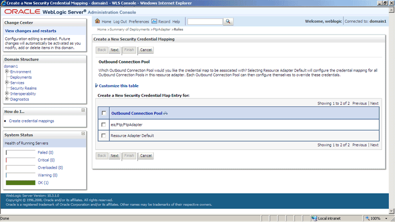

Click New in the Credential Mappings pane. The Create a New Security Credential Mapping page is displayed, as shown in Figure 4-13.
Figure 4-13 The Oracle WebLogic Server Administration Console - Create a New Security Credential Mapping Page
Select eis/Ftp/FtpAdapter (JNDI for Oracle FTP Adapter) to create a security credential map entry for Oracle FTP Adapter, as shown in Figure 4-14.

For the outbound operation, you can specify the outbound directory, outbound file naming convention to use, and, if necessary, the batch file conventions to use.
The File Configuration page of the Adapter Configuration Wizard shown in Figure 4-26 enables you to specify the directory for outgoing files and the outbound file naming convention.
Figure 4-26 The Adapter Configuration Wizard-Parameters for Outgoing Files
The following sections describe the file configuration information to specify:
Section 4.3.2.2.1, "Specifying Outbound Physical or Logical Directory Paths in Oracle BPEL PM"
Section 4.3.2.2.4, "Specifying the Outbound File Naming Convention"
Section 4.3.2.2.5, "Specifying a Dynamic Outbound File Name"
You can specify outbound directory names as physical or logical paths. Physical paths are values such as c:\outputDir.
If you specify logical parameters, then the generated JCA file looks as follows for the logical outbound directory name OutputFileDir.

Select the outbound adapter in the "External References" swim lane in JDeveloper wizard (it is present in the composite.xml tab). Create a "Binding Property" in the Property Inspector for the outbound adapter (you must scroll down to find it). Once the Create Property box appears, enter OutputFileDir in the Name field and the actual output directory name, example, C:\outputDir in the Value field. The composite.xml file appears as follows:
<reference name="FlatStructureOut">
<interface.wsdl
interface="http://xmlns.oracle.com/pcbpel/adapter/file/FlatStructureOut/#wsdl.
interface(Write_ptt)"/>
<binding.jca config="FlatStructureOut_file.jca">
<property name="OutputFileDir" type="xs:string" many="false"
override="may">C:\outputDir</property>
</binding.jca>
</reference>
Ensure that you limit the length of outbound file names (the file name, plus the complete directory path) to 200 characters. This is not an exact limit but rather a recommendation. When an outbound file name is long (for example, 215 characters), a blank file with that name is created in the outbound directory.You can specify outbound directory names as physical or logical paths in Mediator. Physical paths are values such as c:\inputDir.
You can specify the logical names at design time in the File Directories page shown in Figure 4-20 and then provide logical-physical mapping by using the Endpoint properties. For example, WriteFile is an outbound adapter service. You have specified OutDir as the logical directory name during design time.

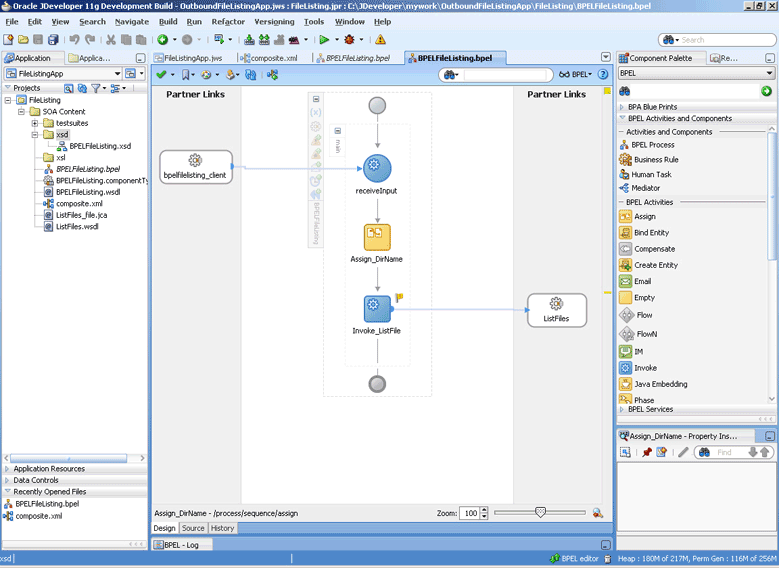

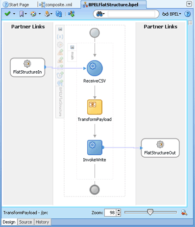

For outbound operation, you can specify a dynamic outbound directory name. You can set variables to specify dynamic outbound directory names.
<?xml version="1.0" encoding="UTF-8"?>
<adapter-config name="ReadAddressChunk" adapter="File Adapter"
<connection-factory location="eis/FileAdapter" adapterRef=""/>
<endpoint-interaction operation="ChunkedRead">
<interaction-spec
className="oracle.tip.adapter.file.outbound.ChunkedInteractionSpec">
<property name="PhysicalDirectory" value="C:\foo"/>
<property name="FileName" value="dummy.txt"/>
<property name="ChunkSize" value="1"/>
</interaction-spec>
</endpoint-interaction>
</adapter-config>
In the preceding example, in the JCA file, the physical directory is set to "C:\foo" but during run time it is dynamically changed to the assigned value. In this example, the physical directory is dynamically changed to "C:\out". You must perform the following steps to specify the dynamic outbound directory name:

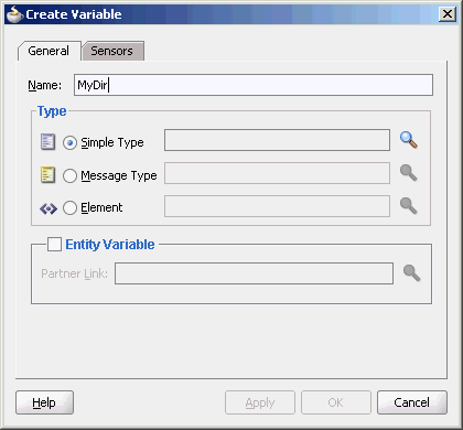

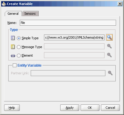

Double-click the invoke activity.
Click the Browse Variables icon.
In the Variable Chooser dialog, click the Create an Object icon.
Create a variable MyDir of type xsd:string, as shown in Figure 4-27.
Drag and drop an Assign activity from the Component Palette in between the Receive and Invoke activities in the design area.
Double-click the assign activity and click the Copy Operation tab.
Click Create and then Copy Operation. The Create Copy Operation dialog is displayed.
In the Create Copy Operation dialog, select Expression from Type and specify the directory name and path, as shown in Figure 4-28. The operation writes the output file to this directory.
Click OK in the Create Copy Operation dialog and then click OK in the Assign dialog. The .bpel page is displayed.

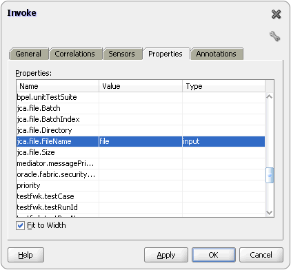

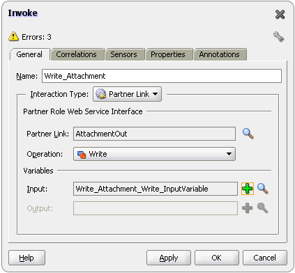

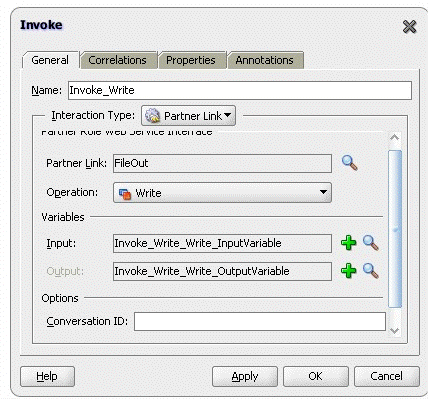

Double-click the invoke activity. The Invoke dialog is displayed.
Click the Properties tab.
Select the jca.file.Directory property from the Properties column and set the Value as MyDir (the directory that you created in Step 4.) Ensure that the Type column is set to input, as shown in Figure 4-29.
When using dynamic directories, ensure that parameters such asNumberMessages, ElapsedTime, and FileSize are not defined in the outbound adapter service WSDL file. These parameters are not supported with dynamic directories.Specify the naming convention to use for outgoing files. You cannot enter completely static names such as po.txt. This is to ensure the uniqueness in names of outgoing files, which prevents files from being inadvertently overwritten. Instead, outgoing file names must be a combination of static and dynamic portions.
Create a variable file of type xsd:string, as shown in Figure 4-27.
In the Create Copy Operation dialog, select Expression from Type and specify the file name, as shown in Figure 4-28. The file operation writes the output file to this file.
Click OK till you exit the assign activity dialog.
Select the jca.file.FileName property from the Properties column and set the Value as file (the file that you created in Step 4.) Ensure that the Type column is set to input, as shown in Figure 4-30.
When using dynamic files, ensure that parameters such asNumberMessages, ElapsedTime, and FileSize are not defined in the outbound adapter service WSDL file. These parameters are not supported with dynamic files.In the simplest scenario, you specify writing a single file to a single message. You can also specify the outbound method for batch file writing. This method enables you to specify the number of messages to publish in one batch file. The following batch file settings are provided in the File Configuration page shown in Figure 4-26:
Specify a value which, when equaled, causes a new outgoing file to be created.
Specify a time which, when exceeded, causes a new outgoing file to be created.
The Elapsed Time Exceeds batching criteria is evaluated and a new outgoing file is created, only when an invocation happens.For example, if you specify that elapsed time exceeds 15 seconds, then the first message that is received is not written out, even after 15 seconds, as batching conditions are not valid. If a second message is received, then batching conditions become valid for the first one, and an output file is created when the elapsed time exceeds 15 seconds.
File Size Exceeds
Specify a file size which, when equaled, causes an outgoing file to be created. For example, assume that you specify a value of 3 for the number of messages received and a value of 1 MB for the file size. When you receive two messages that when combined equal or exceed 1 MB, or three messages that are less than 1 MB, an output file is created.
You must not manually change the file configurations specified in the preceding list in theJCA files. You must use the Adapter Configuration Wizard to modify these configurations.If the Oracle File Adapter encounters some problem during batching, then it starts batching at the point at which it left off on recovery.

The outbound Oracle File Adapter uses the following configuration parameters:
PhysicalDirectory
LogicalDirectory
NumberMessages
ElapsedTime
FileSize
FileNamingConvention
Append

An additional Adapter Configuration Wizard page is also available for advanced users. This page is shown in Figure 4-39 and appears only after you make either or both of the following selections on the File Polling page shown in Figure 4-22:
Do not select the Delete Files After Successful Retrieval check box.
Set the value of the Minimum File Age field to a value greater than 0.

<property name=" FileModificationTime " value=" FileSystem "/> <property name=" ModificationTimeFormat" value=" 4,18,yyyyMMddHHmmss "/>
To handle the time zone issue, you must also be aware of the time stamp difference. The time zone of the FTP server is determined by using the Windows date/time properties (for example, by double-clicking the time being displayed in the Windows task bar). You must then convert the time difference between the FTP server and the system on which the Oracle FTP Adapter is running to milliseconds and add the value as a binding property in the composite.xml file:
<binding.jca config="FlatStructureIn_file.jca"> <property name="timestampOffset" source="" type="xs:string" many="false" override="may">238488888</property--> </binding.jca>

<property name=" FileModificationTime " value=" DirListing"/> <property name=" ModificationTimeFormat" value="0,17, MM-dd-yy hh:mma "/>

To access a remote FTP server, you must configure the following credentials:
User name: the user name to use on the remote FTP server.
Password: the password to use on the remote FTP server.
Port: 21
Host: the IP address of the remote FTP server.
You must configure these credentials by modifying the weblogic-ra.xml file using the Oracle WebLogic Server console.
To do so, in the Oracle WebLogic Server Admin Console:
Select Deployments from the Navigation pane on the left.
Select FtpAdapter from the table of Deployments shown on the right.
Select the Configuration subtab for the FtpAdapter and then Outbound Connection Pools.
Expand javax.resource.cci.ConnectionFactory and then select the instance that you are modifying. (For example, choose the eis/Ftp/FtpAdapter instance for the non-HA use case.)

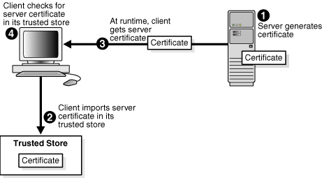

In environments in which sensitive data is transferred to remote servers (for example, sending credit card information to HTTP servers), the issue of security is very important. Security in these cases primarily refers to two requirements:
Trust in the remote server with which you are exchanging data
Protection from third parties trying to intercept the data
Secure socket layer (SSL) certificates and encryption focus on satisfying these two security requirements. When SSL is used for FTP, the resulting security mechanism is known as FTPS (or FTP over SSL).
To gain the trust of clients in SSL environments, servers obtain certificates (typically, X.509 certificates) from recognized certificate authorities. When you set up the FTP server, you use openSSL to create a certificate for the server. Every client trusts a few parties, to begin with. If the server is one of these trusted parties, or if the server's certificate was issued by one of these parties, then you have established trust, even indirectly. For example, if the server's certificate was issued by authority A, which has a certificate issued by authority B, and the client trusts B, that is good enough. For the setup shown in Figure 4-45, the server's certificate is directly imported into the client's certificate store as a trusted certificate.
You make the data being transferred immune to spying by encrypting it before sending it and decrypting it after receiving it. Symmetric encryption (using the same key to encrypt and decrypt data) is much faster for large amounts of data than the public key and private key approach. Symmetric encryption is the approach used by FTPS. However, before the client and server can use the same key to encrypt and decrypt data, they must agree on a common key. This client typically does this by performing the following tasks:
Generating a session key (to be used to encrypt and decrypt data)
Encrypting this session key using the server's public key that is part of the server's certificate
Sending the key to the server
The server decrypts this session key by using its private key and subsequently uses it to encrypt file data before sending it to the client.

To import the server key and certificate into FileZilla, you must perform the following steps:
Open a FileZilla Server interface from your Windows Start menu.
Click Edit, and then click Settings.
The FileZilla Server Options dialog is displayed.
Click SSL/TLS settings.
Enter the server key and certificate details as shown in Figure 4-46.
Figure 4-46 The FileZilla Server Options Dialog
In the Key password field, you must use the PEM pass phrase generated in Step 3 of Section 4.4.3.3.2, "Generating OpenSSL Server Key and Certificate."You must convert the server key and the server certificate from the PEM format to the PKCS#12 format as the Oracle FTP Adapter does not recognize the PEM format. To convert the server key and certificate to the PKCS#12 format, you must perform the following steps:

You must perform the following steps to configure the Oracle FTP Adapter deployment descriptor:
Navigate to http://servername:portnumber/console.
Use the required credentials to open the home page of the Oracle WebLogic Server Administration Console.
Select Deployments in the Domain Structure pane.
The Oracle WebLogic Server Administration Console - Summary of Deployments page is displayed.
Click FtpAdapter.
The Oracle WebLogic Server Administration Console - Settings for FtpAdapter page is displayed.
Click the Configuration tab, and then click the Outbound Connection Pools tab.
The Outbound Connection Pool Configuration table is displayed.
Select the JNDI name for the Ftp Adapter instance you configure. For example, "eis/Ftp/FtpAdapter".
Configure the deployment descriptors listed in Table 4-10:

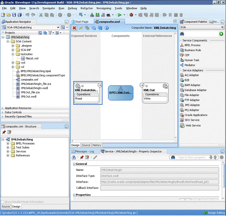

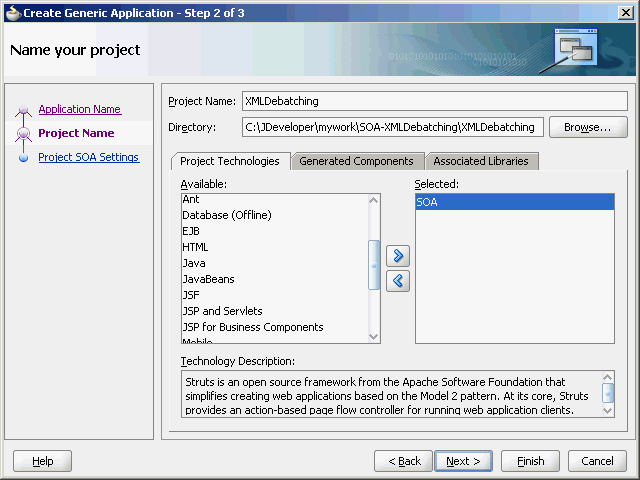

You must create a JDeveloper application to contain the SOA composite. To create an application and a project for the use case, perform the following:
In the Application Navigator of JDeveloper, click New Application. The Create Generic Application - Name your application page is displayed.
Enter SOA-XMLDebatching in the Application Name field, as shown in Figure 4-48, and click Next. The Create Generic Application - Name your project page is displayed.
Figure 4-48 The Generic Create Application - Name your application Page
Enter XMLDebatching in the Project Name field.
In the Available list under the Project Technologies tab, double-click SOA to move it to the Selected list, as shown in Figure 4-49.
Figure 4-49 The Create Generic Application - Name your project Page
Click Next. The Configure SOA settings dialog appears.
Select Composite With BPEL in the Composite Template box, as shown in Figure 4-50, and click Finish. The Create BPEL Process - BPEL Process page is displayed.
Figure 4-50 The Create Generic Application - Configure SOA settings Page
Enter BPELXMLDebatching in the Name field, select Define Service Later from the Template box, as shown in Figure 4-51.
Figure 4-51 The Create BPEL Process - BPEL Process Page
Click OK. The SOA-XMLDebatching application and the XMLDebatching project appear in the design area, as shown in Figure 4-52.

Select Write File, and click Next. The File Configuration page is displayed.
Enter the physical path for the output directory and enter emp_%SEQ%.xml in the File Naming Convention (po_%SEQ%.txt) field, as shown in Figure 4-60.
Select Number of Messages Equals option, if not selected. The default value is 1.
Figure 4-60 The Adapter Configuration Wizard - File Configuration Page

Figure 4-62 The JDeveloper - Composite.xml
You have to assemble or wire the three components that you have created: Inbound adapter service, BPEL process, Outbound adapter reference. Perform the following steps to wire the components:
Drag the small triangle in the XMLDebatchingIn in the Exposed Services area to the drop zone that appears as a green triangle in the BPEL process in the Components area.
Drag the small triangle in the BPEL process in the Components area to the drop zone that appears as a green triangle in the XMLOut in the External References area.
The JDeveloper Composite.xml appears, as shown in Figure 4-63.
Figure 4-63 The JDeveloper - Composite.xml

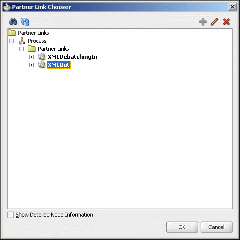

Click Browse Partner Links at the end of the Partner Link field. The Partner Link Chooser dialog is displayed.
Select XMLOut, as shown in Figure 4-69, and click OK.
Figure 4-69 The Partner Link Chooser Dialog
Drag the small triangle in the FlatStructureIn in the Exposed Services area to the drop zone that appears as a green triangle in the BPEL process in the Components area.
Drag the small triangle in the BPEL process in the Components area to the drop zone that appears as a green triangle in the FlatStructureOut in the External References area.
The JDeveloper Composite.xml appears, as shown in Figure 4-80.
Figure 4-80 The JDeveloper - Composite.xml

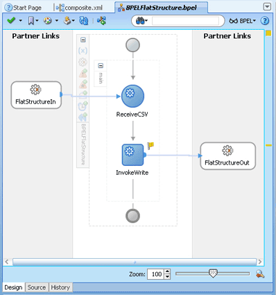

Double-click BPELFlatStructure. The BPELFlatStructure.bpel page is displayed.
Drag and drop a Receive activity from the Component Palette to the design area.
Double-click the Receive activity. The Receive dialog is displayed.
Enter ReceiveCSV in the Name field.
Select FlatStructureIn, and click OK.
Click the Auto-Create Variable icon to the right of the Variable field in the Receive dialog. The Create Variable dialog is displayed.
Select the default variable name and click OK. The Variable field is populated with the default variable name.
Check Create Instance, and click OK. The JDeveloper BPELFlatStructure.bpel page appears, as shown in Figure 4-81.
Figure 4-81 The JDeveloper - BPELFlatStructure.bpel
Drag and drop an Invoke activity from the Component Palette to the design area.
Double-click the Invoke activity. The Invoke dialog is displayed.
Enter InvokeWrite in the Name field.
Select FlatStructureOut, and click OK.
Click the Automatically Create Input Variable icon to the right of the Input variable field in the Invoke dialog. The Create Variable dialog is displayed.
Click OK. The JDeveloper BPELFlatStructure.bpel page appears, as shown in Figure 4-82.
Figure 4-82 The JDeveloper - BPELFlatStructure.bpel
Drag and drop a Transform activity from the Component Palette in between the Receive and Invoke activities in the design area.
Double-click the Transform activity. The Transform dialog is displayed.

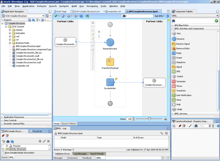

Enter TransformPayload in the Name field.
Click the Transformation tab. The Transform dialog is displayed.
Click the Create... icon. The Source Variable dialog is displayed.
Select ReceiveCSV_Read_InputVariable in the Source Variable box, and select body in the Source Part box, and then click OK. The Transform dialog is displayed with the Source and Part selected.
Select InvokeWrite_Write_InputVariable in the Target Variable list, select body in the Target Part.
Click the Browse button at the end of the Mapper File field and select addr1Toaddr2.xsl file from the xsl directory in your project.
Click OK.
Click File, Save All. The BPELFlatStructure.bpel page is displayed, as shown in Figure 4-83.
Figure 4-83 The JDeveloper - BPELFlatStructure.bpel

You have to assemble or wire the three components that you have created: Inbound Oracle File Adapter service, Mediator component, Outbound Oracle FTP Adapter reference. Perform the following steps to wire the components:
Drag the small triangle in the ReadFile in the Exposed Services area to the drop zone that appears as a green triangle in the Mediator component in the Components area.
Drag the small triangle in the Mediator component in the Components area to the drop zone that appears as a green triangle in the WriteFTP in the External References area. The JDeveloper composite.xml appears, as shown in Figure 4-84.
Figure 4-84 The JDeveloper - Composite.xml
Enter SOA-ScalableDOM in the Application Name field, and click Next. The Create Generic Application - Name your project page is displayed.
Enter ScalableDOM in the Project Name field.
In the Available list under the Project Technologies tab, double-click SOA to move it to the Selected list.
Select Composite With BPEL in the Composite Template box, and click Finish. The SOA-ScalableDOM application and ScalableDOM project appears in the Application Navigator and the Create BPEL Process - BPEL Process page is displayed.

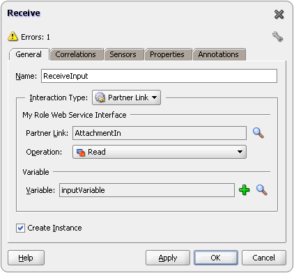

Enter ReceiveFile in the Name field.

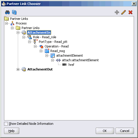

Select ScalableDOMIn, as shown in Figure 4-91, and click OK.
Figure 4-91 The Partner Link Chooser Dialog
Check Create Instance, and click OK. The JDeveloper composite.xml page appears, as shown in Figure 4-92.
Enter WriteFile in the Name field.
Select ScalableDOMOut, and click OK.
Select the default variable name and click OK. The Input variable field is populated with the default variable name. The Invoke dialog is displayed.
Click OK. The JDeveloper BPELScalableDOM.bpel page appears, as shown in Figure 4-93.
Enter SOA-ChunkedRead in the Application Name field, and click Next. The Create Generic Application - Name your project page is displayed.
Enter ChunkedRead in the Project Name field.
Select Composite With BPEL in the Composite Template box, and click Finish. The Create BPEL Process - BPEL Process page is displayed.
Enter BPELChunkedRead in the Name field, select Define Service Later from the Template box.
Click OK. The SOA-ChunkedRead application and the ChunkedRead project appears in the design area, as shown in Figure 4-98.

Click the Variables... icon represented by (x). The Variables dialog is displayed.
Click the Create... icon. The Create Variable dialog is displayed.
Create the following variables, as shown in Figure 4-103, for later use:
<variable name="dir" type="xsd:string"/>
<variable name="file" type="xsd:string"/>
<variable name="outIsEOF" type="xsd:string"/>
<variable name="outLineNumber" type="xsd:string"/>
<variable name="outColumnNumber" type="xsd:string"/>
<variable name="returnIsEOF" type="xsd:string"/>
<variable name="returnLineNumber" type="xsd:string"/>
<variable name="returnColumnNumber" type="xsd:string"/>
<variable name="returnIsMessageRejected" type="xsd:string"/>
<variable name="returnRejectionReason" type="xsd:string"/>
<variable name="returnNoDataFound" type="xsd:string"/>
All variables are Simple Types of type xsd:string.Drag and drop a Receive activity from the Component Palette to the design area.

Click the Source tab for the BPELChunkedRead.bpel page, and add the following properties for the invoke activity that you just created:
<bpelx:inputProperty name="jca.file.Directory" variable="dir"/> <bpelx:inputProperty name="jca.file.FileName" variable="file"/> <bpelx:inputProperty name="jca.file.LineNumber" ="outLineNumber"/> <bpelx:inputProperty name="jca.file.ColumnNumber" variable="outColumnNumber"/> <bpelx:inputProperty name="jca.file.IsEOF" variable="outIsEOF"/> <bpelx:outputProperty name="jca.file.LineNumber" variable="returnLineNumber"/> <bpelx:outputProperty name="jca.file.ColumnNumber" variable="returnColumnNumber"/> <bpelx:outputProperty name="jca.file.IsEOF" variable="returnIsEOF"/> <bpelx:outputProperty name="jca.file.IsMessageRejected" variable="returnIsMessageRejected"/> <bpelx:outputProperty name="jca.file.RejectionReason" variable="returnRejectionReason"/> <bpelx:outputProperty name="jca.file.NoDataFound" variable="returnNoDataFound"/>
The invoke activity appears as follows:
<invoke name="InvokeReadAddress" inputVariable="InvokeReadAddress_SynchRead_InputVariable" outputVariable="InvokeReadAddress_SynchRead_OutputVariable" partnerLink="ReadAddressChunk" portType="ns3:SynchRead_ptt" operation="SynchRead"> <bpelx:inputProperty name="jca.file.Directory" variable="dir"/> <bpelx:inputProperty name="jca.file.FileName" variable="file"/> <bpelx:inputProperty name="jca.file.LineNumber" variable="outLineNumber"/> <bpelx:inputProperty name="jca.file.ColumnNumber" variable="outColumnNumber"/> <bpelx:inputProperty name="jca.file.IsEOF" variable="outIsEOF"/> <bpelx:outputProperty name="jca.file.LineNumber" variable="returnLineNumber"/> <bpelx:outputProperty name="jca.file.ColumnNumber" variable="returnColumnNumber"/> <bpelx:outputProperty name="jca.file.IsEOF" variable="returnIsEOF"/> <bpelx:outputProperty name="jca.file.IsMessageRejected" variable="returnIsMessageRejected"/> <bpelx:outputProperty name="jca.file.RejectionReason" variable="returnRejectionReason"/> <bpelx:outputProperty name="jca.file.NoDataFound" variable="returnNoDataFound"/> </invoke>
Enter AttachmentApp in the Application Name field, and click Next. The Create Generic Application - Name your project page is displayed.
Enter Attachment in the Project Name field.
Enter BPELAttachment in the Name field, select Define Service Later from the Template list.
Click OK. The AttachmentApp application and the Attachment project appear in the design area, as shown in Figure 4-115.
Figure 4-115 The JDeveloper - Composite.xml
Enter ReceiveInput in the Name field.
Select AttachmentIn, as shown in Figure 4-121 and click OK.
Figure 4-121 The Partner Link Chooser Dialog
Click the Auto-Create Variable icon to the right of the Variable field in the Receive dialog, as shown in Figure 4-122. The Create Variable dialog is displayed.
Check Create Instance, and click OK. The JDeveloper BPELAttachment.bpel page appears, as shown in Figure 4-123.
Enter Write_Attachment in the Name field.
Select AttachmentOut, as shown in Figure 4-124, and click OK.
Figure 4-124 The Partner Link Chooser Dialog
Select the default variable name and click OK. The Variable field is populated with the default variable name. The Invoke dialog is displayed, as shown in Figure 4-125.
Click OK. The JDeveloper BPELAttachment.bpel page appears, as shown in Figure 4-126.

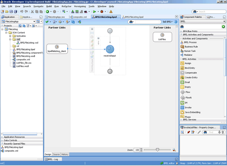

Double-click BPELFileListing. The BPELFileListing.bpel page is displayed.
Create a variable, MyDir of type xsd:string, as shown in Figure 4-134, for later use.
Click OK. The JDeveloper BPELFileListing.bpel page appears, as shown in Figure 4-135
Figure 4-135 The JDeveloper - BPELFileListing.bpel
Drag and drop an Invoke activity below the receive Activity from the Component Palette to the design area.
Enter InvokeListFiles in the Name field.
Select ListFiles, and click OK.
Select the default variable name and click OK. The Variable field is populated with the default variable name. The Invoke dialog is displayed with input variable populated.
Repeat the same to select the output variable. The Invoke dialog is displayed, as shown in Figure 4-136.
Click the Properties tab. The properties and the corresponding value column is displayed.
Select jca.file.Directory property. Double-click in the corresponding value column. The Adapter Property Value dialog is displayed.
Click the Browse Variables icon. The Variable XPath Builder dialog is displayed.
Expand Variables, select MyDir, and then click OK. The value of the jca.file.Directory is set to Mydir.
Click OK. The JDeveloper BPELFileListing.bpel page appears, as shown in Figure 4-137.
Figure 4-137 The JDeveloper - BPELFileListing.bpel
Drag and drop an Assign activity from the Component Palette in between the Receive activities and the Invoke activity in the design area.
Double-click the Assign activity. The Assign dialog is displayed.
Enter AssignDirName in the Name field.
Click the Copy Operation tab. The Assign dialog is displayed.
Select Copy Operation. The Create Copy Operation dialog is displayed.
Set the values for the headers, as shown in Figure 4-138.
Click OK, the JDeveloper BPELFileListing.bpel page is displayed, as shown in Figure 4-139.
Figure 4-139 The JDeveloper - BPELFileListing.bpel

Double-click BPELComplexStructure. The BPELComplexStructure.bpel page is displayed.
Enter ReceiveInvoice in the Name field.
Select ComplexStructureIn, and click OK.
Check Create Instance, and click OK. The JDeveloper BPELComplexStructure.bpel page appears.
Select ComplexStructureOut, and click OK.
Enter InvokeWrite_Write_OutputVariable in the variable name field and click OK. The Invoke dialog is displayed.
Click OK. The JDeveloper BPELComplexStructure.bpel page appears.
Select ReceiveInvoice_Read_InputVariable in the Source Variable box, and select body in the Source Part box, and then click OK. The Transform dialog is displayed with the Source and Part selected.
Select InvokeWrite_Write_OutputVariable in the Target Variable list, select body in the Target Part.
Click the Browse Mapping icon at the end of the Mapper File field and select InvToPo.xsl file from the xsl directory in your project.
Click OK.
Click File, Save All. The BPELComplexStructure.bpel page is displayed, as shown in Figure 4-144.
Enter SOA-FTPDebatching in the Application Name field, and click OK. The Create Generic Application - Name your project page is displayed.
Enter FTPDebatching in the Project Name.
Enter BPELFTPDebatching in the Name field, select Define Service Later from the Template box.
Click OK. The SOA-FTPDebatching application and the FTPDebatching project appears in the design area, as shown in Figure 4-145.

Select Put File, and click Next. The File Configuration page is displayed.
Enter the physical path for the output directory and enter po_%SEQ%.txt in the File Naming Convention(po_%SEQ%.txt) field.
Click Next. The Messages page is displayed.
Enter Write in the Name field.
Select PurchaseOrderOut, and click OK.
Click the Automatically Create Input Variable icon to the right of the Input variable field in the Receive dialog. The Create Variable dialog is displayed.
Enter Write_Put_OutputVariable in the Variable field and click OK. The Invoke dialog is displayed.
Enter SOA-FTPDynamicSynchronousRead in the Application Name field, and click OK. The Create Generic Application - Name your project page is displayed.
Enter FTPDynamicSynchronousRead in the Project Name.
Enter BPELDynamicSynchronousRead in the Name field, select Define Service Later from the Template box.
Click OK. The SOA-FTPDynamicSynchronousRead application and FTPDynamicSynchronousRead project appears in the design area, as shown in Figure 4-154.

Create a Variable and add an Invoke Activity
Create a variable called file of type xsd:string, as shown in Figure 4-159.
Click OK to return to BPELDynamicSynchronousRead.bpel page.
Select SyncRead, and click OK.
Select jca.ftp.FileName property. Double-click in the corresponding value column. The Adapter Property value dialog is displayed.
Click the Browse variables icon. The Variable XPath Builder dialog is displayed.
Expand Variables, select file, and then click OK. The value of the jca.ftp.FileName is set to file.
Click OK. The JDeveloper BPELDynamicSynchronousRead.bpel page appears.

Consider the following scenario, where you have a large CSV file of size 1 gigabyte coming on the source directory, and you must perform the following:
Translate the CSV into XML.
Transform the resulting XML using XSL.
Translate the result from the transform operation into a fixed length file.
This use case is similar to the FlatStructure sample in the BPEL samples directory. The difference is that the three steps occur in a single File I/O interaction.
All the three steps occur in a single File I/O interaction. This works only if all the records in the data file are of the same type.To use a large CSV file and perform the operations listed in the preceding scenario, you must perform the following steps:
Copy the address-csv.xsd and address-fixedLength.xsd files from the FlatStructure sample into the xsd directory of your project.
Copy addr1Toaddr2.xsl from the FlatStructure sample into the xsl directory of your project.
Configure the File I/O interaction, as shown in the following example. At a high level, you must specify the source schema, the target schema, and the XSL in the interaction specification along with the source and target directory or file details, as shown in the following example:
<adapter-config name="FileMove" adapter="File Adapter" xmlns="http://platform.integration.oracle/blocks/adapter/fw/metadata">
<endpoint-interaction portType="FileMove_ptt" operation="FileMove">
<interaction-spec
className="oracle.tip.adapter.file.outbound.FileIoInteractionSpec">
<property name="SourcePhysicalDirectory" value="foo1"/>
<property name="SourceFileName" value="bar1"/>
<property name="SourceSchema" value="xsd/address-csv.xsd"/>
<property name="SourceSchemaRoot value="Root-Element"/>
<property name="SourceType" value="native"/>
<property name="TargetPhysicalDirectory" value="foo2"/>
<property name="TargetFileName" value="bar2"/>
<property name="TargetSchema" value="xsd/address-fixedLength.xsd"/>
<property name="TargetSchemaRoot value="Root-Element"/>
<property name="TargetType" value="native"/>
<property name="Xsl value="xsl/addr1Toaddr2.xsl"/>
<property name="Type" value="MOVE"/>
</interaction-spec>
</adapter-config>

Create a SOA Application with either Composite with BPEL or an Empty Composite selected. If you choose Empty Composite, you must drop the BPEL Process from the Service Components pane onto the SOA Composite Editor.
You arrive at the screen below where you fill in the process details. You are required to choose Define Service Later as the template.
Next, you create the inbound service and outbound references and wire them with the BPEL component.

And, finally you create the BPEL process with the initiating <receive> activity to retrieve the payload and an <invoke> activity to write the payload
This is how most BPEL processes that use Adapters are modeled. The generated WSDL implies one-way directionally one way and that makes the BPEL process asynchronous:
In other words, the inbound File Adapter polls for files in the directory and for each file that it finds there, it translates the content into XML and publishes to BPEL.
However, because the BPEL process is asynchronous, the File Adapter returns immediately after the publish and performs the required post processing-for example. deletion/archival of data.
The disadvantage with such asynchronous BPEL processes is that it becomes difficult to throttle the inbound adapter. In otherwords, the inbound adapter would keep sending messages to BPEL without waiting for the downstream business processes to complete. This can lead to issues such as higher memory usage and CPU usage.
To mitigate the occurrence of these problems, you can manually change the WSDL and BPEL artifacts into synchronous processes. Once you have changed the synchronous to synchronous BPEL processes, the inbound File Adapter automatically throttles itself because the File Adapter is forced to wait for the downstream process to complete with a <reply> before processing the next file or message.
Refer to the altered WSDL below. Here, you convert the one-way WSDL to a two-way WSDL-- thereby making the WSDL synchronous.
Figure 4-168 Asynchronous WSDL Altered to be Two-Way WSDL
The next step is to add a <reply> activity to the inbound adapter partnerlink at the end of your BPEL process, for example:
Figure 4-169 Specifying a Reply to the Inbound Adapter
Finally, the process looks like this:
Figure 4-170 The Synchronous File Adapter Process with Receive and Reply BPEL Activities

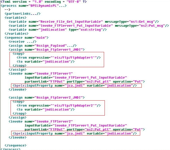

You can change this connection-factory location dynamically using JCA header properties in both BPEL and Mediator service engines. To do so, the business scenario involving BPEL or Mediator is required to use a reserved JCA header property jca.jndi as shown in the following.
Similarly, for the Mediator, the mplan is:
You must remember the following when using dynamic partner links:
You must preconfigure the connection factories on the SOA server. In the BPEL example above, both eis/Ftp/FtpAdater1 and eis/Ftp/FtpAdater2 must be configured in the WebLogic Server deployment descriptor for the FtpAdapter before your deployment of the scenario.

You can capture the details of the file that was written out as a part of a BPEL process that is invoking a File/FTP Adapter
For example, using FileNamingConvention as PurchaseOrder_%SEQ%.txt, you might be required to perform post processing based on the file that was written out (the name of the file is not known until the adapter invocation completes for example, PurchaseOrder_1.txt, PurchaseOrder_2.txt ...)
To provide for the capture of metadata, you must edit the WSDL so the File/Ftp Adapter can return the metadata of the file being written. In general, the File/Ftp Write/Put WSDL operations are one way as shown below.
Figure 4-171 Editing the WSDL File So the File/FTP Adapter Returns File Metadata
In general, the File/FTP Write/Put WSDL operations, as inserted in the .jca file, are one way of enabling the return of the metadata, as shown below.
The File/TP Adapters are designed to return the metadata back if the WSDL is tweaked into a two-way WSDL. In addition, the </wsdl.output> must import the fileread.xsd schema. You must copy the fileread.xsd schema from the following location:
http://blogs.oracle.com/adapters/resource/2010-04-12/fileread.xsd
The next step is to edit the WSDL to ensure it is changed into a two-way WSDL.
Figure 4-173 Editing the WSDL to Change It Into a Two-Way WSDL
Specify an Invoke WSDL statement through the BPEL Invoke statement panel.The file metadata would be returned as a part of the BPEL output variable:

The File/Ftp Adapter enables you to configure outbound writes to use a sequence number. For example, if you choose address-data_%SEQ%.txt as the FileNamingConvention, all files would be generated as address-data_1.txt, address-data_2.txt,..
The sequence number comes from the control directory for the particular adapter project(or scenario). For each project that use the File or Ftp Adapter, a unique directory is created for book-keeping purposes. Because this control directory must be unique, the adapter uses a digest to ensure that no two control directories are the same.
For example, for the FlatStructure sample in the example above, the control information for my project would go under FMW_HOME/user_projects/domains/soainfra/fileftp/controlFiles/[DIGEST]/outbound where the value of DIGEST would differ from one project to another.
Within this directory, there is a file control_ob.properties file where the sequence number is maintained. The sequence number is maintained in binary form and you might need a hexadecimal editor to view its content. There is another zero byte file, SEQ_nnn. This extra file is maintained as a backup.

Create a SOA Application with either Composite with BPEL or an Empty Composite. If you choose Empty Composite, you must drop the BPEL Process from the Service Components panel onto the SOA Composite Editor. Either way, you arrive at the process details screen You must choose Define Service Later as the template.
Next, you create the inbound service and outbound reference and wire them with the BPEL component:
Finally you create the BPEL process with the initiating <receive> activity to retrieve the payload and an <invoke> activity to write the payload.
This is how most BPEL processes that use Adapters are modeled. The generated WSDL is one-way, which makes the BPEL process asynchronous.
The inbound File Adapter polls for files in the directory and for each file it finds there, the Adapter translates the content into XML and publishes to BPEL. But, because the BPEL process is asynchronous, the Adapter returns immediately after the publish operation and performs the required post processing, for example, deletion/archival.
The disadvantage with such asynchronous BPEL processes is that it becomes difficult to throttle the inbound adapter. In other words, the inbound adapter keeps sending messages to BPEL without waiting for the downstream business processes to complete. This can lead to several issues including higher memory usage, and CPU usage.
To alleviate these problems, manually tweak the WSDL and BPEL artifacts into synchronous processes. Oncet here are synchronous BPEL processes, the inbound adapter automatically throttles itself as the adapter is forced to wait for the downstream process to complete with a <reply> before processing the next file or message.
In the following WSDL, the one-way WSDL has been converted to a two-way WSDL, thereby making the WSDL synchronous:
Figure 4-179 One-Way WSDL Converted Into a Two-Way WSDL
Add a <reply> activity to the inbound adapter partnerlink at the end of your BPEL process, for example:
Finally, the process resembles the following process, shown in the swim-lane format:
Figure 4-180 The Synchronous BPEL Process
The File/FTP Adapter enables you to control the order in which files get processed. For example, you might want the files to be processed in sequience of their modified times/ file sizes , or other determiners.
The File/FTP adapter enables you to achieve controlling the order in which files gets processed through a FileSorter attribute that you can define in the JCA file for your inbound File/Ftp Adapter service.
The File/FTP Adapter provides two predefined sorters that use the last modified times--or example:
However, there are times when you would like to define the order yourself. You can implement a Java Comparator and register that with the File Adapter as described below:
Write a comparator. For example, the FileSizeSorter comparator below sorts the files in descending order of their sizes:
To compile this class, you must place fileAdapter.jar in the classpath. From [FMW_HOME]/AS11gR1SOA/soa/connectors, expand FileAdapter.rar, for example, jar xvf FileAdapter.rar to extract fileAdapter.jar. You must place fileAdapter.jar in your classpath to compile the FileSizeSorter.java class, for example:
setenv CLASSPATH fileAdapter.jar jacac -d .FileSizeSorter.java
After compilation, bundle the class in its own jar file, for example,
jar cvf fileadapter-sorter.jar file
Bundle the fileadapter-sorter.jar in the FileAdapter.rar, for example,
jar uvf FileAdapter.rar fileadapter-sorter.jar
This step is required since the fileadapter-sorter.jar becomes visible to the ClassLoader that loads FileAdapter.rar. Though, there are other ways for example, copying the fileadapter-sorter.jar and fileadapter.jar under [DOMAIN_HOME]/lib, but the one above is the simplest and easiest to do.
Setting SingleThreadModel as true in the JCA file (see image at the beginning of this section.)
