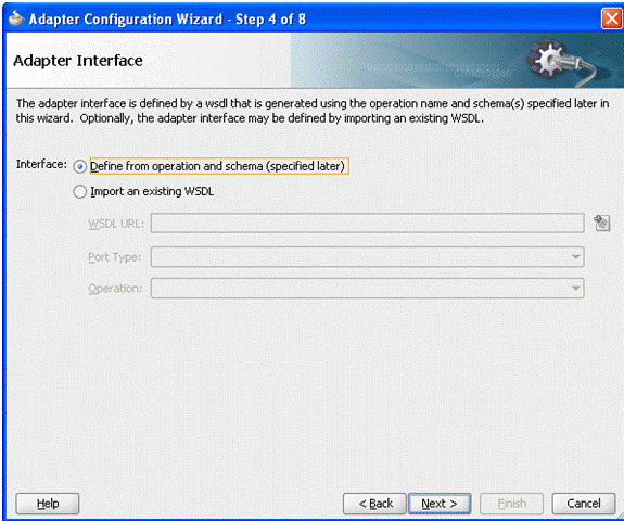

You can define an adapter interface in the Adapter Configuration Wizard Adapter Interface page, as shown in Figure 2-1, by using either of the following methods:
Using a WSDL that is generated using the operation name and schema that you specify in the Adapter Configuration Wizard in the pages that appear after the Adapter Configuration Wizard Adapter Interface page.
Importing an existing WSDL.
Figure 2-1 The Adapter Configuration Wizard Adapter Interface Page
This section describes how to define an adapter interface by importing an existing WSDL. You can use this feature to create an adapter service or reference by using existing WSDLs. The option to choose an existing WSDL is supported for the following adapters only:

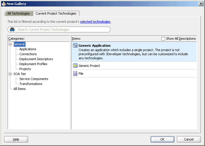

In the File menu, click New.
The New Gallery page is displayed, as shown in Figure 2-3.
In the All Technologies tab, under General categories, select Connections.
A list of the different connections that you can make is displayed in the Items pane on the right side of the New Gallery page.
Select Application Server Connection, and then click OK.

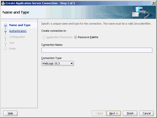

Figure 2-4 The Create Application Server Connection Name and Type Page
Enter a connection name in the Connection Name field. For example, AppsServerConnection1.
Select WebLogic 10.3. for Connection Type and click Next.

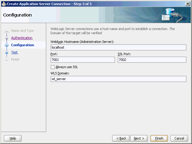

The Create Application Server Connection Configuration page is displayed, as shown in Figure 2-6.
Figure 2-6 The Create Application Server Connection Configuration Page
Enter the host name, the port details, and the domain server name in the Configuration page.

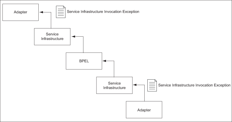

For an asynchronous service entry point, a transactional adapter initiates a global JTA transaction before sending an inbound message to the composite.
The example described below uses a test composite bound to the JMS adapter, which is bound to a composite bound in this example to BPEL which in turn is wired to a DB Adapter. BPEL dispatches messages to the DB adapter.
In this example, messages are read from JMS by the polling JMS Adapter and written to the BPEL process, where there the transaction commits. This is JTA1, the first XA transaction.
For any BPEL activity errors that, however, could not be retried or which exhausted their retry count, BPEL writes to its recovery table to store information. This information includes BPEL errors.
The second transaction, JTA2, begins with the DB Adapter reading from the BPEL dispatch table, obtaining the database insert argument. and writing an update message to the DB Adapter. This transaction, JTA 2, proceeds Outbound from the reference endpoint DB Adapter (that is, Outbound from SOA) to the Database itself. Retry situations from a duplicate data situation in the Database are retried either back from the DB Adapter to BPEL's table, or from the database back to the DB Adapter.
Global retries for any error handling are returned to the BPEL Receive activity instance, for example, or, more generally, to the point at which the transaction started. Such a retry could occur if there was an error such as a temporary database fault. The default retry count is by default indefinite, or specified in the jca.retry.count property.
If any errors are caught as part of the second XA transaction, JTA2, a rollback occurs.

The messages that error out before being posted to the service infrastructure are referred to as rejected messages. For example, the Oracle File Adapter selects a file having data in CSV format and tries to translate it to XML format (using NXSD). If there is any error in the translation, this message is rejected and are not be posted to the target composite.
Primarily, adapters and binding components are the generators of rejected messages.
Errors or faults that arise downstream in a synchronized flow are handled in the following manner by the inbound adapter:
Immediately rejected if the exception is non-retryable.
Retried indefinitely if the exception is retryable.
Retried several times equal to the value of jca.retry.count (if configured) and then rejected when the retries are exhausted.
Adapters reject messages that error out at the binding level; that is, they error out before entering the Service Infrastructure layer.

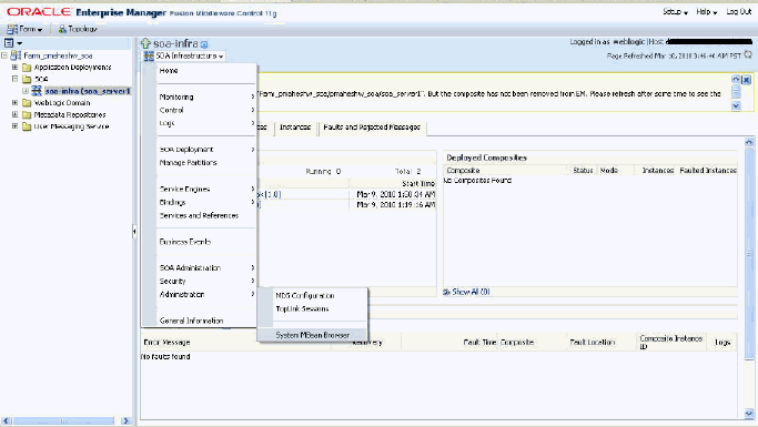

You can modify the global property using the MBeans browser (Adapter Mbean) of the Oracle Enterprise Manager. Any change you do through the MBeans browser takes immediate effect for all current and future endpoints.
To modify the global property using the MBeans browser (Adapter Mbean) of the Oracle Enterprise Manager, you must use the following procedure:
Navigate to http://servername:portnumber/em.
The Fusion Middleware Control Console displays its home page.
Right-click soa-infra from the SOA Folder in the navigator in the left pane.
The soa-infra page is displayed.
From the SOA Infrastructure menu, select Administration, and then System Mbean Browser, as shown in Figure 2-11.
The System Mbean Browser page is displayed.
Select oracle.as.soainfra.config, Server, AdapterConfig, and then adapter, as shown in Figure 2-12.
Figure 2-12 The soa-infra Page: System MBean Browser
Modify the GlobalInboundJcaRetryCount attribute (as an example of a Global Property)

After the configured number of retries is reached without a positive result, the Service Infrastructure Invocation exception is thrown.
The propagation of the type of the Service Infrastructure Invocation exception is important to allow inbound adapters to respond to errors reported by outbound adapters.
Figure 2-13, "Fault Propagation" shows the fault propagation when an adapter calls the service infrastructure synchronously, after which the Oracle BPEL Process Manager calls a down-stream adapter.
In this figure, a Service Infrastructure Invocation exception propagates from the down-stream adapter, through Oracle BPEL Process Manager, and to the caller adapter.

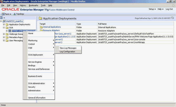

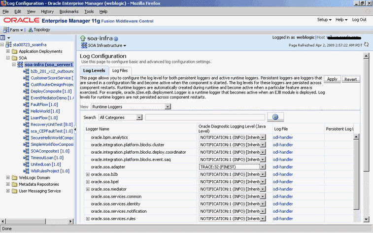

To set the trace level by using the Fusion Middleware Control Console:
The Fusion Middleware Control Console home page is displayed.
Right-click soa-infra from the SOA Folder in the Navigator in the left pane.
The console displays a menu.
Select Logs, and the Log Configuration, as shown in Figure 2-14.
Figure 2-14 Navigating to the Log Configuration Page
The Log Configuration page is displayed.
Locate oracle.soa.adapter in the Logger Name list, and change the log level in the Oracle Diagnostic Logging Level (Java Level) field. In this example, select Trace:32 (FINEST) from the list, as shown in Figure 2-15.
To ensure that log levels persist across component restarts, select Loggers With Persistent Log Level State from the View list. By default, the log level is set for run-time loggers. Run-time loggers do not persist across component restarts.For more information, see Section 2.24, "Viewing Adapter Logs".

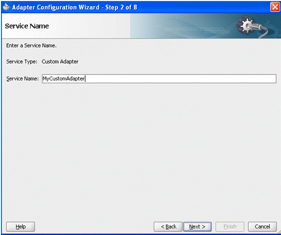

The next screen displays the service type and name, similar to the way it occurs with the Configuration Wizards of other adapters. This screen enables you to provide the name of a Service that makes sense in the Adapter you are configuring.
Figure 2-17 Adapter Configuration Wizard Service Name Screen

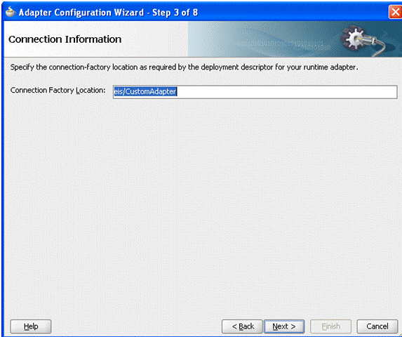

If the config.xml file contains a <connection-factory> entry (as required by the custom run-time adapter), the Wizard displays the Connection Information page displaying the default Connection Factory Location. If the config.xml does not contain a <connection-factory> entry (not required by the custom run-time adapter), the Wizard does not display this page.
Figure 2-18 Adapter Configuration Wizard Connection Information Screen
The next screen is the Adapter Interface Screen, which displays information in a similar manner to the configuration wizard for other Adapters. (Refer to the appropriate chapter on each Adapter for information on its configuration wizard.)This screen provides you a way to either define a new WSDL from an operation and schema you provide later, or import an existing WSDL, using the WSDL name, port type and operation.
Figure 2-19 Custom Adapter Wizard Adapter Interface Screen

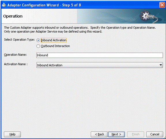

The next screen enables the user to choose the type of interaction: Inbound or Outbound. If Outbound Interaction is selected, the Wizard provides a list of Interaction Class names (or translated display names as seen in this example) from which to choose. You earlier provided these names in the customAdapter-config.xml file.
Figure 2-20 Custom Adapter Configuration Wizard Operation Screen (Inbound Choice)

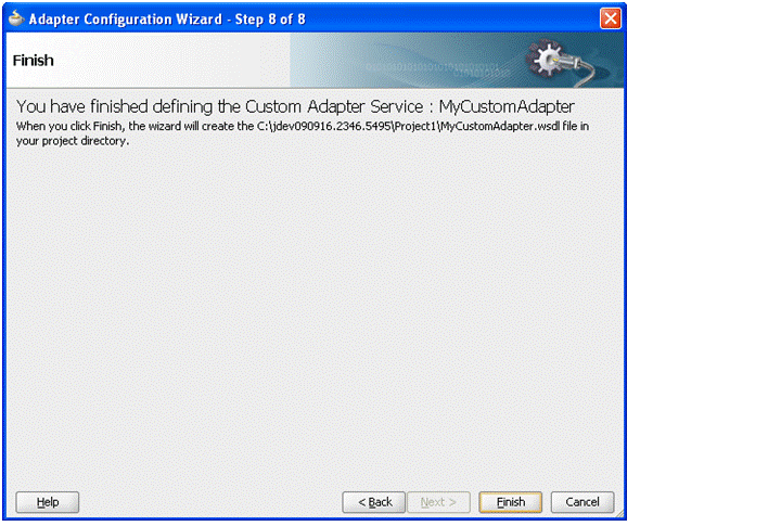

The next page is the Final screen for the Custom Adapter Configuration Wizard. The name of the WSDL files you created is displayed on the screen.
Figure 2-23 Custom Adapter Configuration Wizard Final Screen

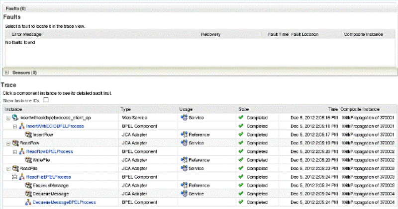

SOA Suite 11g deployments can include the use of the technology adapters for various activities including integration with FTP, database, and files, and other activities. Although the integrations with these adapters are easy and feature rich, there can be some challenges from the operations perspective.
One of these challenges is how to correlate a logical business transaction across SOA component instances. This correlation is typically accomplished via the execution context ID (ECID), but you can lose the ECID correlation when the business transaction spans technologies such as FTP, database, and files.

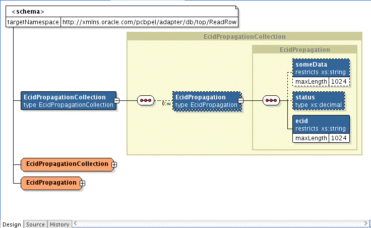

A new feature in the Oracle adapter JCA framework enables the propagation of the ECID. This feature is available in the SOA Suite 11.1.1.7 with back ports available for 11.1.1.4 and 11.1.1.5.
The basic concept of propagating the ECID is to identify a location in the payload of the message where the ECID can be stored.
Next, two Binding Properties, relating to the location of the ECID in the message, are added to either the Exposed Service (left-hand side of composite) or External Reference (right-hand side of composite).
This provides the JCA framework enough information to either extract the ECID from, or add the ECID to, the message.

To better understand this, first look at an example for the following database table:
When the Database Adapter Configuration Wizard creates an Exposed Service in the composite, the following schema is created:
Figure 2-25 Schema Created when Exposed Service is Created
For this example, the two Binding Properties added to the ReadRow service in the composite are:
<!-- Properties for the binding to propagate the ECID from the database table --> <property name="jca.ecid.nslist" type="xs:string" many="false"> xmlns:ns1="http://xmlns.oracle.com/pcbpel/adapter/db/top/ReadRow" </property> <property name="jca.ecid.xpath" type="xs:string" many="false"> /ns1:EcidPropagationCollection/ns1:EcidPropagation/ns1:ecid </property>
The property called jca.ecid.nslist contains the targetNamespace defined in the schema.
The property called jca.ecid.xpath contains the XPath statement to the element.
The XPath statement also contains the appropriate namespace prefix (ns1) which is defined in the jca.ecid.nslist property.
When the Database Adapter service reads a row from the database, it will retrieve the ECID value from the payload and remove the ECID element from the payload. When the component instance is created, it will be associated with the retrieved ECID and the payload contains everything except the ECID element/value. The only time the ECID is visible is when it is stored safely in the resource technology such as the database, a file, or a queue.

When viewing the Flow Trace in the Enterprise Manger, you will now see all the instances correlated by the ECID:
Figure 2-27 All Instances Correlated by the ECid, as Seen in the Flow Trace
