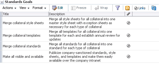

Figure 49-1 shows the Lists task flow.
Figure 49-1 A List Rendered in the Lists Task Flow
For information about the Lists task flow, see Section 49.1.2, "What Happens to Lists at Runtime."
