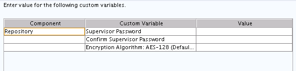

3.3.6 Specifying Custom Variables
Use the Custom Variables screen to specify a password for the supervisor user and to select the encryption algorithm for the Oracle GoldenGate Studio Repository schema.
The custom variables for Oracle GoldenGate Studio are described in the following table:
Variable Description
Supervisor Password
Password of the supervisor user. You must confirm this password on the following line.
You must enter a password for the Supervisor Password and Confirm Supervisor Password fields. These fields are required before you can continue. The password should be between 6 and 12 characters.
Make a note of the password you set on this screen; you will need it later on when providing your Oracle GoldenGate Studio connection information to connect to the repository after you start Oracle GoldenGate Studio.
Encryption Algorithm
Select the encryption algorithm, AES-128.
This field is optional. If this field is left blank, the default value is AES-128.
