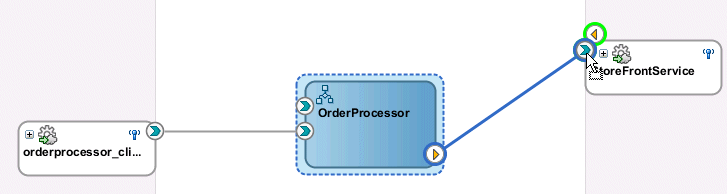

2.2 Adding Service Components
Once you create your application, the next step is typically to add service components that implement the business logic or processing rules of your application. You can use the Components window in the SOA Composite Editor to drag and drop service components into the composite.
2.2.1 How to Add a Service Component
To add a service component:
  1. At the top of the Components window, click Components.
  2. From the SOA section, drag a component into the designer.
    Figure 2-2 shows a BPEL process being added to the designer.
    Figure 2-2 Adding a BPEL Process to the SOA Composite Application
    Description of Figure 2-2 follows
    Description of "Figure 2-2 Adding a BPEL Process to the SOA Composite Application"
    A specific dialog for the selected service component is displayed. Table 2-5 describes the available editors.
    Table 2-5 Starting Service Component Editors
    Dragging This Service Component... Invokes The...
    BPEL Process
    Create BPEL Process dialog to create a BPEL process that integrates a series of business activities and services into an end-to-end process flow.
    Business Rule
    Create Business Rules dialog to create a business decision based on rules.
    Human Task
    Create Human Task dialog to create a workflow that describes the tasks for users or groups to perform as part of an end-to-end business process flow.
    Mediator
    Create Mediator dialog to define services that perform message and event routing, filtering, and transformations.
    Spring Component
    Create Spring dialog to create a spring context file for integrating Java interfaces into SOA composite applications.
  3. Configure the settings for the service component, and click OK. For help with a service component dialog, click Help or press F1.
    Figure 2-3 shows the BPEL Process dialog with data entered to create the OrderProcessor BPEL process. The process is selected to be asynchronous. The Expose as a SOAP Service check box directs Oracle JDeveloper to automatically create this service component connected to an inbound SOAP web service.
    Figure 2-3 Create BPEL Process Dialog
    Description of Figure 2-3 follows
    Description of "Figure 2-3 Create BPEL Process Dialog"
  4. Click OK.
    Figure 2-4 shows the OrderProcessor BPEL process service component in the designer. A SOAP service binding component called orderprocessor_client_ep in the left swimlane provides the outside world with an entry point into the SOA composite application. If the Expose as a SOAP Service option was not selected in the Create BPEL Process dialog, the orderprocessor_client_ep service does not appear. You can add a service later by following the steps in How to Add a Service Binding Component.
    Figure 2-4 BPEL Process in Composite
    Description of Figure 2-4 follows
    Description of "Figure 2-4 BPEL Process in Composite"
    You can more fully define the content of the service component now or at a later time. For this top-down example, the content is defined now.
  5. From the File main menu, select Save All.

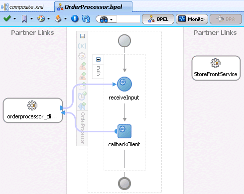

2.2.3 How to Edit a Service Component
You edit a service component to define specific details about the service component.
To edit a service component:
  1. Double-click the service component in the designer to display the appropriate editor or designer, as described in Table 2-6.
    Table 2-6 Starting SOA Service Component Wizards and Dialogs
    Double-Clicking This Service Component... Displays The...
    BPEL Process
    Oracle BPEL Designer for further designing.
    Business Rule
    Business Rules Designer for further designing.
    Human Task
    Human Task Editor for further designing.
    Mediator
    Oracle Mediator Editor for further designing.
    Spring Component
    Spring Editor for further designing.
  2. Modify the settings for the selected service component. For help with a service component editor or designer, click Help or press F1. These editors are described in later chapters.

2.5 Adding Wires
You wire (connect) services, service components, and references. For this example, you wire the web service and service component. Note the following:
  • Since a web service is an inbound service, a reference handle displays on the right side. Web services that are outbound references do not have a reference handle on the right side.
  • You can drag a defined interface to an undefined interface in either direction (reference to service or service to reference). The undefined interface then inherits the defined interface. There are several exceptions to this rule:
    • A component has the right to reject a new interface. For example, an Oracle Mediator can only have one inbound service. Therefore, it rejects attempts to create a second service.
    • You cannot drag an outbound service (external reference) to a business rule, because business rules do not support references. When dragging a wire, the user interface highlights the interfaces that are valid targets.
  • The port type and the namespace are used to uniquely identify an interface.
  • You cannot wire services and composites that have different interfaces. For example, you cannot connect a web service configured with a synchronous WSDL file to an asynchronous BPEL process. Figure 2-17 provides details.
    Figure 2-17 Limitations on Wiring Services and Composites with Different Interfaces
    Description of Figure 2-17 follows
    Description of "Figure 2-17 Limitations on Wiring Services and Composites with Different Interfaces"
    The service and reference must match, meaning the interface and the callback must be the same. If you have two services that have different interfaces, you can place an Oracle Mediator between the two services and perform a transformation between the interfaces.

  1. From a service reference handle, drag a wire to the service component interface, as shown in Figure 2-18.
  2. If the service component is a BPEL process, double-click the BPEL process to open Oracle BPEL Designer. Note that the service displays as a partner link in the left swimlane, as shown in Figure 2-19.
    Figure 2-19 Display of the Service as a Partner Link in the BPEL Process
    Description of Figure 2-19 follows
    Description of "Figure 2-19 Display of the Service as a Partner Link in the BPEL Process"
  3. Select Save All from the File main menu.
2.5.2 How to Wire a Service Component and a Reference
You can wire a service component to a reference binding component from the SOA Composite Editor.
To wire a service component and a reference:
  1. In the Applications window, double-click composite_name or single-click composite_name above the designer.
  2. From the service component, drag a wire to the reference, as shown in Figure 2-20.
    Figure 2-20 Wiring of a Service Component and Reference
    Description of Figure 2-20 follows
    Description of "Figure 2-20 Wiring of a Service Component and Reference"
  3. If the service component is a BPEL process, double-click the BPEL process to open Oracle BPEL Designer. Note that the reference displays as a partner link in the right swimlane, as shown in Figure 2-21.
    Figure 2-21 Display of the Reference as a Partner Link in the BPEL Process
    Description of Figure 2-21 follows
    Description of "Figure 2-21 Display of the Reference as a Partner Link in the BPEL Process"
  4. Select Save All from the File main menu.
  5. In the Applications window, select the composite_name file.
  6. Click the Source tab to review what you have created.

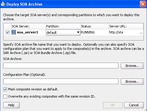

2.10 Deploying a SOA Composite Application
Deploying a SOA composite application involves creating a connection to an Oracle WebLogic Server and deploying an archive of the SOA composite application to an Oracle WebLogic Server managed server. For more information about deploying SOA composite applications, see Deploying SOA Composite Applications .

  7. If you want to deploy a prebuilt SOA composite application archive that includes a deployment profile, right-click the SOA folder and select Deploy SOA Archive. The archive consists of a JAR file of a single application or a SOA bundle ZIP file containing multiple applications.
    You are prompted to select the following:
    • The target SOA servers to which you want to deploy the SOA composite application archive.
    • The archive to deploy.
    • The configuration plan to attach to the application. As you move projects from one environment to another (for example, from testing to production), you typically must modify several environment-specific values, such as JDBC connection strings, hostnames of various servers, and so on. Configuration plans enable you to modify these values using a single text (XML) file called a configuration plan. The configuration plan is created in either Oracle JDeveloper or from the command line. During process deployment, the configuration plan is used to search the SOA project for values that must be replaced to adapt the project to the next target environment. This is an optional selection.
    • Whether you want to overwrite an existing composite of the same revision ID. This action enables you to redeploy an application revision.
    Figure 2-28 provides details.
    Figure 2-28 Deploy SOA Archive Dialog
    Description of Figure 2-28 follows
    Description of "Figure 2-28 Deploy SOA Archive Dialog"
