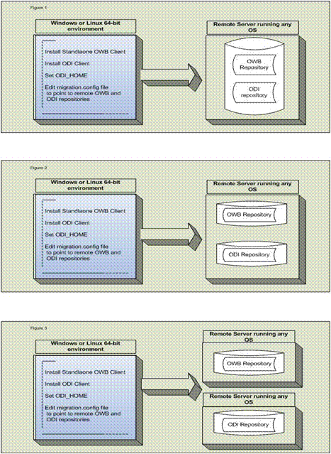

Migration Utility Run for Remote Repositories
You can have three different scenarios when the repositories are remote as shown in the figures below:
In the 1st case the repositories can reside on the same server and the same database.
In the 2nd case the repositories can reside on same server but different databases.
In the 3rd case the repositories can reside on different servers.
