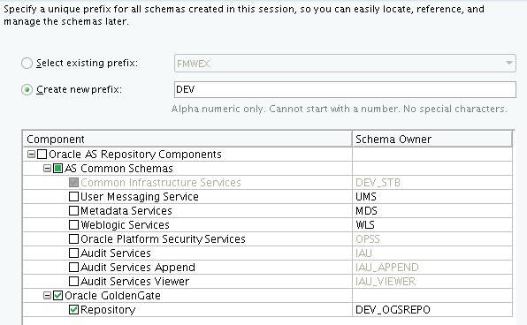

3.3.4 Specifying a Custom Prefix and Selecting the Oracle GoldenGate Repository Schema
On the Select Components screen, select Create new prefix, specify a custom prefix, then select the Oracle GoldenGate - Repository schema.
The schema Common Infrastructure Services is also automatically created. This schema is dimmed; you cannot select or deselect it. For more information, see About the Service Table Schema in Oracle Fusion Middleware Creating Schemas with the Repository Creation Utility.
The custom prefix is used to logically group schemas together. Note that a prefix is required.
Tip:
For more information about custom prefixes, see About Custom Prefixes in Oracle Fusion Middleware Creating Schemas with the Repository Creation Utility.
For more information about how schemas can be organized, see Planning Your Schema Creation in Oracle Fusion Middleware Creating Schemas with the Repository Creation Utility.
Tip:
You must make a note of the custom prefix you choose to enter here; you will need this later on.
Click Next to proceed, then click OK on the dialog window confirming that prerequisite checking for schema creation was successful.

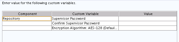

3.3.6 Specifying Custom Variables
Use the Custom Variables screen to specify a password for the supervisor user and to select the encryption algorithm for the Oracle GoldenGate Studio Repository schema.
The custom variables for Oracle GoldenGate Studio are described in the following table:
Variable Description
Supervisor Password
Password of the supervisor user. You must confirm this password on the following line.
You must enter a password for the Supervisor Password and Confirm Supervisor Password fields. These fields are required before you can continue. The password should be between 6 and 12 characters.
Make a note of the password you set on this screen; you will need it later on when providing your Oracle GoldenGate Studio connection information to connect to the repository after you start Oracle GoldenGate Studio.
Encryption Algorithm
Select the encryption algorithm, AES-128.
This field is optional. If this field is left blank, the default value is AES-128.
