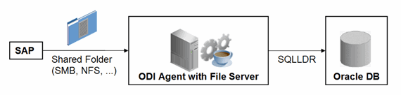

Data integration from SAP is handled by the LKM SAP ERP to Oracle (SQLLDR) and the LKM SAP ERP to SQL.
The LKM SAP ERP to Oracle (SQLLDR) is used for mappings sourcing from SAP via ABAP and having a Staging Area located in an Oracle Database and the LKM SAP ERP to SQL is used for non-Oracle staging areas.
The KM first generates optimized ABAP code corresponding to the extraction process required for a given mapping. This code includes filters and joins that can be processed directly in the source SAP server. This ABAP program is automatically uploaded and is executed using the OdiSAPAbapExecute tool to generate an extraction file in SAP.
The KM then transfers this extraction file either to a pre-configured FTP server or to a shared directory. This file is then either downloaded from this server using FTP, SFTP, SCP or copied to the machine where the ODI Agent is located, and is finally loaded either using SQL*Loader or using a JDBC connection into the staging area. The agent can also directly read the extraction file on the FTP server's disk. See File Transfer Configurations for more information.
The rest of the integration process (data integrity check and integration) is managed with other Oracle Data Integration KMs.

  • The adapter supports two transfer modes for transferring data from SAP system to the ODI agent: data transfer using a Shared Directory and data transfer through FTP. For details and restrictions, see File Transfer Configurations.
    Depending on the chosen file transfer mode the following requirements must be met:
    • Data transfer through a Shared Directory (recommended transfer method)
      The LKM SAP ERP to Oracle (SQLLDR) requires a folder that is shared between the SAP system and the ODI agent. The SAP application server transfers the data by writing it out into a folder that is accessible from the SAP system and the ODI agent machine. This is typically done by sharing a folder of the ODI agent machine with the SAP system. Note that the shared folder does not necessarily have to be located on the ODI agent machine. A shared folder on a third machine is also possible, as long as the shared folder is accessible to both the ODI agent machine and the SAP system.
      For security reasons, folders located on the SAP server should not be shared. You should instead share a folder located of the ODI agent machine with the SAP system, or use a third machine as the shared file server.
      The shared folder must be accessible to SAP system and not just to the underlying operating system. This means that the folder needs to be declared in SAP transaction AL11 and the folder opens successfully in AL11.

8.7.1.1 Transfer using a Shared Directory (recommended)
During the extraction process the ABAP programs write chunks of data into the data file in the shared folder. For better performances this shared folder should be located on the ODI agent machine. In this setup, SQL*Loader directly reads the data from this folder and loads it into database.
If the folder is not located on the ODI agent machine, then the ODI agent first needs to copy the file from the shared folder to the agent for loading the data using SQL*Loader/ JDBC-Connection in the next step.
Configuration 1: Shared Folder is physically located on the ODI Agent machine (recommended)
This configuration is used, when FTP_TRANSFER_METHOD = FSMOUNT_DIRECT. In this configuration the following data movements are performed:
  1. The ABAP program extracts chunks of FETCH_ BATCH SIZE records and writes them into a file in the shared folder.
  2. for LKM SAP ERP to Oracle (SQLLDR): SQL*Loader reads locally the data file and loads the data into the Oracle staging area.
    For LKM SAP ERP to SQL: The ODI File Driver reads locally the data file and inserts the data using JDBC into a non-Oracle staging area.
This configuration requires the following Topology settings:
  1. Create a File data server pointing to the File server/ODI Agent machine:
    • Host (Data Server): n/a
    • User: n/a
    • Password: n/a
  2. Under this File data server create a physical schema representing the shared folder in the File host server. Specify the Data and Work Schemas as follows:
    • Data Schema: Path (UNC) of the shared folder used by the ABAP program to write extraction files.
    • Directory (Work Schema): Local path on the server's machine hosting the shared folder. This path is used by an agent and SQL*Loader installed on this machine to access the extraction files without passing via the shared folder.
    Temporary files such as ctl, bad, dsc will be created in a local temporary folder on the run-time agent. The default temporary directory is the system's temporary directory. On UNIX this is typically /tmp and on Windows c:\Documents and Settings\<user>\Local Settings\Temp. This directory can be changed using the KM option TEMP_DIR.
