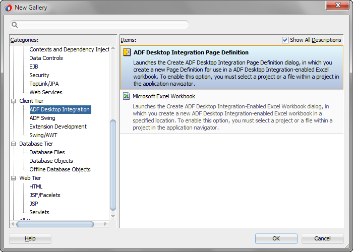

You create and configure a page definition file that determines the Oracle ADF bindings to expose in the JDeveloper project.
Before you begin:
It may be helpful to have an understanding of page definition files. See Working with Page Definition Files for an Integrated Excel Workbook.
To create an ADF Desktop Integration page definition file:
JDeveloper adds the page definition into the Fusion web application and opens the new page definition's editor. Figure 4-2 shows the ViewController project with the new page definition in the Applications window.

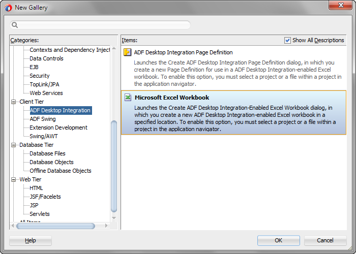

To add an integrated Excel workbook, open the Fusion web application in JDeveloper and add an Excel workbook to the project from New Gallery.
Before you begin:
It may be helpful to have an understanding of adding ADF Desktop Integration to a Fusion web application. See Adding an Integrated Excel Workbook to a Fusion Web Application.

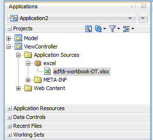

To add an integrated Excel workbook in JDeveloper:
JDeveloper adds the integrated Excel workbook into the Fusion web application, and automatically enables the project with ADF Desktop Integration. Figure 4-5 shows the ViewController project.
Figure 4-5 adfdi-workbook-DT.xlsx in Applications window
After adding the integrated Excel workbook, you must configure it.

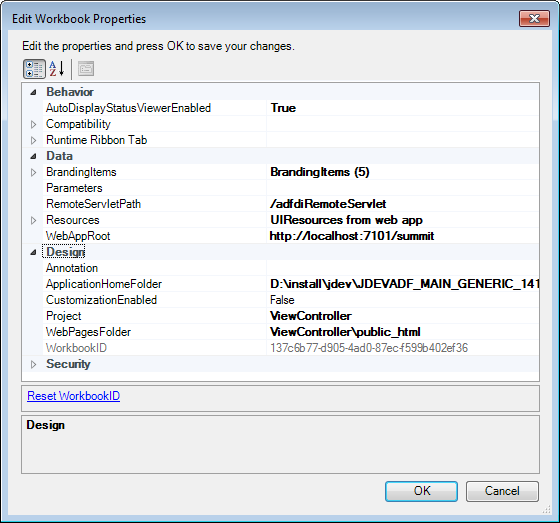

To configure a new integrated Excel workbook:

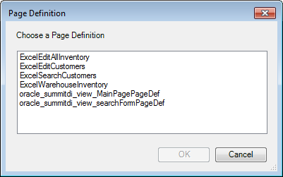

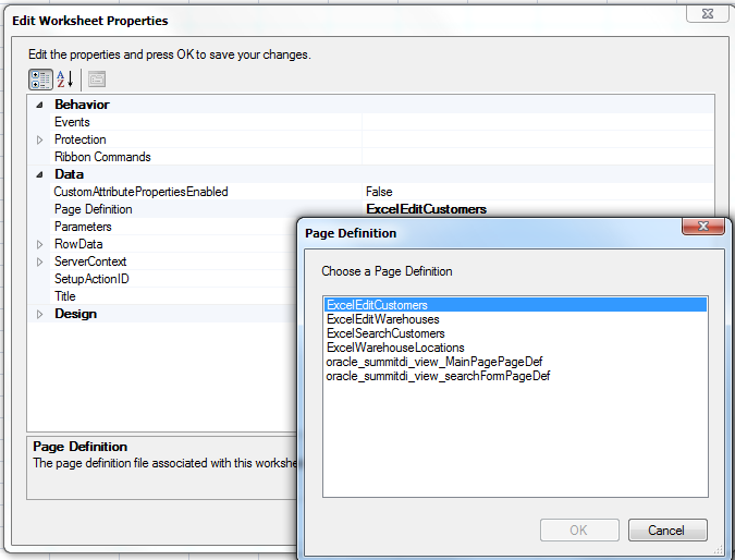

To use Oracle ADF functionality, associate each worksheet with a page definition file. You associate a page definition file with a worksheet when you add a worksheet to the integrated Excel workbook. You can integrate multiple worksheets in an integrated Excel workbook with a Fusion web application. Use a different page definition file for each worksheet in the integrated Excel workbook.
Before you begin:
It may be helpful to have an understanding of adding an integrated Excel workbook to a Fusion web application. See Adding an Integrated Excel Workbook to a Fusion Web Application.
To associate a page definition file with an Excel worksheet:

Although you can store the Excel workbooks that you integrate with Fusion web applications anywhere you choose, there are several advantages to storing them with the other files of the Fusion web application. Some of these advantages are:
Source control of the workbooks
Facilitating the download of workbooks from web pages

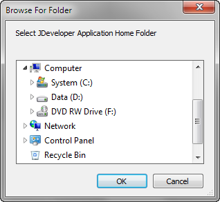

The file system folder picker that appears the first time a workbook is opened defaults to the location where you store the workbook
For example, the Summit sample application for ADF Desktop Integration stores the Excel workbooks it integrates in the following subdirectory:
Summit_HOME
\ViewController\src\oracle\summitdi\excel
where Summit_HOME
is the root directory that stores the source files for the Summit sample application for ADF Desktop Integration.
After enabling ADF Desktop Integration manually in a workbook, you would need to configure it.

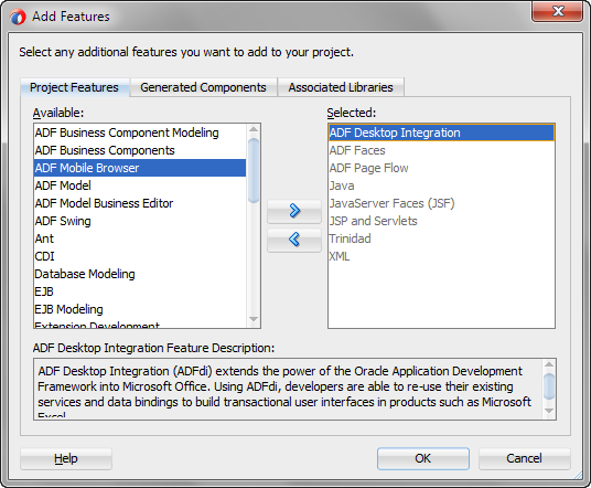

To enable ADF Desktop Integration in the Fusion web application without adding the integrated Excel workbook, you must add ADF Desktop Integration manually.
Use the Project Properties dialog in JDeveloper to add ADF Desktop Integration to the feature list of your project.
Before you begin:
It may be helpful to have an understanding of adding ADF Desktop Integration to a Fusion web application. See Enabling ADF Desktop Integration Manually.
To manually add ADF Desktop Integration to your project:
For information about what happens when you add ADF Desktop Integration, see What Happens When You Add ADF Desktop Integration to Your JDeveloper Project.
If you plan to distribute integrated Excel workbooks by adding them to ADF library files through EAR and JAR files, add ADF Library Web Application Support to your project. See Adding ADF Library Web Application Support.

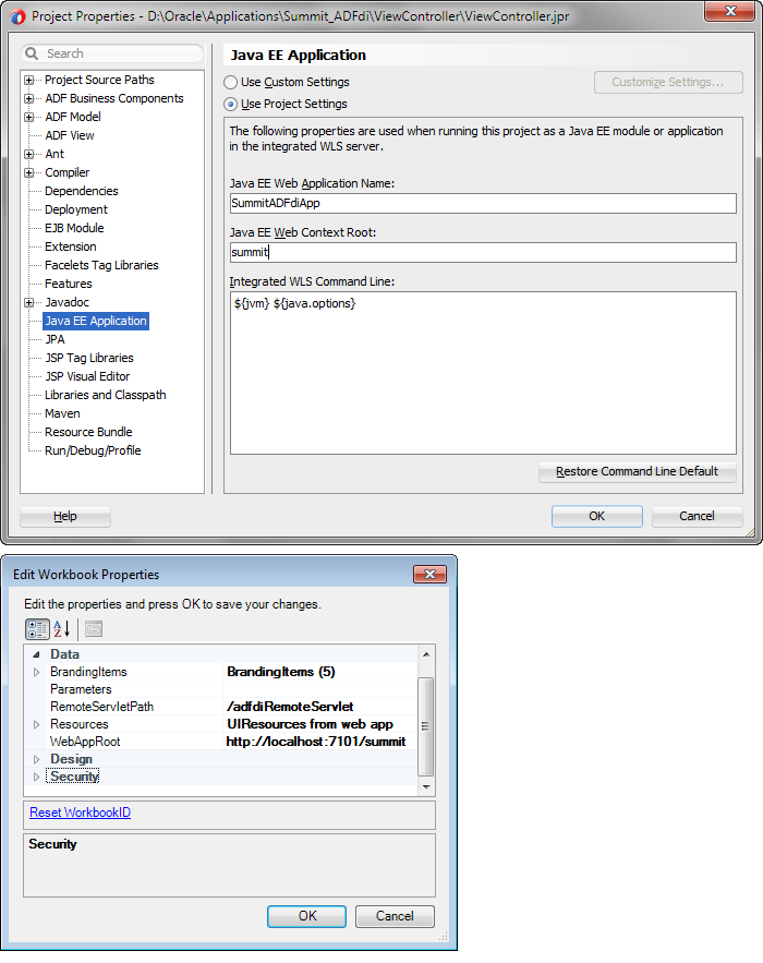

must match the value of the RemoteServletPath
workbook property described in Table A-19.

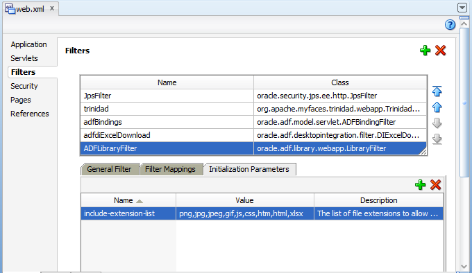

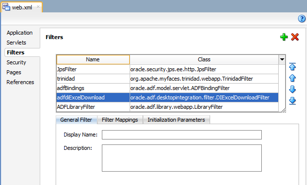

If you want to distribute integrated workbooks by adding them to ADF library files, add ADF Library web application support to the Fusion web application. See Packaging a Reusable ADF Component into an ADF Library in Developing Fusion Web Applications with Oracle Application Development Framework.
When updating filter and filter mapping information in the web.xml
file, ensure that the filter for ADF Library Web Application Support (<filter-name>ADFLibraryFilter</filter-name>
) appears below the adfdiExcelDownload
filter entries, so that integrated Excel workbooks can be downloaded from the Fusion web application.
Figure 4-13 shows the Filters tab of the overview editor of the web.xml
in JDeveloper.
You should also update the include-extension-list
initialization parameter to add the Excel file extensions (such as .xlsx
and .xlsm
), as shown in Figure 4-14.
Figure 4-14 ADFLibraryFilter Using include-extension-list
Parameter
For information about web.xml
, see ADF Desktop Integration Settings in the Web Application Deployment Descriptor.
