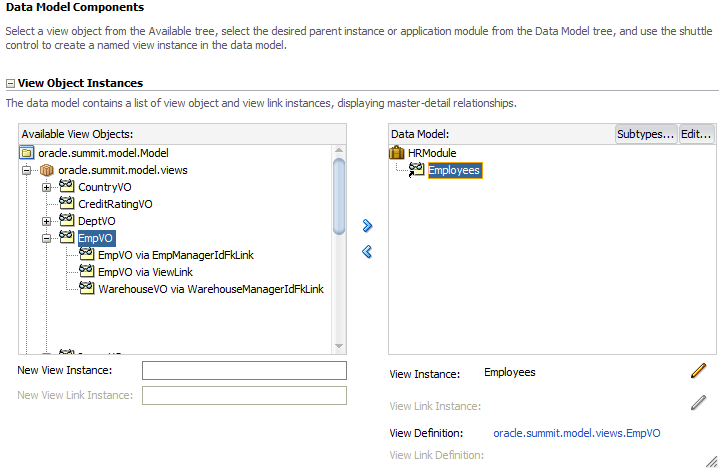

To enable active master-detail coordination, open the application module in the overview editor and select the Data Model page.
Before you begin:
It may be helpful to have an understanding of the ways to create a master-detail hierarchy. For more information, see Working with Multiple Tables in a Master-Detail Hierarchy.
You may also find it helpful to understand the role of the application module. For more information, see About Application Modules.
You may also find it helpful to understand functionality that can be added using other Oracle ADF features. For more information, see Additional Functionality for View Objects.
You will need to complete these tasks:
Create the desired view objects, as described in How to Create an Entity-Based View Object and How to Create a Custom SQL Mode View Object.
Create an application module, as described in How to Create an Application Module.
To add a detail instance of a view object:
Figure 6-8 Data Model with View Linked View Object
To test active master-detail coordination, launch the Oracle ADF Model Tester on the application module by choosing Run from its context menu in the Applications window. The Oracle ADF Model Tester data model tree shows the view link instance that is actively coordinating the detail view object instance with the master view object instance. You can double-click the view link instance node in the tree to open a master-detail data view page in the Oracle ADF Model Tester. Then, when you use the toolbar buttons to navigate in the master view object — changing the view object's current row as a result — the coordinated set of details is automatically refreshed and the user interface stays in sync.
If you double-click another view object that is not defined as a master and detail, a second tab will open to show its data; in that case, since it is not actively coordinated by a view link, its query is not constrained by the current row in the master view object.
For information about editing the data model and running the Oracle ADF Model Tester, see Testing View Object Instances Using the Oracle ADF Model Tester.

For example, assume the recursive master-detail hierarchy displays a list of employees based on their management hierarchy. In this scenario, you would create the association based on the Employees
entity object. On the Entity Objects page of the Create Association wizard, you would select Employees.EmployeeId
as the source attribute and Employee.ManagerId
as the destination attribute. The entity object Employees
supplies both attributes to ensure the association is self-referential.
To create an association-based, self-referential view link:
When you are ready to expose the view object in your project's data model, you will configure the view instance in the data model to use a view criteria to filter the initial value in the root of the tree. For example, assume the recursive master-detail hierarchy displays a list of employees based on their management hierarchy. In this scenario, you'll configure the view criteria's bind variable to specify the employee ID of the employee that you want to be the root value of the entire hierarchy. In this case, the root value of the recursive hierarchy of managers and employees would be the employee ID of the highest level manager in the organization.
Before you begin:
It may be helpful to have an understanding of the recursive data model. For more information, see Working with a Single Table in a Recursive Master-Detail Hierarchy.
You will need to complete this task:
Create the entity-based view object and create a view criteria that will filter the view instance's results to include only those rows you want to see at the "root" of the hierarchy. To create a view criteria that uses a bind variable to filter the view object, see Working with Named View Criteria.
For example, in a recursive hierarchy of managers and employees, you would create the entity-based view object EmployeesView
. After you create the view object in the Create View Object wizard, you can use the Query page of the overview editor to create a bind variable and view criteria which allow you to identify the employee or employees that will be seen at the top of the hierarchy. If only a single employee should appear at the root of the hierarchy, then the view criteria in this scenario will filter the employees using a bind variable for the employee ID (corresponding to the source attribute) and the WHERE
clause shown in the Create View Criteria dialog would look like ((Employees.EMPLOYEE_ID = :TheEmployeeId ))
, where TheEmployeeId
is the bind variable name. For more information on creating a view criteria that uses a bind variable to filter the view object, see Creating a Data Source View Object to Control the Cascading List.
To define the view object instance in an existing application module:
When you create an self-referential view link, JDeveloper creates the XML document file that represents its declarative settings and saves it in the directory that corresponds to the name of its package. This XML file contains the declarative information about the source and target attribute pairs that the association you selected specifies and contains the declarative information about the association that relates the source and target view object you selected.
