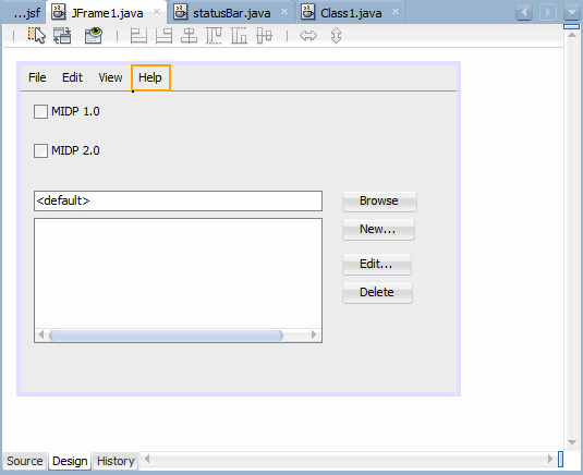

The Java Visual Editor displays the visual components of a user interface in Design so that you can view and edit source code as you design the UI. Use Source in Source Editor to access the source code.
The Java Visual Editor displays the visual components of a user interface in the Design tab, as shown in Figure 8-3.
Figure 8-3 Java Visual Editor Design View

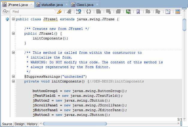

You see the Java source view of the visual classes by clicking the Source tab as shown in Figure 8-4.
Figure 8-4 Java Visual Editor Source View

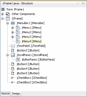

When the Java Visual Editor is open, its corresponding elements are displayed hierarchically in the Structure window, as shown in Figure 8-5.
Figure 8-5 Structure Window for Java File
If the Properties window is open, selecting elements in either the Structure window or the Java Visual Editor changes the selection in the Properties window as well.

To open the Java Visual Editor:
Double-click the Java file in the Applications window and click the Design tab in the editor window.
The source code is accessible in the Source Editor (click the Source tab to view the source code), enabling you to view and edit your source code in parallel with designing your UI. Any changes made in the Java Visual Editor or Properties window are immediately reflected in the source code.
The Java Visual Editor toolbar lets you easily work with components and duplicates commands that you can choose from the context sensitive menu displayed on a selected component.
