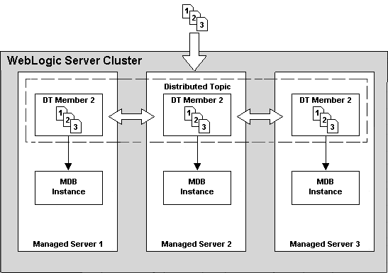

Figure A-1 shows the following configuration:
Replicated distributed topic
topicMessagesDistributionMode = One-Copy-Per-Server.
The MDB and the topic are deployed in the same (local) cluster.
distributedDestinationConnection = LocalOnly.
Figure A-1 Scenario 1: Replicated DT, One Copy Per Server, Local Deployment, Local Only Consumption
In this scenario:
Copies of messages are forwarded to other servers in the cluster by the RDT.
One MDB pool is created on each server in the local cluster.
Each MDB pool listens to one of the distributed topic member on the same server.
This approach can yield higher performance than "RDT, One Copy Per Server, Local Deployment, EveryMember," because all messaging is local (it avoids transferring messages over network calls) and still ensures that all distributed topic members are serviced by MDB consumers. However for some use cases, the EveryMember alternative may work better, based on the trade-offs discussed in Handling Uneven Message Loads and/or Message Processing Delays.
This scenario does not work correctly for durable subscriptions when there are multiple members on the same server, when there are no members on any of the local servers that host the MDB application, or when JMS service migration (auto or manual) is involved.

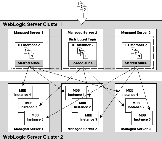

Figure A-6 shows the following configuration:
topicMessagesDistributionMode = One-Copy-Per-Application.
The MDB and the topic are deployed in different (remote) clusters.
distributedDestinationConnection ignored for remote deployments.
Figure A-6 Scenario 6: Replicated DT, One Copy Per Application, Remote Deployment
In this scenario:
Copies of messages are forwarded to other servers in the cluster by the RDT, but these copies are filtered out (ignored) by the MDB subscriptions.
One MDB pool is created on each server in the local cluster for each member in the remote cluster.
A message is given to only one MDB pool.
All subscribers on the same member share the same subscription.

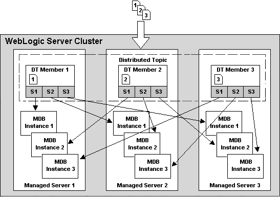

Figure A-7 shows the following configuration:
Partitioned distributed topic
distributedDestinationConnection = EveryMember.
Figure A-7 Scenario 8: Partitioned DT, One Copy Per Server, Local Deployment, Every Member Consumption
In this scenario:
Messages are distributed individually to the distributed topic members. Messages are not duplicated or copied to other members in the cluster.
An MDB pool is created for each distributed topic member on each server in the local cluster.
Each server's subscribers on the same member of the DT have their own independent subscription. In other words, subscribers from a particular server to the same member do not share any subscriptions with subscribers from another server.
The details of this scenario are the same as the previous one except that the MDB deployment and the PDT are in different clusters.

This scenario is the recommended configuration for One-Copy-Per-Application and Local PT for high performance. However for some use cases, the EveryMember alternative may work better, based on the trade-offs discussed in Handling Uneven Message Loads and/or Message Processing Delays.
Figure A-10 shows the following configuration:
Figure A-9 Scenario 11: Partitioned DT, One Copy Per Application, Local Deployment, Every Member Consumption
For a partitioned distributed topic, one copy per application, local deployment, it is better to use LocalOnly consumption for most use cases, as shown in Scenario 9: Partitioned DT, One Copy Per Application, Local Deployment, Local Only Consumption. However the trade-offs discussed in Handling Uneven Message Loads and/or Message Processing Delays, apply here.
The MDB and the topic are deployed in different (remote) cluster.
Figure A-10 Scenario 12: Partitioned DT, One Copy Per Application, Remote Deployment
In this scenario:
Subscriptions are created on all the distributed topic members automatically and dynamically.
All subscribers from the same MDB application on the same member share the same subscription.
