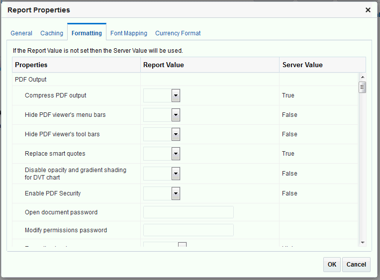

The Formatting tab of the Report Properties dialog enables you to set runtime formatting properties at the report level.
These properties are also set at the system level. If conflicting values are set for a property at each level, the report level takes precedence.
To set a property at the report level:
For each property, Report Value is updatable and the Server Value is shown for reference.
The Formatting tab of the Report Properties dialog is shown in the following illustration.
