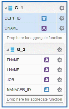

The data model provides a feature to group breaks and sort data.
Sorting is supported for parent group break columns only. For example, if a data set of employees is grouped by department and manager, you can sort the XML data by department. If you know how the data should be sorted in the final report or template, you specify sorting at data generation time to optimize document generation. The column order specified in the SELECT clause must exactly match the element orders in the data structure. Otherwise group break and sort may not work. Due to complexity, multiple grouping with multiple sorts at different group levels is not allowed.
Example: In the example shown below, sort and group break are applied to the parent group only, that is, G_1. Notice the column order in the query, data set dialog, and data structure. The SQL column order must exactly match the data structure element field order; otherwise, it may result in data corruption.
Example:
SELECT d.DEPARTMENT_ID DEPT_ID, d.DEPARTMENT_NAME DNAME,
E.FIRST_NAME FNAME,E.LAST_NAME LNAME,E.JOB_ID JOB,E.MANAGER_ID
FROM EMPLOYEES E,DEPARTMENTS D
WHERE D.DEPARTMENT_ID = E.DEPARTMENT_ID
ORDER BY d.DEPARTMENT_ID, d.DEPARTMENT_NAME
Once you define the query, you can use the data model designer to select data elements and create group breaks as shown below.
The Data Structure with breaks is:
<output rootName="DATA_DS" uniqueRowName="false"> <nodeList name="data-structure"> <dataStructure tagName="DATA_DS"> <group name="G_1" label="G_1" source="q1"> <element name="DEPT_ID" value="DEPT_ID" label="DEPT_ID" fieldOrder="1"/> <element name="DNAME" value="DNAME" label="DNAME" fieldOrder="2"/> <group name="G_2" label="G_2" source="q1"> <element name="FNAME" value="FNAME" label="FNAME" fieldOrder="3"/> <element name="LNAME" value="LNAME" label="LNAME" fieldOrder="4"/> <element name="JOB" value="JOB" label="JOB" fieldOrder="5"/> <element name="MANAGER_ID" value="MANAGER_ID" label="MANAGER_ID" fieldOrder="6"/> </group> </group> </dataStructure> </nodeList> </output>

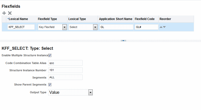

Oracle BI Publisher supports lexical parameters for Oracle Fusion Applications and Oracle E-Business Suite. Lexical parameters enable you to create dynamic queries.
In BI Publisher, lexical parameters are defined as:
Lexical – PL/SQL packaged variable defined as a data model parameter.
Key Flexfield (KFF) – Lexical token in a data set query. KFF creates a "code" made up of meaningful segment values and stores a single value as a code combination id. Key Flexfields always return as a single column when used in SELECT / SEGMENT METADATA type or condition when used in WHERE clause. Key Flexfields execute at run time to extract the lexical definition and then are substituted in the SQL query.
Descriptive Flexfields (DFF) – Customizable expansion space to track additional information that is important and unique to the business. DFFs can be context sensitive, where the information stored in the application depends on the other values of the user input. Unlike Key Flexfields, Descriptive Flexfields can have multiple context-sensitive segments.
When you define any lexical, name the lexical to match the usage so that when the editor dialog pops up it will be easier to enter the default values for the SQL query. For example, if you are using a lexical in a SELECT clause, use "_select" as a suffix. The default values must be valid to get metadata.
The following example demonstrates the usage of a lexical:
When you create the data set query for the select columns, specify column alias,
SELECT gcc.CODE_COMBINATION_ID, GCC.ATTRIBUTE_CATEGORY, gcc.segment1 seg1, gcc.segment2 seg2, gcc.segment3 seg3, gcc.segment4 seg4, gcc.segment5 seg5, &KFF_SELECT account FROM GL_CODE_COMBINATIONS GCC WHERE gcc.CHART_OF_ACCOUNTS_ID = 101 AND &KFF_WHERE
When you save the query, a pop-up dialog prompts you for the default values. To get SQL metadata at design time you must specify the default values that can form a valid SQL query. For example,
if the lexical usage is a SELECT clause then you could enter null
if the lexical usage is a WHERE clause then you could enter 1 = 1 or 1 =2
if the lexical usage is ORDER BY clause then you could enter 1

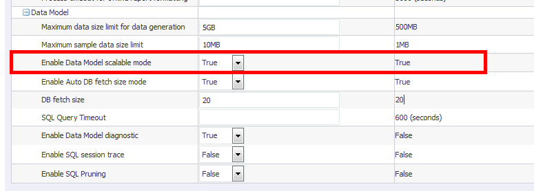

When the Scalable mode property is on, BI Publisher uses the temp file system to generate data. The data processor uses the least amount of memory.
This scalable mode property can be set at the data model level and the instance level. The data model setting overrides the instance value.
You can set the instance value by expanding the nodes for Administrator, Runtime Properties , and then Data Model:
The instance value can be overridden by Data model setting shown here:
The following table details the expected results for the possible on/off settings at each level:

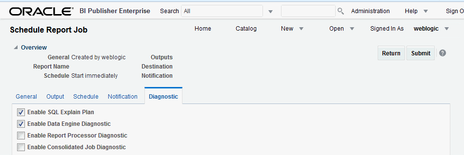

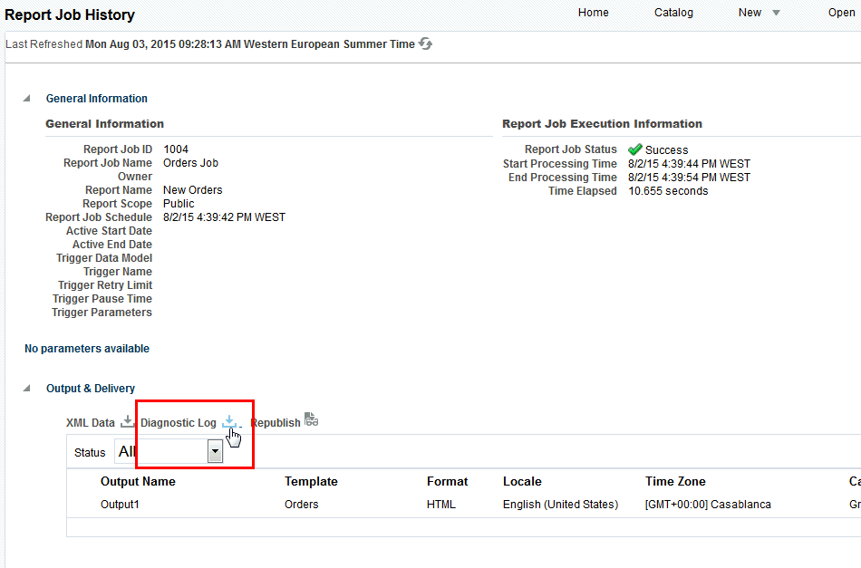

Oracle BI Publisher provides a mechanism to generate the explain plan and SQL monitoring reports and to enable SQL session trace. This functionality is applicable to SQL statements executing against Oracle Database only. Logical queries against BI Server or any other type of database are not supported.
You can generate an Explain plan at the data set level for a single query or at the report level for all queries in a report.

From the SQL data set Edit dialog you can generate an explain plan before actually executing the query. This provides a best guess estimation of a plan. The query will be executed binding with null values.
Click Generate Explain Plan on the Edit SQL Query dialog. Open the generated document in a text editor like Notepad or WordPad.
To generate an explain plan for a report, run the report through the Scheduler.
