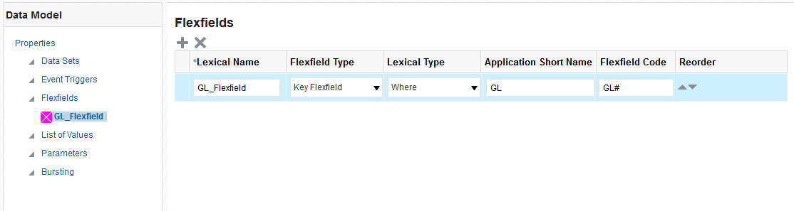

After you set up the flexfield components of your data model, create a flexfield lexical reference in the SQL query using the following syntax:
&LEXICAL_TAG ALIAS_NAME
for example:
&FLEX_GL_BALANCING alias_gl_balancing
After entering the SQL query, when you click OK
The Details region displays appropriate fields depending on the Lexical Type you chose.

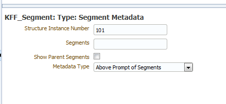

Fields for Key Flexfield Type: Segment Metadata
The table describes the detail fields for segmented metadata.
| Field | Description |
| Structure Instance Number | Enter the name of the source column or parameter that contains the flexfield structure information. For example: 101. To use a parameter, prefix the parameter name with a colon, for example, :PARAM_STRUCT_NUM. |
| Segments | (Optional) Identifies for which segments this data is requested. Default value is "ALL". See Oracle E-Business Suite Developer's Guide for syntax. |
| Show Parent Segments | Select this box to automatically display the parent segments of dependent segments even if it is specified as not displayed in the segments attribute. |
| Metadata Type | Select the type of metadata to return: Above Prompt of Segments — Above prompt of segment(s). Left Prompt of Segments — Left prompt of segment(s) |

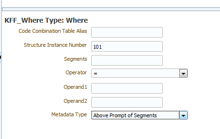

Fields for Key Flexfield Type: Where
The table below shows the detail fields for the Where key flexfield type.
| Code Combination Table Alias | Specify the table alias to prefix to the column names. You use TABLEALIAS if your SELECT joins to other flexfield tables or uses a self-join. |
| Operator | Select the appropriate operator. |
| Operand1 | Enter the value to use on the right side of the conditional operator. |
| Operand2 | (Optional) High value for the BETWEEN operator. |

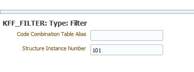

Fields for Key Flexfield Type: Filter
The table below shows the detail fields for the Filter flexfield type.

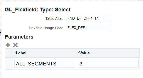

Reporting on descriptive flexfields is supported only for Oracle Fusion Applications.
When you create the SQL data set, you can include the descriptive flexfield using the ampersand symbol.
For example, the figure below shows &DFF_SELECT referencing of the descriptive flexfield.

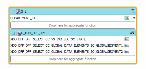

When you click OK, the diagram of your data set shows the columns that are returned from your descriptive flexfield as shown below.
