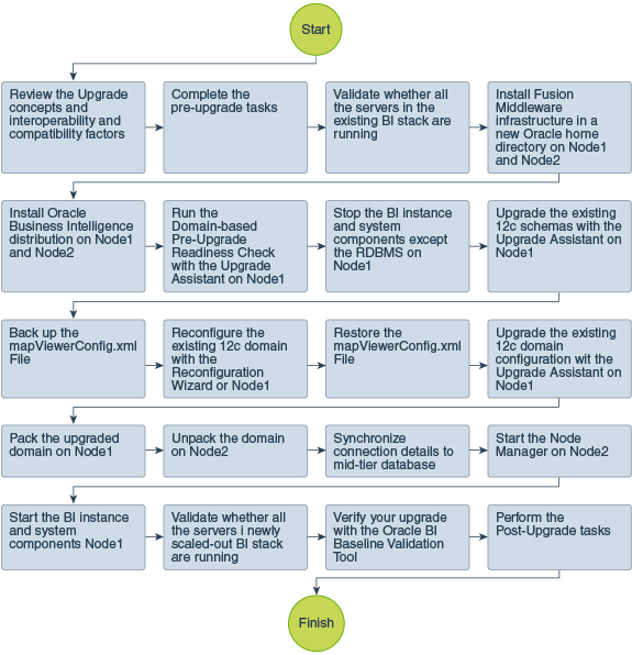

Figure 7-1 Upgrade Process Flowchart for a Multi-Node Oracle Business Intelligence Deployment from a Previous 12c Release
Table 7-1 lists the high-level steps that you need to perform to upgrade a multi-node Oracle BI deployment to Release 12.2.1.4.0.
Table 7-1 Tasks for Upgrading Multi-Node Oracle Business Intelligence Deployment from a Pervious 12c Release

Stop the Oracle BI instance and the system components on Node1.
The procedure in this section describe how to stop servers and processes using the WLST command-line utility or a script. You can also use the Fusion Middleware Control and the Oracle WebLogic Server Administration Console. See Starting and Stopping Administration and Managed Servers and Node ManagerParent topic: Upgrading Scaled-Out Systems from a Previous 12c Release
After stopping servers and processes, use the Upgrade Assistant to upgrade supported product schemas to the current release of Oracle Fusion Middleware.
The Upgrade Assistant allows you to upgrade individually selected schemas or all schemas associated with a domain. The option you select determines which Upgrade Assistant screens you will use.
schema_version_registry has been properly updated.Parent topic: Upgrading Scaled-Out Systems from a Previous 12c Release
Run the Upgrade Assistant to upgrade product schemas, domain component configurations, or standalone system components to 12c (12.2.1.4.0). Oracle recommends that you run the Upgrade Assistant as a non-SYSDBA user, completing the upgrade for one domain at a time.
Before you start the Upgrade Assistant, make sure that the JVM character encoding is set to UTF-8 for the platform on which the Upgrade Assistant is running. If the character encoding is not set to UTF-8, then you will not be able to download files containing Unicode characters in their names. This can cause the upgrade to fail.

The mapViewerConfig.xml file is overwritten by the reconfiguration templates when you run the Reconfiguration Wizard. Therefore, you must back up the mapViewerConfig.xml file before reconfiguring your existing domain.
Run the Reconfiguration Wizard to reconfigure your domain component configurations to 12c (12.2.1.4.0).

Before running the Reconfiguration Wizard, create a backup copy of the domain directory.

Shut down the administration server and all collocated managed servers before starting the reconfiguration process. See Stopping Servers and Processes.To start the Reconfiguration Wizard in graphical mode:

Navigate through the screens in the Reconfiguration Wizard to reconfigure your existing domain.
Parent topic: About Reconfiguring the Domain
The mapViewerConfig.xml file is overwritten when you run the Reconfiguration Wizard on your domain. You can know that the mapViewerConfig.xml file is overwritten by checking its file size. You must restore the original file that you backed up before upgrading your domain with the Upgrade Assistant.
After reconfiguring the domain, use the Upgrade Assistant to upgrade the domain component configurations inside the domain to match the updated domain configuration.

Navigate through the screens in the Upgrade Assistant to upgrade component configurations in the WebLogic domain.
After running the Reconfiguration Wizard to reconfigure the WebLogic domain to 12c (12.2.1.4.0), you must run the Upgrade Assistant to upgrade the domain component configurations to match the updated domain configuration.

After upgrading the existing domain to 12c (12.2.1.4.0), pack the upgraded domain on Node1.
You must unpack the domain that you packed on Node1 to Node2, which is the remote node.
Synchronizing connection details to the mid-tier database ensures that the Oracle BI components can access the mid-tier database when connection details, including credentials, are changed.
Supported mid-tier database types are DB2, SQLServer, MSSQL, and Oracle.
On UNIX, perform this task on the primary host. On Windows, perform this task on every host.
After you have upgraded the Oracle BI domain on Node1, start the Node Manager on Node2.
Start the Oracle BI instance and the system components on Node1.
The procedure in this section describe how to start servers and processes using the WLST command-line utility or a script. You can also use the Oracle Fusion Middleware Control and the Oracle WebLogic Server Administration Console. See Starting and Stopping Administration and Managed Servers and Node ManagerParent topic: Upgrading Scaled-Out Systems from a Previous 12c Release
The following servers must be in the running state on both the nodes: Servers hosting Oracle BI instance (bi_server), OBIPS, OBIJH, OBICCS, OBICH, and OBIS.
