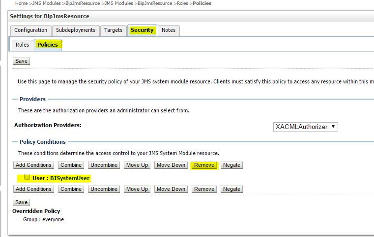

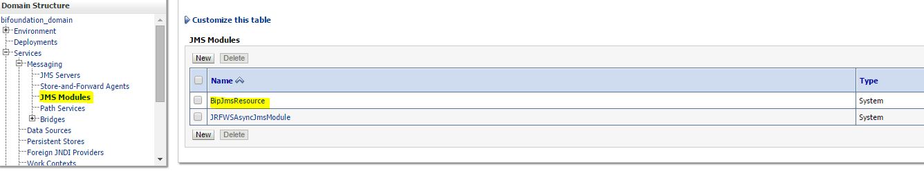

- Sign in to the WebLogic Console.
- Under Services, click Messaging and then JMSModules, and select BipJmsResource.
- Under the Security tab, click Policies.
- Under Policy Conditions, select the User: BISystemUser checkbox and click Remove.
- Restart the BI Publisher and check the scheduled jobs.
