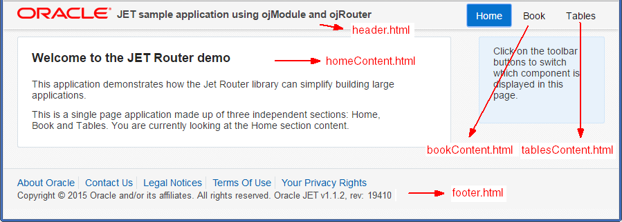

For example, the SPA-ojModule-ojRouter sample single-page application uses five templates to define the HTML markup for the application. The image below shows the main page for the Oracle JET Sample Single Page application as it runs on the desktop, with arrows pointing to the names of the templates defining view content for the application.
The image is described in the surrounding text.
