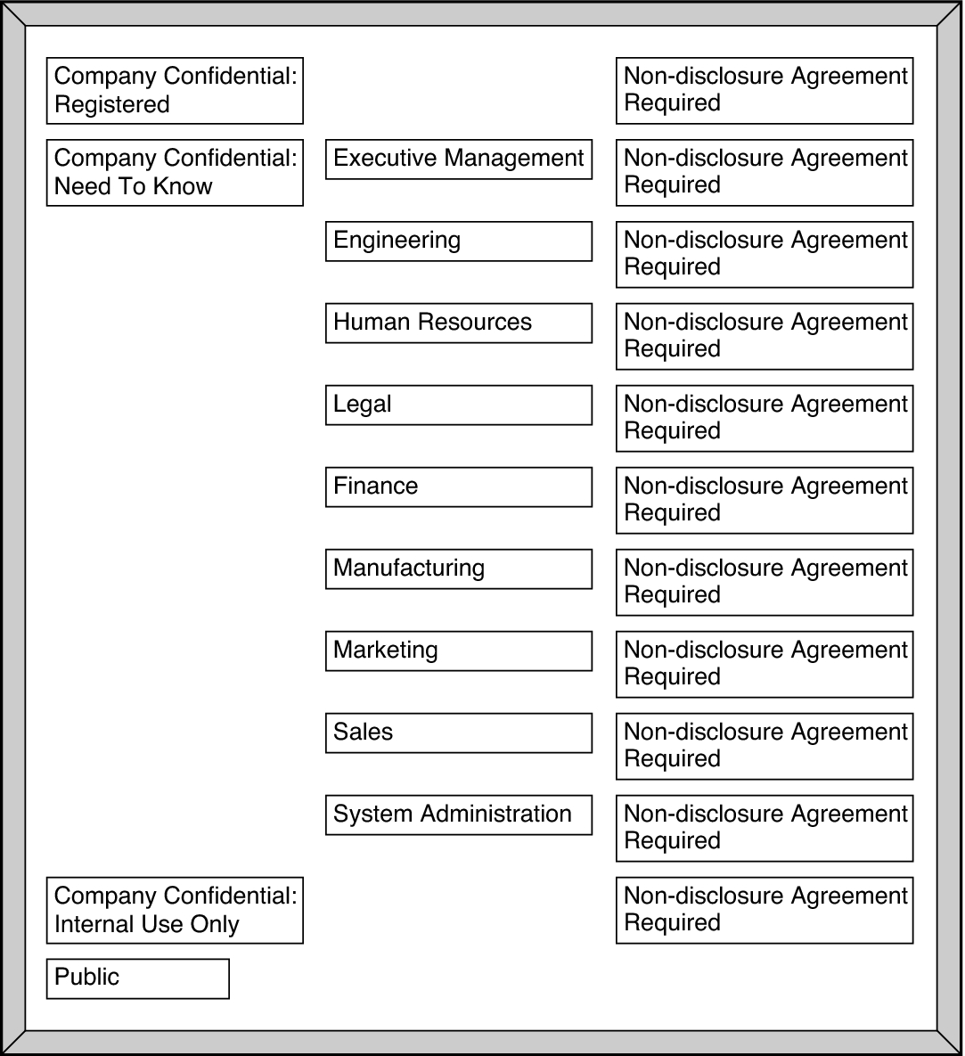

    Compartments are not intrinsically hierarchical. However, compartments can be configured to have hierarchical relationships. Before setting up relationships, study the example section in Compartmented Mode Workstation Labeling: Encodings Format .
    To make this step easier, use a large board and pieces of paper that represent your classifications and compartments. For an example, see Figure 2–1. With this method, you can visualize the relationships and rearrange the pieces until they all fit together.
    Note - Unless you are creating a set of encodings that must be compatible with another organization's labels, you can assign any valid number as a compartment bit. Keep track of the numbers that you use and their relationships to each other.
    Figure 2-1  Sample Planning Board for Label Relationships
    image:Graphic shows a board to help administrators plan label assignments.
