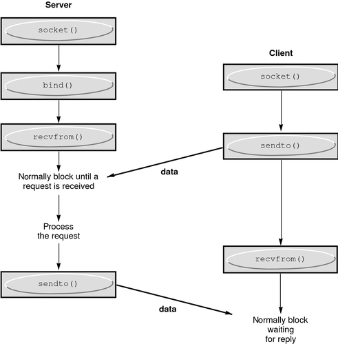

A datagram socket provides a symmetric data exchange interface without requiring connection establishment. Each message carries the destination address. The following figure shows the flow of communication between server and client.
The bind(3SOCKET) step for the server is optional.
Figure 7-2  Connectionless Communication Using Datagram Sockets
image:This graphic depicts data flow between a server and client, using the sendto and recvfrom functions.
Create datagram sockets as described in Socket Creation. If a particular local address is needed, the bind(3SOCKET) operation must precede the first data transmission. Otherwise, the system sets the local address or port when data is first sent. Use sendto(3SOCKET) to send data.

recvfrom(s, buf, buflen, flags, (struct sockaddr *) &from, &fromlen);
To receive messages on a datagram socket, recvfrom(3SOCKET) is used. Before the call, fromlen is set to the size of the from buffer. On return, fromlen is set to the size of the address from which the datagram was received.
