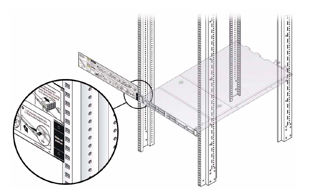

  2. Place the rackmount installation card against the front rails.
    The bottom edge of the card corresponds to the bottom edge of the server. Measure up from the bottom of the installation card.
    image:Figure showing the installation card being used for rackmount                             location.
  3. Mark the mounting holes for the front slide-rails.
  4. Mark the mounting holes for the rear slide-rails.
