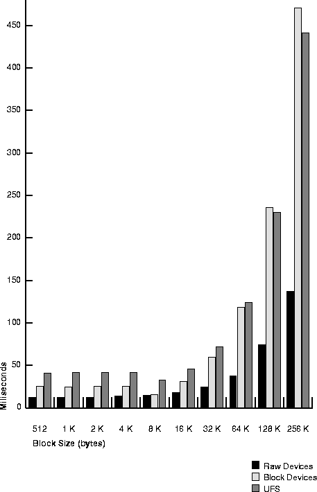

Table 20-7 and Figure 20-1 show speed of sequential read in milliseconds per I/O, for each of the three disk layout options on a test system.
Table 20-7 Block Size and Speed of Sequential Read (Sample Data)
Block Size   Speed of Sequential Read on:
Raw Device   Block Device   UNIX File System
512 bytes
Doing research like this helps determine the correct stripe size. In this example, it takes at most 5.3 milliseconds to read 16KB. If your data were in chunks of 256KB, you could stripe the data over 16 disks (as described) and maintain this low read time.
By contrast, if all your data were on one disk, read time would be 80 milliseconds. Thus the test results show that on this particular set of disks, things look quite different from what might be expected: it is sometimes beneficial to have a smaller stripe size, depending on the size of the I/O.
Figure 20-1 Block Size and Speed of Sequential Read (Sample Data)

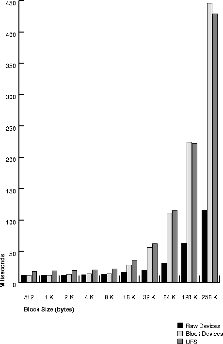

Table 20-8 and Figure 20-2 show speed of sequential write in milliseconds per I/O, for each of the three disk layout options on the test system.
Table 20-8 Block Size and Speed of Sequential Write (Sample Data)
Block Size   Speed of Sequential Write on
512 bytes
Figure 20-2 Block Size and Speed of Sequential Write (Sample Data)

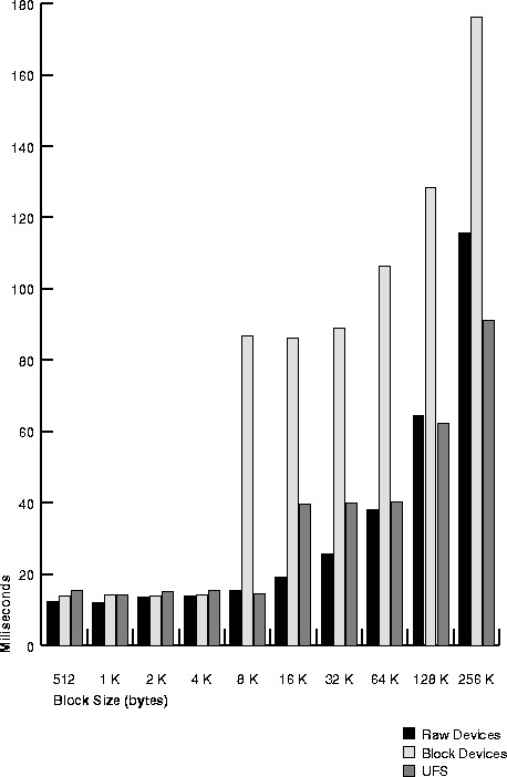

Table 20-10 and Figure 20-4 show speed of random write in milliseconds per I/O, for each of the three disk layout options on the test system.
Table 20-10 Block Size and Speed of Random Write (Sample Data)
Block Size   Speed of Random Write on
512 bytes
Figure 20-4 Block Size and Speed of Random Write (Sample Data)
