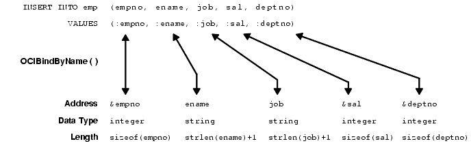

For example, given the INSERT statement
INSERT INTO emp VALUES (:empno, :ename, :job, :sal, :deptno)
and the following variable declarations
text *ename, *job sword empno, sal, deptno
the bind step makes an association between the placeholder name and the address of the program variables. The bind also indicates the datatype and length of the program variables, as illustrated in Figure 5-1. The code that implements this example is found in the section "Steps Used in Binding".

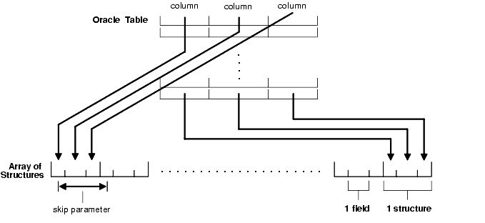

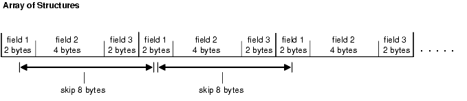

Static array bind attributes are set using the OCI array of structures bind call OCIBindArrayOfStruct(). This call is made following a call to OCIBindByName() or OCIBindByPos().
Note: A static array bind does not refer to binding a column of type ARRAY of scalars or named data types, but a bind to a PL/SQL table or for multiple row operations in SQL (INSERTs/UPDATEs).
The OCIBindArrayOfStruct() call is also used to define the skip parameters needed if the application utilizes arrays of structures functionality.
See Also: For more information on using arrays of structures, see the section "Arrays of Structures".

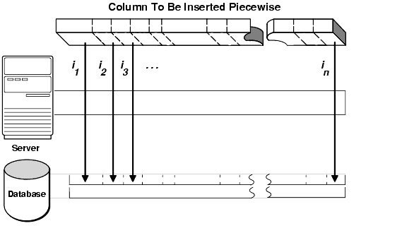

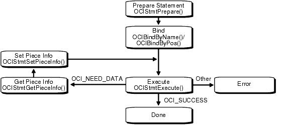

If the OCI_DATA_AT_EXEC mode is chosen, but the standard OCI piecewise polling method will be used instead of callbacks, the call to OCIBindDynamic() is not necessary.
When binding RETURN clause variables, an application must use OCI_DATA_AT_EXEC mode, and it must provide callbacks.
See Also: For more information about piecewise operations, please refer to the section "Run Time Data Allocation and Piecewise Operations".

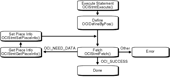

Defining output variables is done in one or more steps. A basic define is accomplished with the OCI define by position call, OCIDefineByPos(). This step creates an association between a select-list item and an output variable. Additional define calls may be necessary for certain datatypes or fetch modes.
Once the define step is complete, the OCI library knows where to put retrieved data after fetching it from the database.

The "arrays of structures" functionality of the Oracle OCI can simplify the processing of multi-row, multi-column operations. The OCI programmer can create a structure of related scalar data items and then fetch values from the database into an array of these structures or insert values into the database from an array of these structures.
For example, an application may need to fetch multiple rows of data from three columns named NAME, AGE, and SALARY. The OCI application could include the definition of a structure containing separate fields to hold the NAME, AGE and SALARY data from one row in the database table. The application would then fetch data into an array of these structures.
In order to perform a multi-row, multi-column operation using an array of structures, the developer associates each column involved in the operation with a field in a structure. This association, which is part of the OCIDefineArrayOfStruct() and OCIBindArrayOfStruct() calls, specifies where fetched data will be stored, or where inserted or updated data will be found.
Figure 5-2, "Fetching Data Into an Array of Structures" is a graphical representation of this process. In the figure, an application fetches various fields from a database row into a single structure in an array of structures. Each column being fetched corresponds to one of the fields in the structure.
When you split column data across an array of structures, it is no longer contiguous. The single array of structures stores data as though it were composed of several interleaved arrays of scalars. Because of this fact, developers must specify a "skip parameter" for each field they are binding or defining. This skip parameter specifies the number of bytes that need to be skipped in the array of structures before the same field is encountered again. In general this will be equivalent to the byte size of one structure.
The figure below demonstrates how a skip parameter is determined. In this case the skip parameter is the sum of the sizes of the fields field1, field2 and field3, which is 8 bytes. This equals the size of one structure.
On some systems it may be necessary to set the skip parameter to be sizeof(one array element) rather than sizeof(struct). This is because some compilers may insert padding into a structure. For example, consider an array of C structures consisting of two fields, a ub4 and a ub1.
struct demo { ub4 field1; ub1 field2; }; struct demo demo_array[MAXSIZE];
Some compilers insert three bytes of padding after the ub1 so that the ub4 which begins the next structure in the array is properly aligned. In this case, the following statement may return an incorrect value:
skip_parameter = sizeof(struct demo);
On some systems this will produce a proper skip parameter of eight. On other systems, skip_parameter
will be set to five bytes by this statement. In this case, use the following statement to get the correct value for the skip parameter:
skip_parameter = sizeof(demo_array[0]);

You can use the OCI to perform piecewise inserts and updates, and fetches of data. You can also use the OCI to provide data dynamically in the case of array inserts or updates, instead of providing a static array of bind values. You can insert or retrieve a very large column as a series of chunks of smaller size, minimizing client-side memory requirements.
The size of individual pieces is determined at run time by the application. Each piece may be of the same size as other pieces, or it may be of a different size.
The OCI's piecewise functionality can be particularly useful when you are performing operations on extremely large blocks of string or binary data (for example, operations involving database columns that store LOB, LONG or LONG RAW data). See the section "Valid Datatypes for Piecewise Operations" for information about which datatypes are valid for piecewise operations.
Figure 8-1, "Multiple Tightly Coupled Branches" shows a single long column being inserted piecewise into a database table through a series of insert operations (i1, i2, i3...in). In this example the inserted pieces are of varying sizes.

Similarly, when you set the mode parameter of an OCIDefineByPos() call to OCI_DYNAMIC_FETCH, this indicates that an application will dynamically provide allocation space for receiving data at the time of the fetch.
In each case, you can provide the run-time information for the INSERT, UPDATE, or FETCH in one of two ways: through callback functions, or by using piecewise operations. If callbacks are desired, an additional bind or define call is necessary to register the callbacks.

Following the statement preparation and bind, the application performs a series of calls to OCIStmtExecute(), OCIStmtGetPieceInfo() and OCIStmtSetPieceInfo() to complete the piecewise operation. Each call to OCIStmtExecute() returns a value that determines what action should be performed next. In general, the application retrieves a value indicating that the next piece needs to be inserted, populates a buffer with that piece, and then executes an insert. When the last piece has been inserted, the operation is complete.
Keep in mind that the insert buffer can be of arbitrary size and is provided at run time. In addition, each inserted piece does not need to be of the same size. The size of each piece to be inserted is established by each OCIStmtSetPieceInfo() call.
Note: If the same piece size is used for all inserts, and the size of the data being inserted is not evenly divisible by the piece size, the final inserted piece will be smaller than the pieces that preceded it. For example, if a data value 10,050,036 bytes long is inserted in chunks of 500 bytes each, the last remaining piece will be only 36 bytes. The programmer must account for this by indicating the smaller size in the final OCIStmtSetPieceInfo() call.
The following steps outline the procedure involved in performing a piecewise insert. The procedure is illustrated in Figure 5-5, "Steps for Performing Piecewise Insert".
Step 1. Initialize the OCI environment, allocate the necessary handles, connect to a server, authorize a user, and prepare a statement request. These steps are described in the section "OCI Programming Steps".
Step 2. Bind a placeholder using OCIBindByName() or OCIBindByPos(). At this point you do not need to specify the actual size of the pieces you will use, but you must provide the total size of the data that can be provided at run time.
7.x Upgrade Note: The context pointer that was formerly part of the obindps() and ogetpi() routines does not exist in release 8.0. Clients wishing to provide their own context can use the callback method.
Step 3. Call OCIStmtExecute() for the first time. At this point no data is actually inserted, and the OCI_NEED_DATA error code is returned to the application.
If any other value is returned, it indicates that an error occurred.
Step 4. Call OCIStmtGetPieceInfo() to retrieve information about the piece that needs to be inserted. The parameters of OCIStmtGetPieceInfo() include a pointer that returns a value indicating whether the required piece is the first piece (OCI_FIRST_PIECE) or a subsequent piece (OCI_NEXT_PIECE).
Step 5. The application populates a buffer with the piece of data to be inserted and calls OCIStmtSetPieceInfo(). The parameters passed to OCIStmtSetPieceInfo() include a pointer to the piece, a pointer to the length of the piece, and a value indicating whether this is the first piece (OCI_FIRST_PIECE), an intermediate piece (OCI_NEXT_PIECE) or the last piece (OCI_LAST_PIECE).
Step 6. Call OCIStmtExecute() again. If OCI_LAST_PIECE was indicated in Step 5 and OCIStmtExecute() returns OCI_SUCCESS, all pieces were inserted successfully. If OCIStmtExecute() returns OCI_NEED_DATA, go back to Step 3 for the next insert. If OCIStmtExecute() returns any other value, an error occurred.
The piecewise operation is complete when the final piece has been successfully inserted. This is indicated by the OCI_SUCCESS return value from the final OCIStmtExecute() call.

The following steps outline the method for fetching a row piecewise.
Step 1. Initialize the OCI environment, allocate necessary handles, connect to a database, authorize a user, prepare a statement, and execute the statement. These steps are described in "OCI Programming Steps".
Step 2. Define an output variable using OCIDefineByPos(), with mode set to OCI_DYNAMIC_FETCH. At this point you do not need to specify the actual size of the pieces you will use, but you must provide the total size of the data that will be fetched at run time.
7.x Upgrade Note: The context pointer that was part of the odefinps() and ogetpi() routines does not exist in release 8.0. Clients wishing to provide their own context can use the callback method.
Step 3. Call OCIStmtFetch() for the first time. At this point no data is actually retrieved, and the OCI_NEED_DATA error code is returned to the application.
If any other value is returned, an error occurred.
Step 4. Call OCIStmtGetPieceInfo() to obtain information about the piece to be fetched. The piecep parameter indicates whether it is the first piece (OCI_FIRST_PIECE), a subsequent piece (OCI_NEXT_PIECE), or the last piece (OCI_LAST_PIECE).
Step 5. Call OCIStmtSetPieceInfo() to specify the buffer into which you wish to fetch the piece.
Step 6. Call OCIStmtFetch() again to retrieve the actual piece. If OCIStmtFetch() returns OCI_SUCCESS, all the pieces have been fetched successfully. If OCIStmtFetch() returns OCI_NEED_DATA, return to Step 4 to process the next piece. If any other value is returned, an error occurred.
The piecewise fetch is complete when the final OCIStmtFetch() call returns a value of OCI_SUCCESS.
In both the piecewise fetch and insert, it is important to understand the sequence of calls necessary for the operation to complete successfully. In particular, keep in mind that for a piecewise insert you must call OCIStmtExecute() one time more than the number of pieces to be inserted (if callbacks are not used). This is because the first time OCIStmtExecute() is called, it merely returns a value indicating that the first piece to be inserted is required. As a result, if you are inserting n pieces, you must call OCIStmtExecute() a total of n+1 times.
Similarly, when performing a piecewise fetch, you must call OCIStmtFetch() once more than the number of pieces to be fetched.
