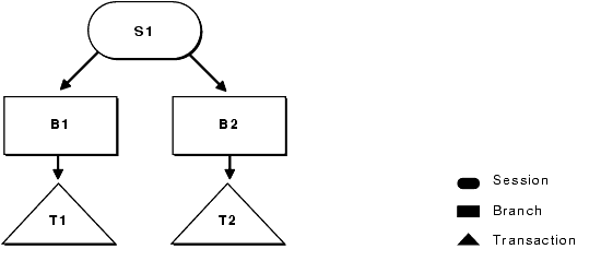

The following figure illustrates tightly coupled branches within an application. In the figure, S1 and S2, are sessions, B1 and B2 are branches, and T is a transaction. In this first example, the XIDs of the two branches would share the same gtrid, because they are operating on the same transaction, but they would have a different bqual, because they are separate branches
It is also possible for a single session to operate on different branches. In this case, illustrated in the next figure, gtrid component of the XIDs would be different, because they are separate global transactions
For sample code demonstrating this scenario, refer to the examples for OCITransStart(). It is possible for a single session to operate on multiple branches that share the same transaction, but this scenario does not have much practical value. Sample code demonstrating this scenario can be found in the examples for OCITransStart().
