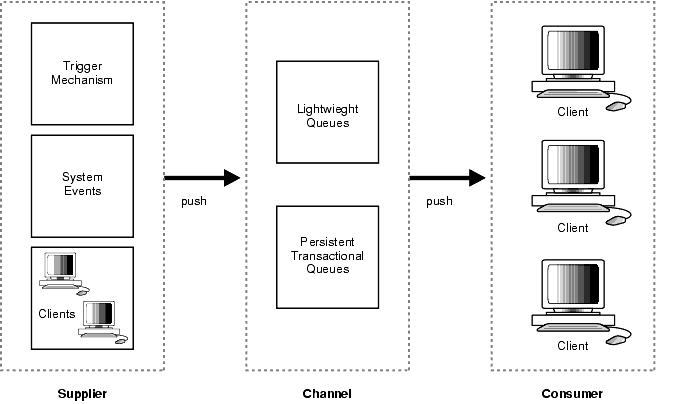

The publish-subscribe notification feature allows an OCI application to receive client notifications. Figure 9-1, "Publish-Subscribe Model" illustrates the process. An OCI application can:
Registered clients are notified asynchronously when events are triggered or on an explicit AQ enqueue. Clients do not need to be connected to a database.
For information on Advanced Queuing, see "OCI and Advanced Queuing".
See Also: For information on creating queues and about AQ, including concepts, features, and examples, refer to the chapter on Advanced Queuing in the Oracle8i Application Developer's Guide - Advanced Queuing. For information on creating triggers, refer to the chapter on Commands in the Oracle8i SQL Reference.

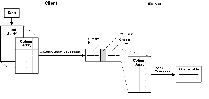

The direct path load interface allows an OCI application to access the direct path load engine of the Oracle database server to perform the functions of the Oracle SQL*Loader utility. This functionality provides the ability to load data from external files into Oracle database objects, either a table or a partition of a partitioned table.
The OCI direct path load interface has the ability to load multiple rows by loading a direct path stream which contains data for multiple rows.
To use the direct path API, the client application performs the following steps:
A direct load operation requires that the object being loaded is locked to prevent DML on the object. Note that queries are lock free and are allowed while the object is being loaded. The mode of the DML lock, and which DML locks are obtained depend upon the specification of the OCI_DIRPATH_PARALLEL_LOAD option, and if a partition or sub-partition load is being done as opposed to an entire table load. For more information on OCI_DIRPATH_PARALLEL_LOAD, see OCIDirPathPrepare().
The direct path load interface has the following limitations which are the same as SQL*Loader:
The following external datatypes are valid for columns in a direct path load operation: SQLT_CHR, SQLT_DAT, SQLT_INT, SQLT_UIN, SQLT_FLT, SQLT_PDN, SQLT_BIN, or SQLT_NUM. For information on setting or retrieving the datatype of a column, see OCI_ATTR_DATA_TYPE. For information on datatypes, see Chapter 3, "Datatypes".
A direct path load corresponds to a direct path array insert operation. The direct path load interface uses the following handles to keep track of the objects loaded and the specification of the data operated on:

This handle is used by the conversion operation, OCIDirPathColArrayToStream(), and by the load operation, OCIDirPathLoadStream().
Direct path stream handles is allocated by the client with OCIHandleAlloc(). The structure of a OCIDirPathStream handle can be thought of as a pair in the form (buffer, buffer length).
A direct path stream is a linear representation of Oracle table data. The conversion operations always append to the end of the stream. Load operations always start from the beginning of the stream. After a stream is completely loaded, the stream must be reset by calling OCIDirPathStreamReset().
