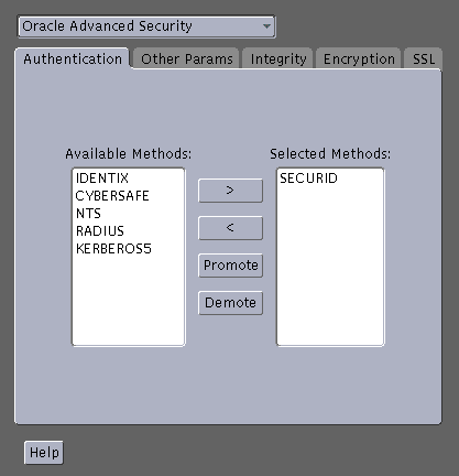

Task 5: Configure SecurID Authentication
Perform the following steps to configure SecurID authentication service:
  1. Start Net8 Assistant:
    • On UNIX, run netasst from $ORACLE_HOME/bin.
    • On Windows NT, choose Start > Programs > Oracle - HOME_NAME > Network Administration > Net8 Assistant.
  2. In the navigator's pane, expand Local > Profile.
  3. From the list in the right pane, select Oracle Advanced Security.
    The Oracle Advanced Security tabbed pages appear.
  4. Click the Authentication tab.
  5. From the Available Methods list, select SECURID.
  6. Move SECURID to the Selected Methods list by clicking the right-arrow button [>].
  7. Arrange the selected methods in order of desired use. To do this, select a method in the Selected Methods list, then click Promote or Demote to position it in the list. For example, for SECURID to be the first service used, move it to the top of the list.
  8. Choose File > Save Network Configuration.
    The sqlnet.ora file updates with the following entries:
    SQLNET.AUTHENTICATION_SERVICES=(SECURID)
