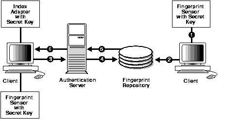

The Biometric Authentication Service uses Identix Biometric Authentication to provide tamper-proof biometric authentication of users using secret-key MD5 hashing, centralized management of biometrically identified users, and centralized management of those database servers that authenticate biometrically identified users.
This section describes how the Biometric Authentication Service works in a client-server environment.
Figure 8-1 shows the components and the configuration of the Biometric Authentication Service.
Figure 8-1 Typical Biometric Authentication Service Configuration
The Fingerprint Repository has one administrator who is responsible for enrolling multiple users' fingerprint templates and defining the DEFAULT policy that is in force for all databases that subscribe to the fingerprint server for authentication.
The Fingerprint Security Service Administrator uses a desktop fingerprint scanner to read user fingerprints, convert them into fingerprint templates, and send them with measured accuracies to the Biometric Authentication Service. The Biometric Authentication Service stores the fingerprint templates in the Fingerprint Repository, an Oracle database. The measured accuracy of a fingerprint is an estimate of how reliable a comparison can be made between the stored fingerprint template and the user's fingerprint that is scanned later for authentication. The enrollment quality is expressed as a percent score between 0 and 100. For example, a user may have an enrollment quality of 72 percent.
Architecture of the Biometric Authentication Service
The Biometric Authentication Service consists of the following modules:
Both the manager and the client-side adapter interface with Identix products: TouchSafe II Software Libraries, TouchSafe II Hardware Interface, TouchSafe II Desktop Sensor, TouchSafe III software libraries, and TouchSafe III desktop sensor.
More Information:
For a list of Identix documentation that describes these Identix products, see "Related Publications" in the Preface.
Administration Architecture
The Fingerprint Security Server Administrators use the manager to scan user fingerprints, measure the accuracy of the fingerprints, and establish security policies for database servers. The manager sends this information to the authentication server, which stores the data in the repository.
The administrator, or someone who can be trusted, uses the Identix TouchSafe II or TouchSafe III software to store the secret key on the TouchSafeII or TouchSafe III device. This key must match the key stored in the DEFAULT security policy before authentication can occur.
Authentication Architecture
Each user who wants to use the system must place a fingerprint on a TouchSafe II or TouchSafe II Desktop Sensor. The client-side adapter sends an authentication request to the server-side adapter which uses the previously enrolled fingerprint stored in the authentication server for comparison. For each authentication request from a client, the authentication server retrieves and sends the user's fingerprint and the database server's security policy back to the client-side adapter via the server-side adapter.
The user's authentication request causes the client-side Oracle Advanced Security Identix authentication adapter to send the request to the server side biometric authentication adapter, which looks up the user's fingerprint in the authentication server, which returns the stored fingerprint and the associated security policy.
Using threshold level values from the associated security policy, the client side adapter uses the TouchSafe II Software Libraries to set threshold values on the TouchSafe II Desktop Sensor. It then prompts for the placing of the user's finger on the TouchSafe II Desktop Sensor. The adapters on the client and the database server work together to compare the user's fingerprint, the secret key, and the threshold levels against the administrator-entered security policy stored in the authentication server repository. If this data matches, the user is authenticated.

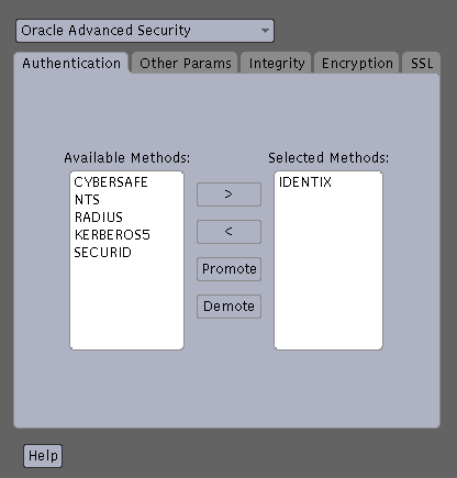

  4. Click the Authentication tab.
  5. From the Available Methods list, select IDENTIX.
  6. Move IDENTIX to the Selected Methods list by clicking the right-arrow button [>].
  7. Arrange the selected methods in order of use. To do this, select a method in the Selected Methods list, then click Promote or Demote to position it in the list. For example, if you want IDENTIX to be the first service used, put it at the top of the list.

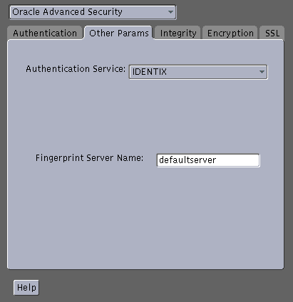

  8. Click the Other Params tab.
  9. From the Authentication Service list, select IDENTIX.
  10. In the Fingerprint Server Name box, enter the name of the fingerprint server you want to use.
  11. Choose File > Save Network Configuration.
