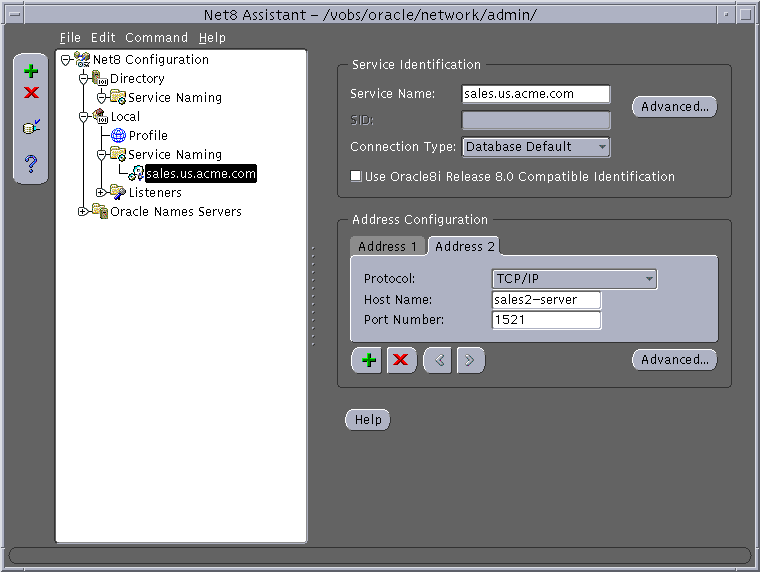

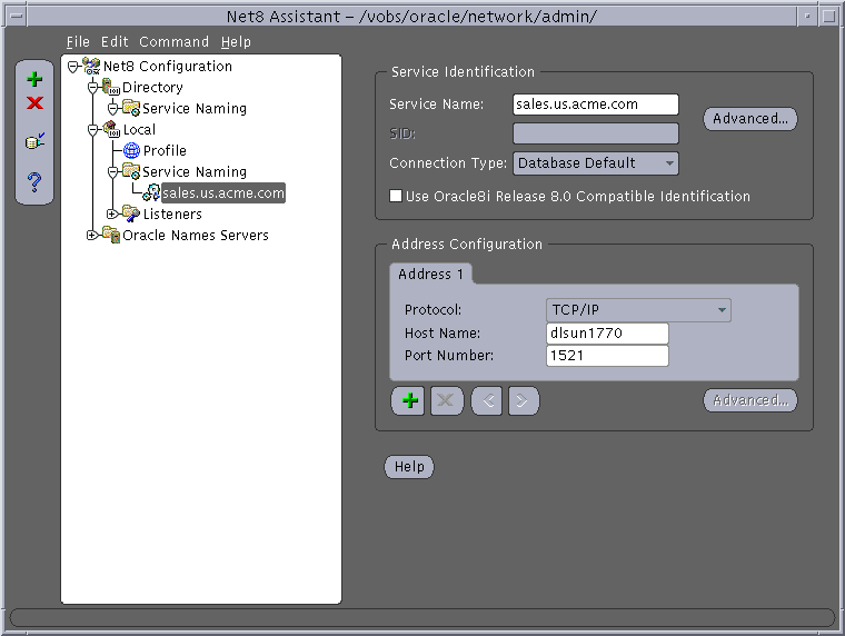

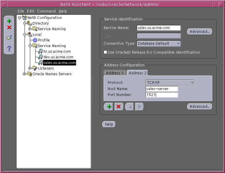

To add a network protocol address to an existing net service name or database service:
  1. Start Net8 Assistant:
    • On UNIX, run netasst from $ORACLE_HOME/bin.
    • On Windows NT, choose Start > Programs > Oracle - HOME_NAME > Network Administration > Net8 Assistant.
  2. In the navigator pane, expand Directory or Local > Service Naming.
  3. Select either a net service name or a database service.
    The right pane displays the current destination service and address list.
  4. In the Address Configuration box, click "+".
    A new address tab appears:
  5. Select the protocol and enter appropriate address information.
    See Also:
    Appendix B for details about protocol address parameters
  6. Order the protocol addresses according to where they should be in the address list with the left-arrow and right-arrow buttons. Unless multiple address options are configured, the first address in the list is contacted.
    See Also:
    "Configuring Address List Parameters" for address list options
  7. Click Apply.

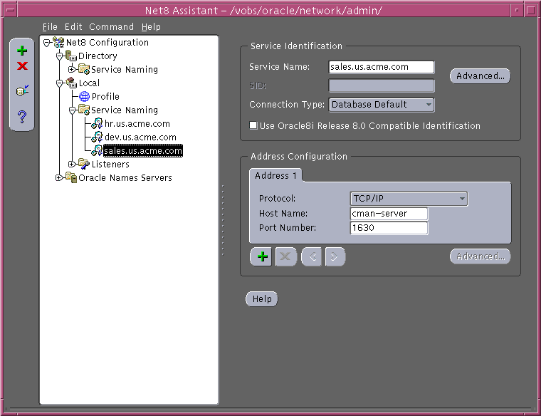

    The right pane displays the current destination service and address list:
  4. In the Address Configuration box, click Advanced.
    The Address List Options dialog box appears:

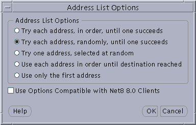

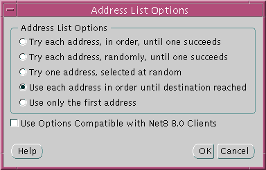

    The following table describes the options:
    Net8 Assistant Option  Parameter
    Try each address, in order, until one succeeds
    FAILOVER=ON for release 8.1 clients
    SOURCE_ROUTE=OFF for pre-release 8.1 clients.
    Try each address, randomly, until one succeeds
    Note: This option is not enabled if "Use Options Compatible with Net8 8.0 Clients" is selected.
    LOAD_BALANCE=ON
    FAILOVER=ON
    Try one address, selected at random
    LOAD_BALANCE=ON
    Use each address in order until destination reached
    SOURCE_ROUTE=ON
    Use only the first address
    LOAD_BALANCE=OFF
    FAILOVER=OFF
    SOURCE_ROUTE=OFF
  5. Select one of the address list options, then click OK.

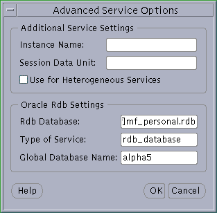

Oracle Rdb Settings
RDB_DATABASE)
Oracle RDB Database
Specifies the file name of an Oracle RDB database
See Also: "Configuring Net8 for an Oracle Rdb Database"
TYPE_OF_SERVICE)
Type of Service
Specifies the type of service to use for an Oracle RDB database
GLOBAL_NAME)
Global Database Name
Identifies the Oracle Rdb database

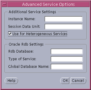

  4. In the Service Identification box, click Advanced.
    The Advanced Service Options dialog box appears:
  5. Enter fields or select options as appropriate, then click OK.
  6. In the right pane, click Apply.

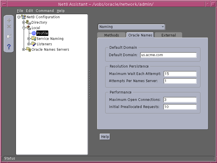

Configuring a Default Domain for Clients
In environments where the client often requests names from a specific domain, it is appropriate to set a default domain in the client's sqlnet.ora file with the NAMES.DEFAULT_DOMAIN parameter.
When a default domain is set, it is automatically appended to any unqualified net service name given in the connect string, and then compared to net service names stored in a tnsnames.ora file or Oracle Names server.
For example, if the client tnsnames.ora file contains a net service name of sales.us.acme.com, the user can enter the following connect string:
CONNECT scott/tiger@sales
In this example, sales gets searched as sales.us.acme.com.
If the connect string includes the domain extension, such as in CONNECT scott/tiger@sales.acme.com, the domain is not appended. If a net service name in a tnsnames.ora file or Oracle Names server is not domain qualified and this parameter is set, the net service name must be entered with a dot ("."). For example, if domain is set to us.acme.com and the client tnsnames.ora file contains a net service name of sales, the user would enter the following connect string:
During installation, Net8 Configuration Assistant sets the default domain to your client's network domain.
To specify a default domain:
  2. In the navigator pane, expand Local > Profile.
  3. From the list in the right pane, select Naming.
  4. Click the Oracle Names tab:
  5. In the Default Domain field, enter the domain.
  6. Choose File > Save Network Configuration.
    The sqlnet.ora file should contain an entry that looks like the following:
    names.default_domain=com

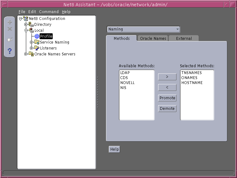

Prioritizing Naming Methods
After naming methods are configured, as described in Chapter 6, they must be prioritized. The naming method at the top of the list is used first to resolve a net service name. If it cannot resolve the net service name, the second method in the list is used to resolve the net service name.
To specify the order of naming methods:
  4. Click the Methods tab:
    Available naming methods are described in the following table:
    Naming Method  Description
    TNSNAMES
    Local Naming
    Net service names are resolved using the tnsnames.ora file which resides on the client.
    LDAP
    Directory Naming
    Net service names and database service names are resolved through a directory server.
    ONAMES
    Oracle Names
    Net service names and database service names are resolved centrally, through an Oracle Names server.
    HOSTNAME
    Host Naming
    Net service names are resolved using the host naming method. Certain criteria must be met to use host naming.
    See Also: "Configuring the Host Naming Method"
    CDS
    Cell Directory Services
    This naming method is available with Oracle Advanced Security option.
    See Also: Oracle Advanced Security Administrator's Guide
    NDS
    Novell Directory Services (NDS)
    NIS
    Network Information Service (NIS)
  5. Choose from the Available Methods list which naming method you want to use.
  6. Select naming methods from the Available Methods list, then click the right-arrow button.
    The naming method moves to the Selected Methods list.
  7. Order the naming methods according to the order in which you want Net8 to try to resolve the net service name or database service name. Select a naming method in the Selected Methods list, and click Promote or Demote to move the selection up or down in the list.
  8. Choose File > Save Network Configuration.
    The sqlnet.ora file updates with the NAMES.DIRECTORY_PATH parameter:
    names.directory_path=(onames, tnsnames)

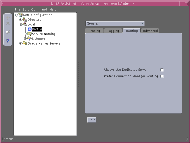

To route connection requests:
  3. From the list in the right pane, select General.
  4. Click the Routing tab:
  5. Click the preferred way you want connection requests routed.

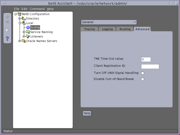

To set advanced features for clients:
  4. Click the Advanced tab:
  5. Enter the values for the option(s) you would like to set.

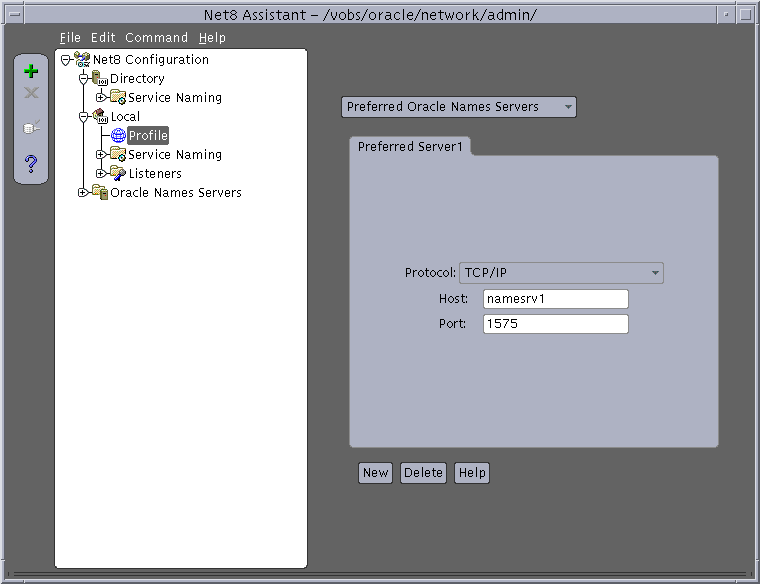

Configuring Preferred Oracle Names Servers
If you are using Oracle Names as a naming method, you can specify the name and address of preferred Oracle Names servers to take precedence over any other available Oracle Names server addresses. Net8 routes name resolution requests to each preferred Oracle Names Server until a response is received.
Preferred Oracle Names servers are an alternative to using the Discover Oracle Names Servers command in Net8 Assistant or the REORDER_NS command in the NAMESCTL control utility. These commands create a list of Oracle Names servers based on what is available throughout the network and ranks them in the order of fastest response time. Preferred Oracle Names servers override any other Oracle Names servers found during the discovery process. Once you have initially discovered an Oracle Names server, you may want to delete preferred Oracle Names servers.
See Also:
To specify a preferred Oracle Names server:
  3. From the list in the right pane, select Preferred Oracle Names Servers.
  4. Click New:
  5. Choose the protocol and enter the requested protocol address information for an Oracle Names server configured on that address.
    See Also:
    Appendix B for protocol parameter settings
  6. Repeat Steps 4 and 5 for each additional Oracle Names server you want added to the list.
  7. Choose File > Save Network Configuration.
    The sqlnet.ora file updates with the NAMES.PREFERRED_SERVERS parameter:
    names.preferred_servers=
      (address=(protocol=tcp) (host=namesrv1)(port=1575))
    The preferred Oracle Names server(s) must match the Oracle Names listening protocol address(es) you configured in the names.ora file with the NAMES.ADDRESSES parameter.

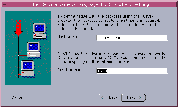

Task 3: Configure Clients
Client support is accomplished by creating two addresses, the first for the Oracle Connection Manager and the second for the listener. Configuration varies according to naming method, as described in the following table:
Naming Method  Procedure
Local Naming and Directory Naming
An address list must be created, where the first address must be for the Oracle Connection Manager, and the second address must be for the listener. In order to have the client connect to the Oracle Connection Manager first and have the Oracle Connection Manager then connect to the listener, the SOURCE_ROUTE parameter must be set.
See Also: "Configuring Clients for Oracle Connection Manager" to configure the Oracle Connection Manager and listener addresses

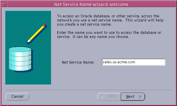

  3. Click "+" from the toolbar, or select Create from the Edit menu.
    The Net Service Name Wizard starts.
  4. Enter any name in the Net Service Name field, then click Next:

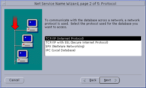

  5. Select the protocol the Oracle Connection Manager is configured to listen on, then click Next. By default this protocol is TCP/IP.
  6. Enter network protocol information for the Oracle Connection Manager, then click Next. If you are using TCP/IP, the default port is 1630.

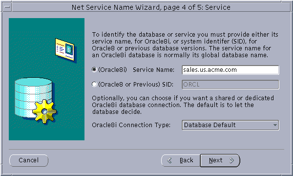

  7. Select a release, enter a destination service, then click Next:
    If the destination service is Oracle release 8.1, click (Oracle8i), and enter a service name in the Service Name field. If destination service is Oracle release 8.0 or version 7 database, click (Oracle8 or Previous), and enter an Oracle System Identifier (SID) in the Database SID field.
    See Also:
    "Understanding Connect Descriptors" for further information about setting the service name string

Task 2: Configure the Listener Address
After the Oracle Connection Manager address is specified, create an address for the listener, so that the Oracle Connection Manager can connect to the server.
To configure the listener address:
  1. Click the net service name you created in "Task 1: Configure an Oracle Connection Manager Address".
    Notice the Oracle Connection Manager address is displayed in the Address 1 tab:
  2. Click "+".
    A new address tab displays.
  3. Select the protocol, then enter protocol information for the listener. If you are using TCP/IP, the default port number is 1521:
    See Also:
  5. Select "Use each address in order until destination reached", then click OK.
    This option sets SOURCE_ROUTE=ON. It tells the client to connect to the first address, the Oracle Connection Manager, and from the first address to the second address, the listener.
    There is not an option that supports client load balancing and connect-time failover options with Oracle Connection Manager's source routing feature within the same address list. When SOURCE_ROUTE is set, the first address is for the client connection to an Oracle Connection Manager and the second address is for the Oracle Connection Manager connection to a listener. Client load balancing and connect-time failover are disabled when SOURCE_ROUTE is set.
    It is possible to manually configure client load balancing and connect-time failover with source routing for multiple address lists. See "Examples".

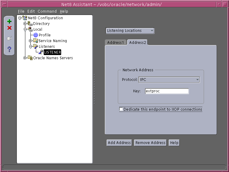

  1. Configure either a TCP/IP or IPC listening address in the listener.ora file. The following procedures describes creating an IPC address:
      -On UNIX, run netasst from $ORACLE_HOME/bin.
      -On Windows NT, choose Start > Programs > Oracle - HOME_NAME > Network Administration > Net8 Assistant.
    2. In the navigator pane, expand Local > Listeners.
    3. Select a listener.
    4. From the list in the right pane, select Listening Locations.
    5. Click Add Address. A new address tab appears.
    6. Select IPC from the Protocol list, and enter a value for the KEY. Oracle Corporation recommends a KEY value of extproc.
      See Also:
      "Configuring Listener Protocol Addresses" for more information about configuring listener protocol addresses

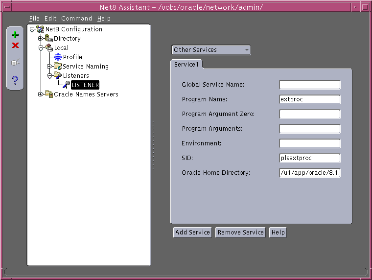

    To configure the SID_NAME, ORACLE_HOME, and PROGRAM parameters:
    1. From the list in the right pane, select Other Services.
    2. Click Add Service. A new Service tab appears:
    3. Enter extproc in the Program Name field, a SID, such as plsextproc, in the SID field, and the Oracle home where the extproc executable resides in the Oracle Home field,
    4. Choose File > Save Network Configuration.
      The listener.ora file updates with external procedures, as shown in the following:

    5. Click Advanced in the Service Identification group box.
    6. Click Use for Heterogeneous Service, then click OK.
      The tnsnames.ora file updates with the new net service name configured for Heterogeneous Services, as shown in the following:
  6. Enter the file name of an Oracle Rdb database in the Rdb Database field.
  7. Optionally, enter the global database name in the Global Database Name field, and, if needed, specify the type of service in the Type of Service field, then click OK.
    The tnsnames.ora file updates with the new net service name configured for the Oracle Rdb database, as shown in the following:
