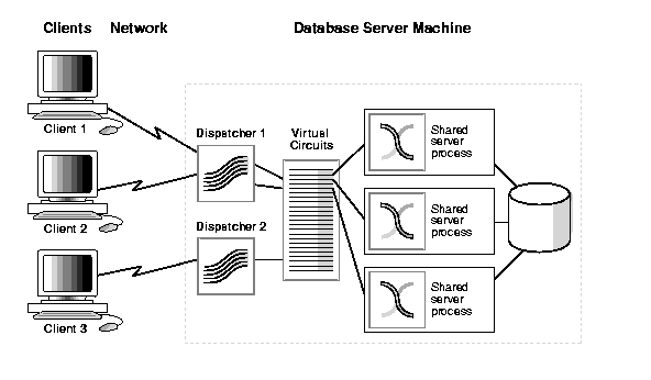

Consider an order entry system with a dedicated server architecture. A customer places an order as a clerk enters the order into the database. For most of the transaction, the clerk is on the telephone talking to the customer and the server process dedicated to the clerk's user process remains idle. The server process is not needed during most of the transaction, and the system is slower for other clerks entering orders because the idle server process is holding system resources.
The MTS architecture eliminates the need for a dedicated server process for each connection (see Figure 9-1). A dispatcher directs multiple incoming network session requests to a pool of shared server processes. An idle shared server process from a shared pool of server processes picks up a request from a common queue. This means a small number of shared servers can perform the same amount of processing as many dedicated servers. Also, since the amount of memory required for each user is relatively small, less memory and process management are required, and more users can be supported.
The advantage of MTS is that system overhead is reduced and less resources are used, allowing the number of users supported to be increased.
