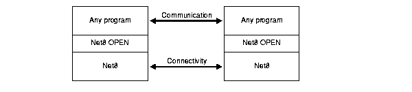

Net8 includes an application program interface (API), called Net8 OPEN, which enables programmers to:
Net8 OPEN provides applications a single common interface to all industry standard network protocols.
The relationship of Net8 OPEN to other products is shown in Figure 10-1.
Figure 10-1 Net8 OPEN
