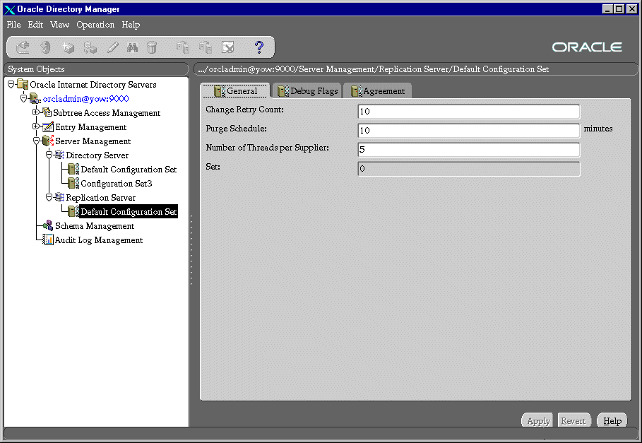

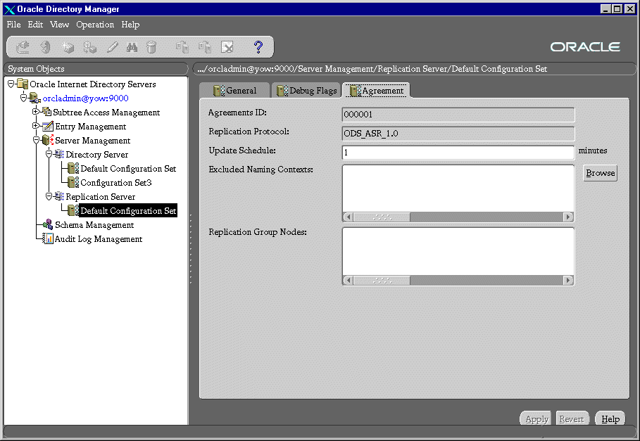

Viewing and Modifying Replication Configuration Parameters by Using Oracle Directory Manager
  1. In the navigator pane expand Server Management > Replication Server.
  2. Select the replication configuration set whose parameters you want to view or modify. The corresponding tab pages appear in the right pane:
Configuration parameters appear in the General and Debug Flags tab pages. You can use these tab pages to view replication configuration parameters, and modify many of them. The following tables describe the fields in each tab page.
Table 10-3 General Tab Page
Field  Description
Change Retry Count
The number of attempts that the conflict resolution process tries to apply each update before giving up and logging the incident. The default is 10.
Purge Schedule
The number of minutes in between running garbage collection. The replication garbage collection thread removes entries that are already applied or have been dropped as candidate changes. The default is 10.
Orcl Threads Per Supplier
Number of worker threads the Oracle Directory Replication Server provides for each supplier for change log processing. The default is 5.
Set
The configuration identifier
Table 10-4 Debug Flags Tab Page
Field  Description
Debug Level
The level of debugging that is set for this replication server. This number will be 32768 for replication-specific tracing.
Various debug flags
The only values you should change are the Trace Function Calls or the Any check box. Click these flags if you want to see more data during debugging.

Viewing and Modifying Replication Agreement Parameters by Using Oracle Directory Manager
To view and modify replication agreement parameters by using Oracle Directory Manager:
  1. In the navigator panel expand Server Management > Replication Server. Select Default Configuration Set.
  2. In the right pane, select the Agreement tab to display the replication agreement:
    The fields in this tab page are described in Table 10-5. You can view the parameters and modify some of them by double-clicking the attributes.
  3. When you have finished making your changes, click the Apply button. If you want to go back to using the values that appeared when you first opened this pane, click the Revert button.
