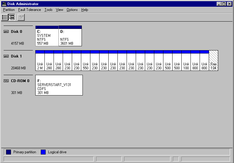

The Disk Administrator window below shows two disks. Disk 1 has an extended partition:
The following table describes the partitions on disk 0 and disk 1:
This disk... Contains...
Disk 0
Two primary partitions
Disk 1
An extended partition with nineteen logical partitions and 134 MB of free space (this disk device includes six physical disk drives)
The data files, control files and redo log files must be created on the logical partitions.
You can tell whether space is unpartitioned free space or free space within an extended partitions by the direction of the diagonal lines. Lines for free space within an extended partition display from top left to the bottom (\\), and lines for unpartitioned free space display from top right to the bottom (//).

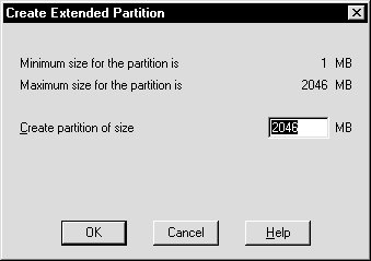

Step 2: Create an Extended Partition
Extended partitions point to raw space on disk drives. Multiple logical partitions are created in these extended partitions.
Only one extended partition can be created per disk. You can use the free space in the extended partition to create multiple logical partitions or use all or part of it when creating volume sets or other kinds of volumes for fault-tolerance purposes.
To create an extended partition, perform the following tasks:
  1. Shut down all nodes except one of the nodes.

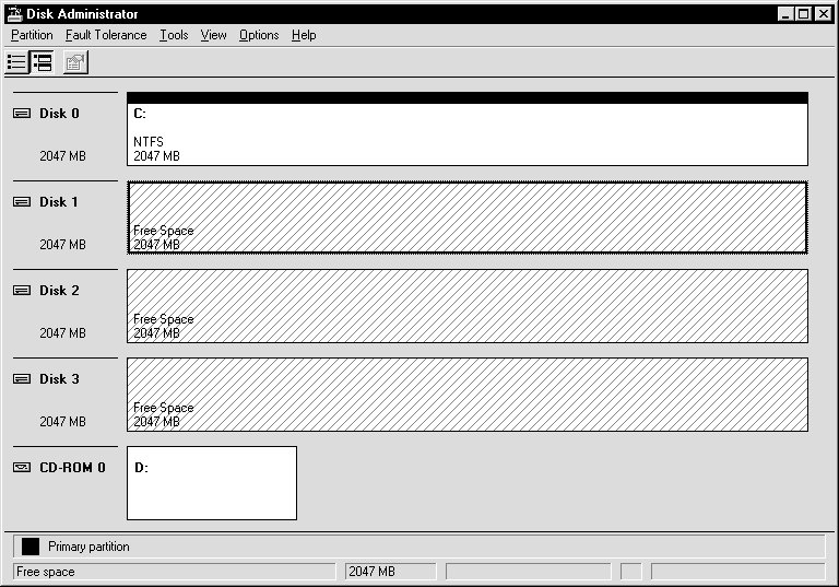

  2. On the node that is up, choose Start > Programs > Administrative Tools > Disk Administrator.
  3. The Disk Administrator window appears:
    Note the lines display diagonally from top right to the bottom left, indicating unpartitioned devices.
  4. Select an area of free space in an extended partition on a disk that is on the shared disk subsystem by clicking the mouse.
  5. Oracle Corporation recommends you use the entire disk.
  6. Choose Partition > Create Extended.
  7. The Disk Administrator displays the minimum and maximum sizes for the extended partition:
  8. Use the default maximum size, then click OK.
  9.
    Changes you have made are not saved until you choose Commit Changes Now from the Partition menu or quit the Disk Administrator.
    The extended partition is created.
    Note the lines now display diagonally from top left to bottom right, indicating the partition is an extended partition.

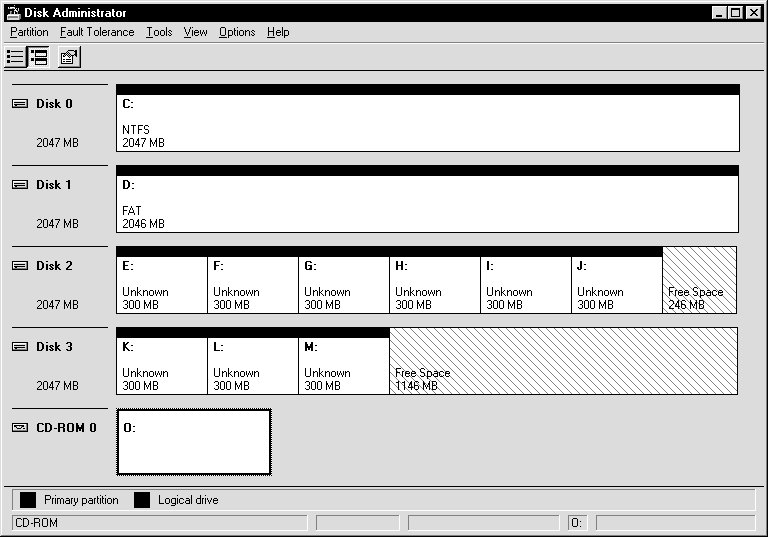

Step 3: Create Logical Partitions

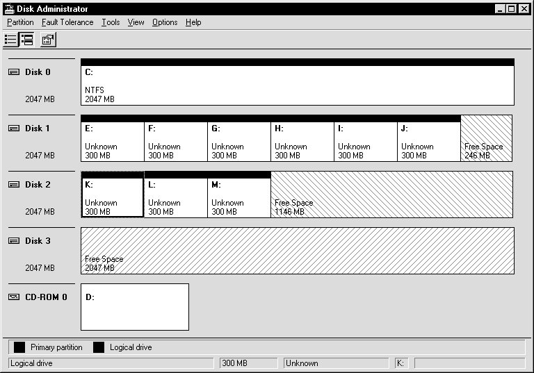

Logical partitions are created on one node of the cluster. To create logical partitions in an extended partition:
Oracle Corporation recommends you do not create more than 120 logical partitions in an extended partition.
  1. On one of the nodes, select an area of free space in an extended partition by clicking the mouse on it.
  2. Choose Partition > Create.
  3. The Disk Administrator window displays the minimum and maximum sizes for the logical partition.
  4. Enter the size of the logical partition, then click OK.
  5.
You can modify file sizes later, but not the raw devices. File sizes cannot expand the size of the raw device.
  1. Repeat Steps 1-3 until you have the required number of logical partitions.
  2. Choose Partition > Commit Changes Now.
  3. A confirmation dialog appears, informing you changes have been made to the disk.
  4. Click Yes to acknowledge the message.
  5. A dialog box appears, informing you the disks have been updated successfully.
  6. Click OK.
  7. Choose Partition > Close.
  8.
To make the changes visible, on all nodes of the cluster, choose Options > Refresh.

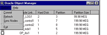

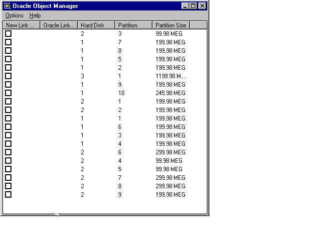

  4. To run the Object Link Manager, use the following command on one node in the cluster:
  5. C:> GUIORACLEOBJMANAGER.EXE
    The Object Link Manager appears.
  1. To add a mapping:
    1. Select the row containing the partition that you want to assign a link name.
    2. Click on the highlighted row to invoke the Edit window.
    3. Enter the new link name required for the Oracle Database Configuration Assistant file in the New Link Name column. For example, if the database name is OP, add OP_SYSTEM1 for the name of the SYSTEM tablespace data file.
    4. Press Enter.
    5. Repeat steps a to d for any additional edits.
    6. Choose Options > Commit to save all changes to disk.
    7. Verify all mappings are correct using Object Link Manager.
    8.
  2. On all nodes in the cluster, use the Object Link Manager to verify that symbolic links are correct. If you make any changes, choose the Commit menu item.
  3. The logical partitions and their symbolic links appear on the node from which the Oracle Object Manager application is run. Link names may appear in upper case; however, the names are case insensitive.
    To force all active nodes to re-synchronize the links, choose Options > Sync Nodes. Run the Object Link Manager on all nodes to refresh the links.
  6. Choose Partition > Create Extended...
  9.
  5.
  6. Click OK.
  8.
In previous releases, you needed to unassign drive letters. You no longer need to unassign drive letters. This release includes the utility Oracle Object Link Manager, which automatically unassigns link names.
The hard disks that access the shared area may be different from node to node. The logical partitions, however, that reside on the hard disks must be identical on all nodes.
For example, Node 1 may look like:
Node 2 may look like:
On Node 1, the logical partition E is defined as \Device\Harddisk1\Partition1. On Node 2, it is defined as \Device\Harddisk2\Partition1. Even though these map to different disks, they map to the same space on the shared disk.

    3. To run the Object Link Manager, use the following command on one node in the cluster:
    4. C:> GUIORACLEOBJMANAGER.EXE
    1. To add or rename a mapping:
      3. Enter the new link name in the New Link Name column. For example, if the database name is OP, add OP_SYSTEM1 for the name of the SYSTEM tablespace data file.
      4. Press Enter.

    3. On all nodes in the cluster, use the Object Link Manager to verify that symbolic links are correct.
    4. The logical partitions and their symbolic links appear on the node from which the Oracle Object Manager application is run. Link names may appear in upper case; however, the names are case insensitive.
      If you create or remove a partition, you need to reassign links by rerunning the Oracle Object Link Manager on the node you made the disk configuration.
      You do not need to reboot after making changes. However, if a node is down, it is automatically updated when you reboot. Rebooting also generates a log file, OOBJSERVICE.LOG in the directory where you installed the Oracle Object Service.
