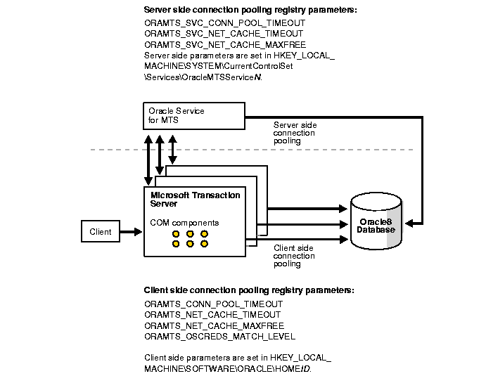

Managing Connections
When a COM component ends a session with the Oracle8 database, the connection by default does not immediately terminate. Instead, the connection remains idle in a connection pool, where it is available for reuse by another COM component attempting a new connection to the Oracle8 database.
The idle period during which a connection can be reused reduces the resource costs associated with opening a new connection. The amount of time that the connection remains idle and available in the connection pool is determined by several registry parameter settings that you can modify on the computers on which the client Microsoft Transaction Server components and the Oracle Service for MTS are installed. The Oracle Service for MTS uses a similar connection pool. The connection pool is located in two places:
Connection Pool Location  This Type of Pooling is Used for Connections Between...
Client side
Microsoft Transaction Server client components and the Oracle8 database
Server side
The Oracle Service for MTS and the Oracle8 database
The following illustration identifies the connection pool locations and the registry parameters associated with each pool:
This table describes the client side registry parameters that you can modify to manage connection pooling:

This table describes the server side registry parameters that you can modify to manage connection pooling:
Server Side Parameter  Description  Default Value Entry
ORAMTS_SVC_CONN_POOL_TIMEOUT
This parameter enables you to set how long a connection remains idle and available for reuse in the server side connection pool before timing out. After timing out, the connection is released.
300 seconds
ORAMTS_SVC_NET_CACHE_TIMEOUT
This parameter enables you to set how long the server portion of the connection remains idle and available for reuse in the server side connection pool before timing out.
Each database connection consists of two portions:
  • The portion of the connection associated with ORAMTS_SVC_CONN_POOL_TIMEOUT is responsible for session issues such as user name, password, and Net8 connection information.
  • The portion of the connection associated with ORAMTS_SVC_NET_CACHE_TIMEOUT is responsible for server issues (the physical network connection). The server connection is the more expensive operation. It is advisable to keep this value set higher then the session timeout value associated with ORAMTS_SVC_CONN_POOL_TIMEOUT.
After ORAMTS_SVC_CONN_POOL_TIMEOUT times out, the server portion of the connection associated with ORAMTS_SVC_NET_CACHE_TIMEOUT remains available for a slightly longer period of time. This portion remains available because when you create a connection to an Oracle8 database, the server portion of the connection requires more resources to initially establish than the session portion of the connection. A server connection can then be reused by creating a new session with it.
0
Note: This value is in addition to the value you set for ORAMTS_SVC_CONN_POOL_TIMEOUT. For example, if you set this value to 60, and set ORAMTS_SVC_NET_CACHE_TIMEOUT to 60, the time duration before a connection is completely terminated is 120 seconds. The default values for ORAMTS_SVC_NET_CACHE_TIMEOUT and ORAMTS_SVC_NET_CACHE_MAXFREE are set to zero because the Oracle Service for MTS uses a single user to connect to the database. Therefore, the parameter ORAMTS_SVC_CONN_POOL_TIMEOUT can be used to configure the pool.
This parameter enables you to set the maximum number of free server connections to maintain in the server side connection pool at any given time.
0

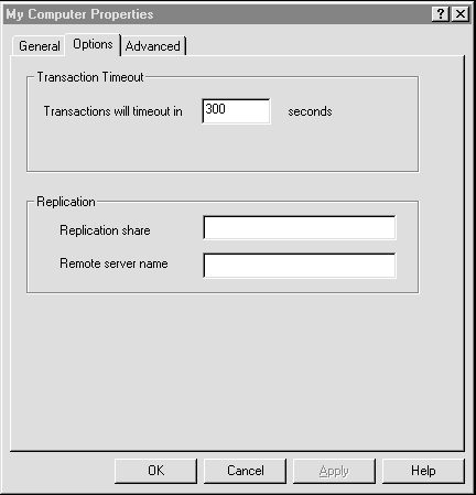

Increasing the Transaction Timeout Parameter
If your transaction requests are timing out before completing, it may be because the transaction timeout parameter is set too low. Increase the transaction timeout parameter to ensure that your transactions have sufficient time to complete.
To increase the transaction timeout parameter:
  1. Go to the computer on which Microsoft Transaction Server is installed and the Oracle Service for MTS is configured.
  2. Choose Start > Programs > Windows NT 4.0 Option Pack > Microsoft Transaction Server > Transaction Server Explorer.
    The Microsoft Management Console appears.
  3. Double-click Console Root in the Microsoft Management Console Explorer window.
  4. Double-click Microsoft Transaction Server.
  5. Double-click Computers.
  6. Right-click My Computer.
    A menu appears with several options.
  7. Choose Properties.
    The My Computer Properties dialog box appears.
  8. Choose the Options tab.
  9. Enter a value in the Transaction Timeout field and click OK:
    The transaction timeout value is increased. For most environments, 60 seconds may be sufficient. However, if your transaction is competing with numerous concurrent transactions, this value may be too low.
