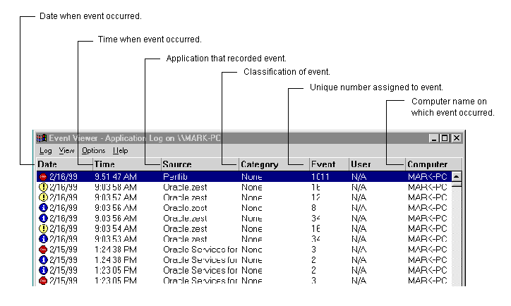

Using the Event Viewer
Oracle Service for MTS problems and other significant occurrences are recorded as events. These events are recorded in an application event log. View and manage these recorded events in the Event Viewer. The types of events displayed include:
Accessing the Event Viewer
To access the Event Viewer:
  1. Choose Start > Programs > Administrative Tools > Event Viewer.
    The Event Viewer window appears.
  2. Choose Application from the Log menu.
    The Application view displays the following information:
Reading the Event Viewer
The icons beside each event determine the type of event:
Icon  Event Type  Description
red (stop sign)
Error
Indicates an error. Always check these icons.
blue (informational)
Information
Indicates a non-critical system event. You can ignore these icons unless you want to track a specific event.
yellow (exclamation point)
Warning
Indicates a special event, such as the termination of an instance or the shutdown of services. Investigate these icons, but they are usually non-critical.
The Oracle Service for MTS events display with a source of Oracle Service for MTS. Oracle Service for MTS consists of the following event IDs:

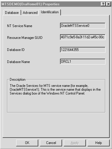

Viewing Oracle Service for MTS Configuration Information
The Oracle Manager for MTS Services snap-in includes an Identification tab in the Oracle Service for MTS Properties dialog box that enables you to view information that can be useful when debugging problems with Oracle Support Services. Note that none of the information in the Identification tab can be changed.
To view configuration information:
  1. Go to the computer from which to modify the Oracle Service for MTS. The Oracle Service for MTS can be running on this computer or on a remote computer that you can access from this computer.
  2. Choose Start > Programs > Oracle - HOME_NAME > Application Development > Oracle Manager for Microsoft Transaction Server.
    The Microsoft Management Console appears.
  3. Find the Oracle Service for MTS to modify in the Explorer window.
  4. Right-click the Oracle Service for MTS icon to modify.
    A menu appears with several options:
  5. Choose Stop Service.
    A message indicates that the Oracle Service for MTS has stopped.
  6. Right-click the same Oracle Service for MTS icon again.
    A menu appears with several options.
  7. Choose Properties.
    The Properties dialog box appears.
  8. Click the Identification tab.
  9. View the following information:
    Field  Description
    NT Service Name
    Displays the Oracle Service for MTS service name (for example, OracleMTSService0). This is the service name that displays in the Services dialog box of the Windows NT Control Panel.
    Resource Manager GUID
    Displays the resource manager global unique identifier (GUID) for identifying an Oracle8 database and its associated Oracle Service for MTS to MS DTC.
    Database ID
    Displays a value unique to each Oracle8 database. The Oracle Service for MTS retrieves this value from the database and sets it the first time it ever connects to that database.
    Database Name
    Displays the Oracle8 database name (as identified by the DB_NAME INIT.ORA file parameter value). The Oracle Service for MTS retrieves this value from the database and sets it the first time it connects to that database.

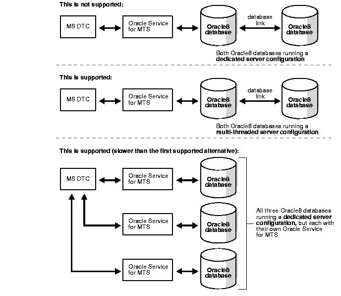

Question: How do I design an application when I have multiple Oracle8 databases?
Oracle Service for MTS does not support the use of database links between Oracle8 databases running in dedicated server configurations. As alternatives, the Oracle Service for MTS supports using database links in a multi-threaded server environment or providing each Oracle8 database with its own Oracle Service for MTS in a dedicated server environment. This figure illustrates these alternatives:
Question: What are the differences between Oracle's Net8 connection pooling, OCI connection pooling, and Microsoft Transaction Server connection pooling?
Net8 connection pooling is a server-side feature that is implemented only if your Oracle8 database is configured for multi-threaded server support. Net8 connection pooling enables you to minimize the number of physical network connections to a multi-threaded server. This is achieved by sharing a dispatcher's set of connections among multiple client processes.
OCI connection pooling is a client-side feature that allows for the caching of Net8 connections to Oracle8 databases. It also allows for the multiplexing of multiple sessions to an Oracle8 database over a single Net8 connection. This second feature is not supported in ORAMTS.DLL for this release because of potential deadlock issues.
Microsoft Transaction Server connection pooling maintains a pool of Net8 connections and only uses one OCI session per Net8 connection.
