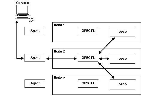

On UNIX, Oracle Intelligent Agent invokes OPSCTL to executes jobs. OPSD then receives requests from OPSCTL, as shown in Figure 6-1:

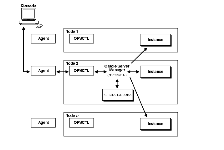

On Windows NT, Oracle Intelligent Agent invokes OPSCTL to executes jobs. OPSCTL then sends requests to Oracle Server Manager. Oracle Server Manager uses information from configured tnsnames.ora
files on the nodes to connect to a listener which sends the OPSCTL requested action to the instance. Therefore, it is essential to have the tnsnames.ora
file configured on all nodes in the cluster.
Figure 6-2 shows how OPSCTL operates between the agent and the nodes on Windows NT:

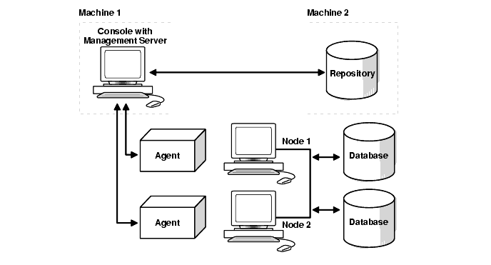

You can run the individual Oracle Enterprise Manager components on separate machines or combine different components on separate machines to collaboratively manage the complete Oracle environment. Two environments are shown below:
The Console, with the aid of the Management Server, remotely manages the databases for both nodes. The Console and the Management Server are running on a Windows NT or Solaris machine with an Oracle8i database installed that is only used as a repository. Oracle Intelligent Agent does not need to be running.
The nodes share an Oracle8i database. The repository is not created in this database, and Oracle Intelligent Agent is running on both nodes.

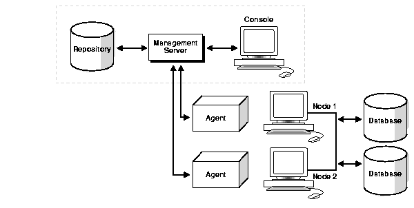

The Repository is on a separate Windows NT or Solaris machine with an Oracle8i database installed that is only being used as a repository. Oracle Intelligent Agent does not need to be running.
The Management Server remotely manages the databases for the Console on a Windows NT machine. The Console is running on a Windows NT, Windows 95 or Windows 98 machine.
The nodes run an Oracle8i database. The repository is not created in this database, and Oracle Intelligent Agent is running on both nodes.

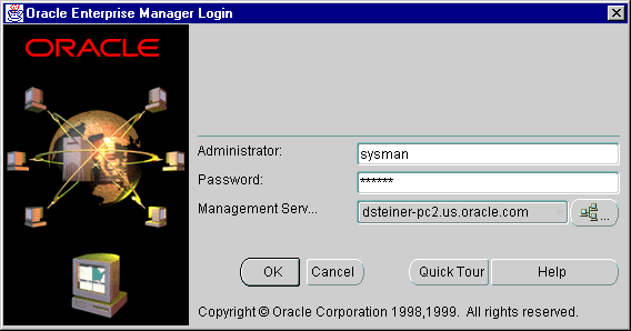

To start the Enterprise Manager Console:
oemapp console
The command string is case-sensitive and you must enter it with lowercase characters.
On Windows NT, you can also choose Start > Programs > Oracle - HOME_NAME > Oracle Enterprise Management > Oracle Enterprise Manager Console.
Administrator = sysman
Password = oem_temp
If the name of the Management Server you want to use does not appear, perform these procedures:
The new password you enter is the password you use to log in to the Console for subsequent logins.

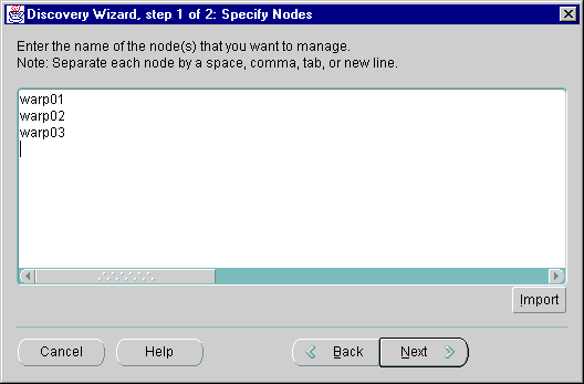

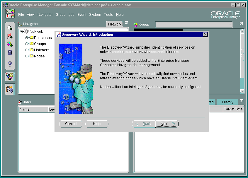

After the Console has been started, discover network services, such as databases, listeners, and nodes, to populate the Navigator tree.
To discover services:
The Specify Nodes page appears:

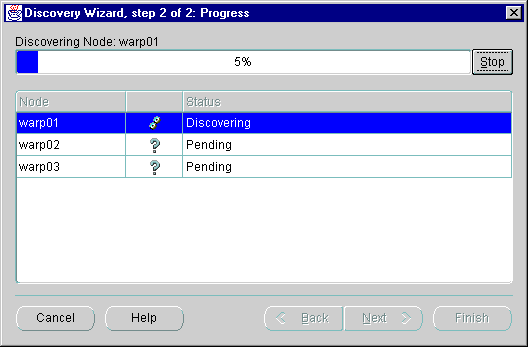

The Progress page appears with the discovery status:

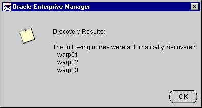

Successful discovery results in the following:
The following confirmation dialog box appears:
Note: An unsuccessful discovery is usually the result of the Oracle Intelligent Agent not being started on the node. See "Resolving Service Discovery Failures". |

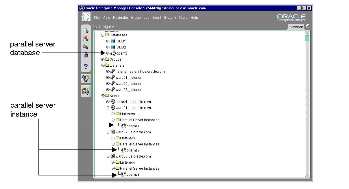

Once a node is identified, Oracle Enterprise Manager automatically discovers (locates) all the databases and other services running on the managed nodes. When a node is discovered, the services located are:
When an Oracle Parallel Server instance is discovered, a new folder named Parallel Server Instances is created for the node it belongs to.
By expanding and contracting the folders in the Navigator window, you can see the object discovered.
The following graphic shows an Oracle Parallel Server database named opsmz
with instance opsmz1
on host warp01.us.oracle.com
, instance opsmz2
on host warp02.us.oracle.com
, and instance opsmz3
on host warp03.us.oracle.com

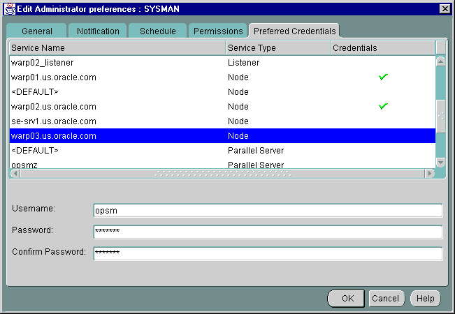

You must configure the Oracle Enterprise Manager with preferred user credentials so you can perform certain functions. Oracle Enterprise Manager uses these credentials when establishing connections to Oracle Parallel Server, such as when the Oracle Parallel Server is expanded in the Console's navigator. Startup and shutdown operations also use the credentials.
The credentials you configure must identify a valid DBA user with SYSDBA or SYSOPER privileges for the Oracle Parallel Server database on the target node. This enables you to expand the Oracle Parallel Server database folder in the Navigator window and to perform connection and job execution operations. If you do not identify a valid database user, Oracle Enterprise Manager prompts you for this information each time you attempt to connect to the database.
Likewise, you must identify an operating system user to run jobs on particular nodes, such as starting or stopping an instance. Although you submit a job from the Console, the job scripts themselves reside on the Oracle Intelligent Agent on the nodes. For this reason, you must configure a user that has operating system access to the node.

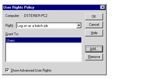

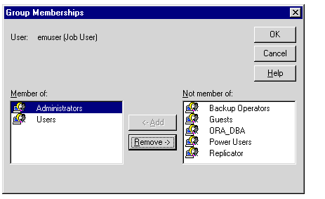

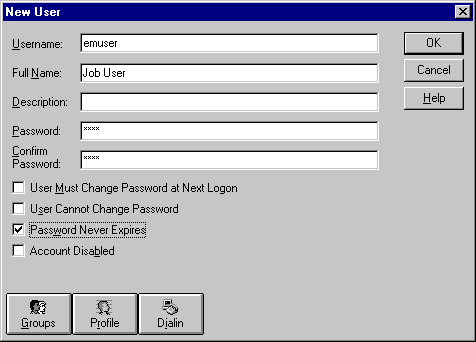

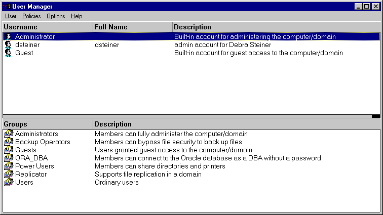

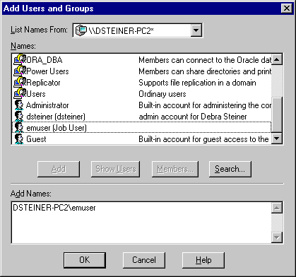

On Windows NT, you must create a Windows NT user account using the next procedure. To create a user account on each node of the cluster:
The User Manager window appears:
The New User dialog box appears:
The Group Memberships dialog box appears:
The user is added and the User Manager window re-appears.
The User Rights Policy dialog box appears:

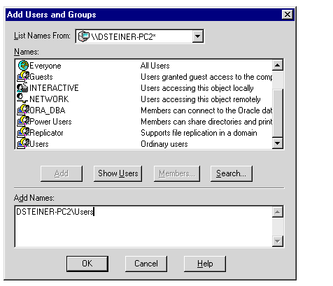

If the user is not listed, create it. To do this:
The Add Users and Groups dialog box appears:
The new user name appears in the Add Names list box.
The user appears in the Grant To list box in the User Rights Policy dialog box.
Identify a current user, such as SYSTEM, or create a new user that is to be used to connect, start, and stop the database.
Once a user is identified, ensure it has SYSDBA or SYSOPER privileges. SYSDBA and SYSOPER privileges contain all the system privileges you need to manage the database.
To grant SYSDBA or SYSOPER privileges to a user, use the GRANT command:
SQL> GRANT sysdba to username; SQL> GRANT sysoper to username;
You must set user credentials for the database and each node.
To set credentials:
The Edit User Preferences dialog box appears.

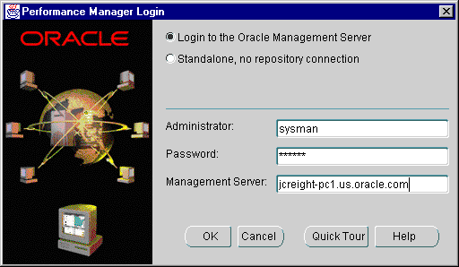

The Performance Manager Login dialog box appears:
Select whether to log on to the Management Server or to log on in standalone mode. If "Login to Oracle Management Server" is chosen, additionally enter the Oracle Enterprise Manager administrator user name, password and location of the Management Server.

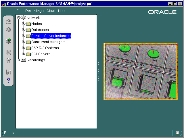

The Oracle Performance Manager starts:

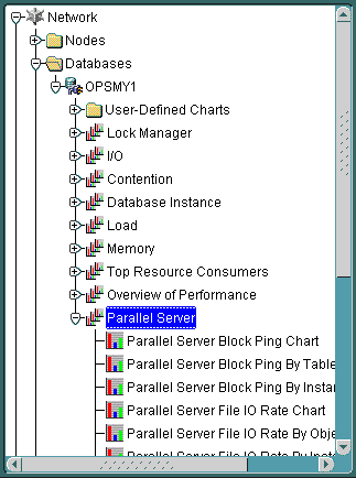

You can access Oracle Parallel Server charts from the Parallel Server Instance folder or from the Databases folder.
If the log in occurred from the Console or the "Login to the Oracle Management Server" option was selected in the Performance Manager Login dialog box, you can expand the Parallel Server Instances folder to display the instances from which the list of available charts may be obtained:.
Once you expand the Parallel Server Instances folder, expand User Defined Charts > Parallel Server.

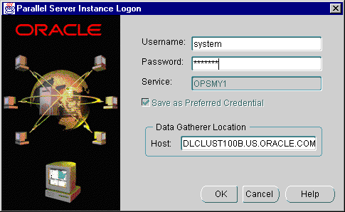

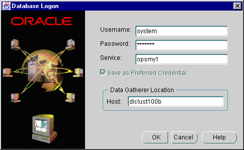

If you did not specify credentials for the instances, as described in "Task 4: Specify Preferred Credentials for Nodes and Oracle Parallel Server Database", the Parallel Server Instances Logon dialog appears when you attempt to expand an instance:
Enter a database user and password. The Oracle Database Gatherer location is automatically specified.
If the log in occurred in standalone mode or if you selected the "Standalone, no repository connection" option in the Performance Manager Login dialog box you can access the Oracle Parallel Server charts from the Databases folder:
The Database Logon dialog prompts you for the required Oracle database credentials:
