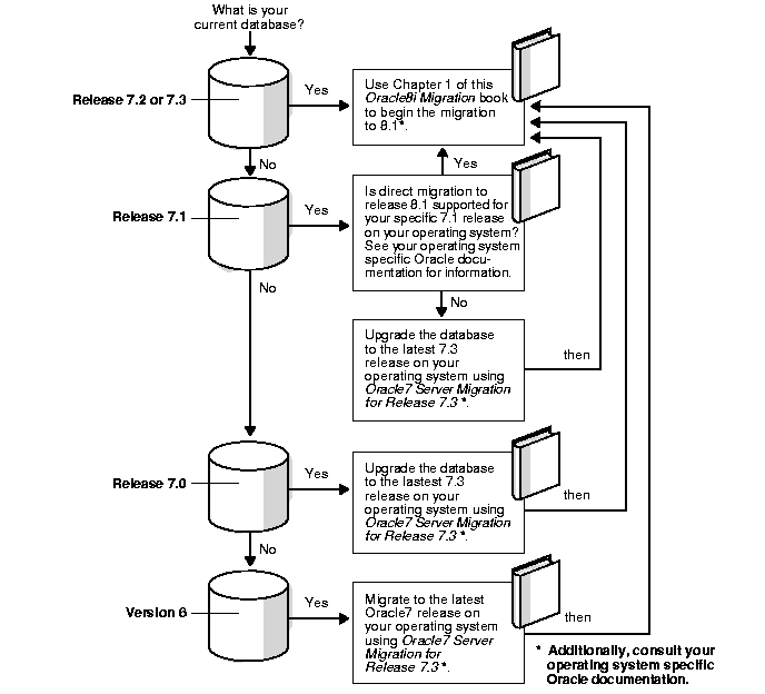

Figure 5-1 is a roadmap that specifies the documentation you should use to migrate your database to release 8.1 based on your current release of Oracle.

A version 6 database must be migrated to at least Oracle7 before it can be migrated to Oracle8i. Also, the Oracle Data Migration Assistant cannot migrate some Oracle7 releases. See your operating system-specific Oracle documentation for information about the earliest release that is supported by the Oracle Data Migration Assistant on your operating system.
In general, the Migration utility supports migrations of the last 7.1 release and higher databases on your operating system. The exact maintenance release number of the last 7.1 release varies from operating system to operating system.
For example, on some operating systems, the Oracle Data Migration Assistant can migrate only release 7.1.4 and later databases, and cannot migrate a release lower than release 7.1.4 (such as release 7.0 or release 7.1.3). If your database release number is lower than the release supported by the Oracle Data Migration Assistant on your operating system, then upgrade or migrate the database to the required release.
