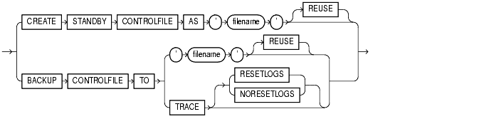

controlfile_clauses::=

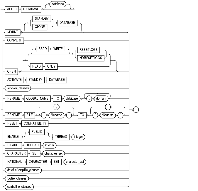

Keywords and Parameters
database
identifies the database to be altered. The database name can contain only ASCII characters. If you omit database, Oracle alters the database identified by the value of the initialization parameter DB_NAME. You can alter only the database whose control files are specified by the initialization parameter CONTROL_FILES. The database identifier is not related to the Net8 database specification.
You can use the following clauses only when the database is not mounted by your instance:
MOUNT
mounts the database.
STANDBY DATABASE
mounts the standby database.
See Also: Oracle8i Standby Database Concepts and Administration.
CLONE DATABASE
mounts the clone database.
See Also: Oracle8i Backup and Recovery Guide.
CONVERT
completes the conversion of the Oracle7 data dictionary. After you use this clause, the Oracle7 data dictionary no longer exists in the Oracle database. Use this clause only when you are migrating to Oracle8i.
See Also: Oracle8i Migration.
ACTIVATE STANDBY DATABASE
changes the state of a standby database to an active database.
OPEN
opens the database, making it available for normal use. You must mount the database before you can open it. You must activate a standby database before you can open it.
READ ONLY
restricts users to read-only transactions, preventing them from generating redo logs. You can use this clause to make a standby database available for queries even while archive logs are being copied from the primary database site.
Restrictions:
  • You cannot open a database READ ONLY if it is currently opened READ WRITE by another instance.
  • You cannot open a database READ ONLY if it requires recovery.
  • You cannot take tablespaces offline while the database is open READ ONLY. However, you can take datafiles offline and online, and you can recover offline datafiles and tablespaces while the database is open READ ONLY.
READ WRITE
opens the database in read-write mode, allowing users to generate redo logs. This is the default.
RESETLOGS
resets the current log sequence number to 1 and discards any redo information that was not applied during recovery, ensuring that it will never be applied. This effectively discards all changes that are in the redo log, but not in the database.
You must specify RESETLOGS to open the database after performing media recovery with an incomplete recovery using the RECOVER clause or with a backup control file. After opening the database with this clause, you should perform a complete database backup.
NORESETLOGS
leaves the log sequence number and redo log files in their current state.
Restriction: You can specify RESETLOGS and NORESETLOGS only after performing incomplete media recovery or complete media recovery with a backup control file. In any other case, Oracle uses the NORESETLOGS automatically.

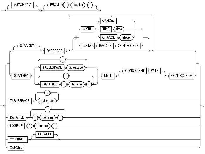

You can use any of the following clauses when your instance has the database mounted, open or closed, and the files involved are not in use:
general_recovery_clause
lets you design media recovery for the database or standby database, or for specified tablespaces or files.
See Also: Oracle8i Backup and Recovery Guide for more information on media recovery.
Note: If you do not have special media requirements, Oracle Corporation recommends that you use the SQL*Plus RECOVER statement.
See Also: SQL*Plus User's Guide and Reference.
Restrictions:
  • You can recover the entire database only when the database is closed.
  • Your instance must have the database mounted in exclusive mode.
  • You can recover tablespaces or datafiles when the database is open or closed, provided that the tablespaces or datafiles to be recovered are offline.
  • You cannot perform media recovery if you are connected to Oracle through the multi-threaded server architecture.
AUTOMATIC
automatically generates the name of the next archived redo log file needed to continue the recovery operation. If the LOG_ARCHIVE_DEST_n parameters are defined, Oracle scans those that are valid and enabled for the first local destination. It uses that destination in conjunction with LOG_ARCHIVE_FORMAT to generate the target redo log filename. If the LOG_ARCHIVE_DEST_n parameters are not defined, Oracle uses the value of the LOG_ARCHIVE_DEST parameter instead.
If the resulting file is found, Oracle applies the redo contained in that file. If the file is not found, Oracle prompts you for a filename, displaying the generated filename as a suggestion.
If you specify neither AUTOMATIC nor LOGFILE, Oracle prompts you for a filename, displaying the generated filename as a suggestion. You can then accept the generated filename or replace it with a fully qualified filename. If you know the archived filename differs from what Oracle would generate, you can save time by using the LOGFILE clause.
FROM 'location'
specifies the location from which the archived redo log file group is read. The value of location must be a fully specified file location following the conventions of your operating system. If you omit this parameter, Oracle assumes the archived redo log file group is in the location specified by the initialization parameter LOG_ARCHIVE_DEST or LOG_ARCHIVE_DEST_1.
STANDBY DATABASE
recovers the standby database using the control file and archived redo log files copied from the primary database. The standby database must be mounted but not open.
DATABASE
recovers the entire database. This is the default. You can use this clause only when the database is closed.
Note: This clause recovers only online datafiles.
UNTIL
specifies the duration of the recovery operation.
  • CANCEL performs cancel-based recovery. This clause recovers the database until you issue the ALTER DATABASE RECOVER statement with the RECOVER CANCEL clause.
  • TIME performs time-based recovery. This parameter recovers the database to the time specified by the date. The date must be a character literal in the format 'YYYY-MM-DD:HH24:MI:SS'.
  • CHANGE performs change-based recovery. This parameter recovers the database to a transaction-consistent state immediately before the system change number (SCN) specified by integer.
USING BACKUP CONTROLFILE
specifies that a backup control file is being used instead of the current control file.
TABLESPACE
recovers only the specified tablespaces. You can use this clause if the database is open or closed, provided the tablespaces to be recovered are offline.
DATAFILE
recovers the specified datafiles. You can use this clause when the database is open or closed, provided the datafiles to be recovered are offline.
STANDBY TABLESPACE | DATAFILE
reconstructs a lost or damaged datafile or tablespace in the standby database using archived redo log files copied from the primary database and a control file.
UNTIL [CONSISTENT WITH] CONTROLFILE
specifies that the recovery of an old standby datafile or tablespace uses the current standby database control file. However, any redo in advance of the standby controlfile will not be applied. The keywords CONSISTENT WITH are optional and are provided for semantic clarity.
LOGFILE
continues media recovery by applying the specified redo log file.
CONTINUE
continues multi-instance recovery after it has been interrupted to disable a thread.
CONTINUE DEFAULT
continues recovery using the redo log file that Oracle would automatically generate if no other logfile were specified. This clause is equivalent to specifying AUTOMATIC, except that Oracle does not prompt for a filename.
CANCEL
terminates cancel-based recovery.
managed_recovery_clause
specifies automated standby recovery mode. This mode assumes that the automated standby database is an active component of an overall standby database architecture. A primary database actively archives its redo log files to the standby site. As these archived redo logs arrive at the standby site, they become available for use by a managed standby recovery operation. Automated standby recovery is restricted to media recovery.
See Also: Oracle8i Backup and Recovery Guide for more information on the parameters of this clause.
Restrictions: The same restrictions apply as are listed under general_recovery_clause.

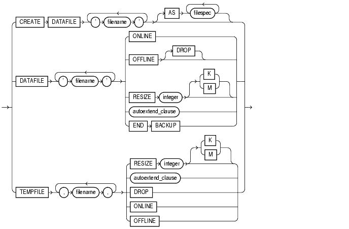

datafile/tempfile_clauses
let you modify datafiles and tempfiles.
CREATE DATAFILE
creates a new empty datafile in place of an old one. You can use this clause to re-create a datafile that was lost with no backup. The 'filename' must identify a file that is or was once part of the database. The filespec specifies the name and size of the new datafile. If you omit the AS clause, Oracle creates the new file with the name and size as the file specified by 'filename'.
During recovery, all archived redo logs written to since the original datafile was created must be applied to the new, empty version of the lost datafile.
Oracle creates the new file in the same state as the old file when it was created. You must perform media recovery on the new file to return it to the state of the old file at the time it was lost.
Restriction: You cannot create a new file based on the first datafile of the SYSTEM tablespace.
DATAFILE
affects your database files as follows:
ONLINE
brings the datafile online.
OFFLINE
takes the datafile offline. If the database is open, you must perform media recovery on the datafile before bringing it back online, because a checkpoint is not performed on the datafile before it is taken offline.
DROP takes a datafile offline when the database is in NOARCHIVELOG mode.
RESIZE
attempts to increase or decrease the size of the datafile to the specified absolute size in bytes. Use K or M to specify this size in kilobytes or megabytes. There is no default, so you must specify a size.
If sufficient disk space is not available for the increased size, or if the file contains data beyond the specified decreased size, Oracle returns an error.

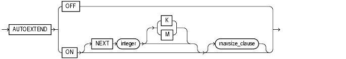

autoextend_clause
enables or disables the automatic extension of a datafile. If you do not specify this clause, datafiles are not automatically extended.
OFF disables autoextend if it is turned on. NEXT and MAXSIZE are set to zero. Values for NEXT and MAXSIZE must be respecified in further ALTER DATABASE AUTOEXTEND statements.
ON enables autoextend.
NEXT specifies in bytes the size of the next increment of disk space to be automatically allocated to the datafile when more extents are required. Use K or M to specify this size in kilobytes or megabytes. The default is one data block.
MAXSIZE specifies the maximum disk space allowed for automatic extension of the datafile.
UNLIMITED sets no limit on allocating disk space to the datafile.
END BACKUP
avoids media recovery on database startup after an online tablespace backup was interrupted by a system failure or instance failure or SHUTDOWN ABORT.
WARNING: Do not use ALTER TABLESPACE ... END BACKUP if you have restored any of the files affected from a backup. Media recovery is fully described in Oracle8i Backup and Recovery Guide.
TEMPFILE
Lets you resize your temporary datafile or specify the autoextend_clause, with the same effect as with a permanent datafile.
Restriction: You cannot specify TEMPFILE unless the database is open.
DROP
drops tempfile from the database. The tablespace remains.

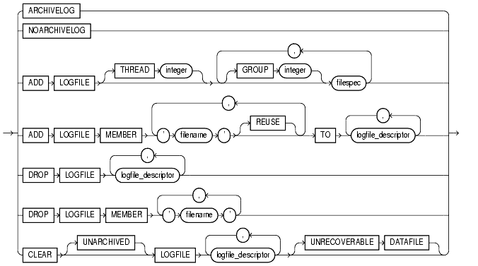

logfile_clauses
lets you add, drop, or modify log files.
ARCHIVELOG
specifies that the contents of a redo log file group must be archived before the group can be reused. This mode prepares for the possibility of media recovery. Use this clause only after shutting down your instance normally or immediately with no errors and then restarting it, mounting the database in parallel server disabled mode.
NOARCHIVELOG
specifies that the contents of a redo log file group need not be archived so that the group can be reused. This mode does not prepare for recovery after media failure.
Use the ARCHIVELOG clause and NOARCHIVELOG clause only if your instance has the database mounted in parallel server disabled mode, but not open.
ADD LOGFILE
adds one or more redo log file groups to the specified thread, making them available to the instance assigned the thread.
THREAD integer
is applicable only if you are using Oracle with the Parallel Server option in parallel mode. integer is the thread number. The number of threads you can create is limited by the value of the MAXINSTANCES parameter specified in the CREATE DATABASE statement.
If you omit THREAD, the redo log file group is added to the thread assigned to your instance.

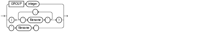

GROUP integer
uniquely identifies the redo log file group among all groups in all threads and can range from 1 to the MAXLOGFILES value. You cannot add multiple redo log file groups having the same GROUP value. If you omit this parameter, Oracle generates its value automatically. You can examine the GROUP value for a redo log file group through the dynamic performance view V$LOG.
filespec
Each filespec specifies a redo log file group containing one or more members, or copies. See the syntax description of filespec in "filespec".
ADD LOGFILE MEMBER
adds new members to existing redo log file groups. Each new member is specified by 'filename'. If the file already exists, it must be the same size as the other group members, and you must specify REUSE. If the file does not exist, Oracle creates a file of the correct size. You cannot add a member to a group if all of the group's members have been lost through media failure.
You can specify an existing redo log file group in one of these ways:
GROUP integer
Specify the value of the GROUP parameter that identifies the redo log file group.
list of filenames
List all members of the redo log file group. You must fully specify each filename according to the conventions of your operating system.
DROP LOGFILE
drops all members of a redo log file group. Specify a redo log file group as indicated for the ADD LOGFILE MEMBER clause.
  • To drop the current log file group, you must first issue an ALTER SYSTEM SWITCH LOGFILE statement. See "ALTER SYSTEM".
  • You cannot drop a redo log file group if it needs archiving.
  • You cannot drop a redo log file group if doing so would cause the redo thread to contain less than two redo log file groups.
DROP LOGFILE MEMBER
drops one or more redo log file members. Each 'filename' must fully specify a member using the conventions for filenames on your operating system.
  • To drop a log file in the current log, you must first issue an ALTER SYSTEM SWITCH LOGFILE statement. See "ALTER SYSTEM".
  • You cannot use this clause to drop all members of a redo log file group that contains valid data. To perform this operation, use the DROP LOGFILE clause.
CLEAR LOGFILE
reinitializes an online redo log, optionally without archiving the redo log. CLEAR LOGFILE is similar to adding and dropping a redo log, except that the statement may be issued even if there are only two logs for the thread and also may be issued for the current redo log of a closed thread.
UNARCHIVED
You must specify UNARCHIVED if you want to reuse a redo log that was not archived.
WARNING: Specifying UNARCHIVED makes backups unusable if the redo log is needed for recovery.
Do not use CLEAR LOGFILE to clear a log needed for media recovery. If it is necessary to clear a log containing redo after the database checkpoint, you must first perform incomplete media recovery. The current redo log of an open thread can be cleared. The current log of a closed thread can be cleared by switching logs in the closed thread.
If the CLEAR LOGFILE statement is interrupted by a system or instance failure, then the database may hang. If this occurs, reissue the statement after the database is restarted. If the failure occurred because of I/O errors accessing one member of a log group, then that member can be dropped and other members added.
UNRECOVERABLE DATAFILE
You must specify UNRECOVERABLE DATAFILE if you have taken the datafile offline with the database in ARCHIVELOG mode (that is, you specified ALTER DATABSE ... DATAFILE OFFLINE without the DROP keyword), and if the unarchived log to be cleared is needed to recover the datafile before bringing it back online. In this case, you must drop the datafile and the entire tablespace once the CLEAR LOGFILE statement completes.
controlfile_clauses
CREATE STANDBY CONTROLFILE
creates a control file to be used to maintain a standby database. If the file already exists, you must specify REUSE.
BACKUP CONTROLFILE
backs up the current control file.
TO 'filename'
specifies the file to which the control file is backed up. You must fully specify the filename using the conventions for your operating system. If the specified file already exists, you must specify REUSE.
TO TRACE
writes SQL statements to the database's trace file rather than making a physical backup of the control file. The SQL statements can start up the database, re-create the control file, and recover and open the database appropriately, based on the created control file.
You can copy the statements from the trace file into a script file, edit the statements as necessary, and use the database if all copies of the control file are lost (or to change the size of the control file).
  • RESETLOGS specifies that the SQL statement written to the trace file for starting the database is ALTER DATABASE OPEN RESETLOGS.
  • NORESETLOGS specifies that the SQL statement written to the trace file for starting the database is ALTER DATABASE OPEN NORESETLOGS.

Database Recovery Examples
The following statement performs complete recovery of the entire database, letting Oracle generate the name of the next archived redo log file needed:
ALTER DATABASE
  RECOVER AUTOMATIC DATABASE;
The following statement explicitly names a redo log file for Oracle to apply:
ALTER DATABASE
    RECOVER LOGFILE 'diska:arch0006.arc';
The following statement performs time-based recovery of the database:
ALTER DATABASE
    RECOVER AUTOMATIC UNTIL TIME '1998-10-27:14:00:00';
Oracle recovers the database until 2:00 pm on October 27, 1998.
The following statement recovers the tablespace USER5:
ALTER DATABASE
    RECOVER TABLESPACE user5;
The following statement recovers the standby datafile /FINANCE/STBS_21.f, using the corresponding datafile in the original standby database, plus all relevant archived logs and the current standby database control file:
ALTER DATABASE
   RECOVER STANDBY DATAFILE '/finance/stbs_21.f'
   UNTIL CONTROLFILE;
Managed Standby Database Examples
The following statement recovers the standby database in automated standby recovery mode:
ALTER DATABASE
   RECOVER MANAGED STANDBY DATABASE;
The following statement puts the database in automated standby recovery mode. The managed recovery process will wait up to 60 minutes for the next archive log:
ALTER DATABASE
   RECOVER MANAGED STANDBY DATABASE TIMEOUT 60;
If each subsequent log arrives within 60 minutes of the last log, recovery continues indefinitely or until manually terminated.
The following statement terminates the managed recovery operation:
ALTER DATABASE
   RECOVER MANAGED STANDBY DATABASE CANCEL IMMEDIATE;
The managed recovery operation terminates before the next group of redo is read
from the current redo log file. Media recovery ends in the "middle" of applying redo
