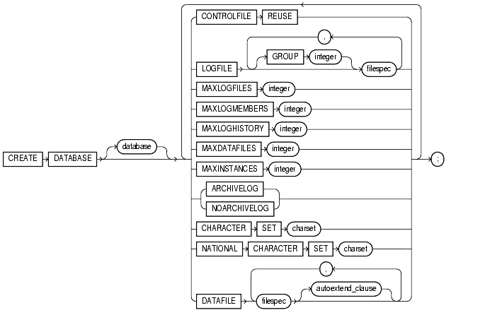

Keyword and Parameters
database
is the name of the database to be created and can be up to 8 bytes long. The database name can contain only ASCII characters. Oracle writes this name into the control file. If you subsequently issue an ALTER DATABASE statement that explicitly specifies a database name, Oracle verifies that name with the name in the control file. Database names should also adhere to the rules described in "Schema Object Naming Rules".
Note: You cannot use special characters from European or Asian character sets in a database name. For example, characters with umlauts are not allowed.
If you omit the database name from a CREATE DATABASE statement, Oracle uses the name specified by the initialization parameter DB_NAME. If the DB_NAME initialization parameter has been set, and you specify a different name from the value of that parameter, Oracle returns an error.
CONTROLFILE REUSE
reuses existing control files identified by the initialization parameter CONTROL_FILES, thus ignoring and overwriting any information they currently contain. Normally you use this clause only when you are re-creating a database, rather than creating one for the first time. You cannot use this clause if you also specify a parameter value that requires that the control file be larger than the existing files. These parameters are MAXLOGFILES, MAXLOGMEMBERS, MAXLOGHISTORY, MAXDATAFILES, and MAXINSTANCES.
If you omit this clause and any of the files specified by CONTROL_FILES already exist, Oracle returns an error.
LOGFILE
specifies one or more files to be used as redo log files. Each filespec specifies a redo log file group containing one or more redo log file members (copies). For the syntax of filespec, see "filespec". All redo log files specified in a CREATE DATABASE statement are added to redo log thread number 1.
GROUP integer
uniquely identifies a redo log file group and can range from 1 to the value of the MAXLOGFILES parameter. A database must have at least two redo log file groups. You cannot specify multiple redo log file groups having the same GROUP value. If you omit this parameter, Oracle generates its value automatically. You can examine the GROUP value for a redo log file group through the dynamic performance table V$LOG.
If you omit the LOGFILE clause, Oracle creates two redo log file groups by default. The names and sizes of the default files depend on your operating system.
MAXLOGFILES integer
specifies the maximum number of redo log file groups that can ever be created for the database. Oracle uses this value to determine how much space in the control file to allocate for the names of redo log files. The default, minimum, and maximum values depend on your operating system.
MAXLOGMEMBERS integer
specifies the maximum number of members, or copies, for a redo log file group. Oracle uses this value to determine how much space in the control file to allocate for the names of redo log files. The minimum value is 1. The maximum and default values depend on your operating system.
MAXLOGHISTORY integer
specifies the maximum number of archived redo log files for automatic media recovery with Oracle Parallel Server. Oracle uses this value to determine how much space in the control file to allocate for the names of archived redo log files. The minimum value is 0. The default value is a multiple of the MAXINSTANCES value and depends on your operating system. The maximum value is limited only by the maximum size of the control file.
Note: This parameter is useful only if you are using Oracle with the Parallel Server option in parallel mode, and archivelog mode enabled.
MAXDATAFILES integer
specifies the initial sizing of the datafiles section of the control file at CREATE DATABASE or CREATE CONTROLFILE time. An attempt to add a file whose number is greater than MAXDATAFILES, but less than or equal to DB_FILES, causes the Oracle control file to expand automatically so that the datafiles section can accommodate more files.
The number of datafiles accessible to your instance is also limited by the initialization parameter DB_FILES.
MAXINSTANCES integer
specifies the maximum number of instances that can simultaneously have this database mounted and open. This value takes precedence over the value of initialization parameter INSTANCES. The minimum value is 1. The maximum and default values depend on your operating system.
ARCHIVELOG
specifies that the contents of a redo log file group must be archived before the group can be reused. This clause prepares for the possibility of media recovery.
NOARCHIVELOG
specifies that the contents of a redo log file group need not be archived before the group can be reused. This clause does not allow for the possibility of media recovery.
The default is NOARCHIVELOG mode. After creating the database, you can change between ARCHIVELOG mode and NOARCHIVELOG mode with the ALTER DATABASE statement.
CHARACTER SET
specifies the character set the database uses to store data. The supported character sets and default value of this parameter depend on your operating system.
Restriction: You cannot specify any fixed-width multibyte character sets as the database character set.
See Also: Oracle8i National Language Support Guide for more information about character sets.
NATIONAL CHARACTER SET
specifies the national character set used to store data in columns specifically defined as NCHAR, NCLOB, or NVARCHAR2. If not specified, the national character set defaults to the database character set. See Oracle8i National Language Support Guide for valid character set names.
DATAFILE
specifies one or more files to be used as datafiles. See the syntax description of filespec in "filespec". All these files become part of the SYSTEM tablespace. If you omit this clause, Oracle creates one datafile by default. The name and size of this default file depend on your operating system.

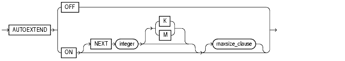

autoextend_clause
enables or disables the automatic extension of a datafile. If you do not specify this clause, datafiles are not automatically extended.
OFF
disables autoextend if it is turned on. NEXT and MAXSIZE are set to zero. Values for NEXT and MAXSIZE must be respecified in ALTER DATABASE AUTOEXTEND or ALTER TABLESPACE AUTOEXTEND statements.
ON
enables autoextend.

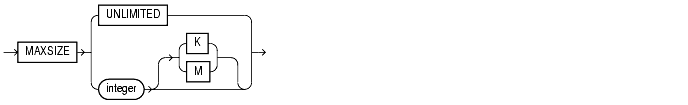

MAXSIZE
specifies the maximum disk space allowed for automatic extension of the datafile.
UNLIMITED
sets no limit on the allocation of disk space to the datafile.

The following statement creates a small database using defaults for all arguments:
CREATE DATABASE;
The following statement creates a database and fully specifies each argument:
CREATE DATABASE newtest
CONTROLFILE REUSE
LOGFILE
   GROUP 1 ('diskb:log1.log', 'diskc:log1.log') SIZE 50K,
   GROUP 2 ('diskb:log2.log', 'diskc:log2.log') SIZE 50K
MAXLOGFILES 5
MAXLOGHISTORY 100
DATAFILE 'diska:dbone.dat' SIZE 2M
MAXDATAFILES 10
MAXINSTANCES 2
ARCHIVELOG
CHARACTER SET US7ASCII
NATIONAL CHARACTER SET JA16SJISFIXED
DATAFILE
'disk1:df1.dbf' AUTOEXTEND ON
'disk2:df2.dbf' AUTOEXTEND ON NEXT 10M MAXSIZE UNLIMITED;
