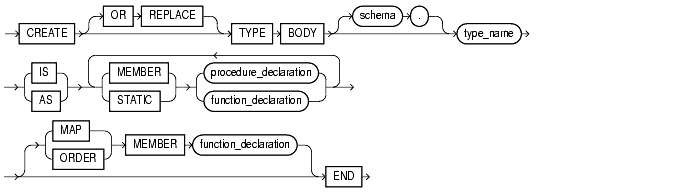

C_declaration::=
To define or implement the member methods defined in the object type specification. You create object types with the CREATE
TYPE
and the CREATE
TYPE BODY
statements. The CREATE
TYPE
statement specifies the name of the object type, its attributes, methods, and other properties. The CREATE
TYPE
BODY
statement contains the code for the methods in the type.
For each method specified in an object type specification for which you did not specify the call_spec, you must specify a corresponding method body in the object type body.
For information on creating and modifying a type specification, see "CREATE TYPE" and "ALTER TYPE".

re-creates the type body if it already exists. Use this clause to change the definition of an existing type body without first dropping it. |
Users previously granted privileges on the re-created object type body can use and reference the object type body without being granted privileges again. |
You can use this clause to add new member subprogram definitions to specifications added with the |
schema |
is the schema to contain the type body. If you omit schema, Oracle creates the type body in your current schema. |
type_name |
is the name of an object type. |
declares or implements a method function or procedure subprogram associated with the object type specification. For a description of the difference between member and static methods, see "CREATE TYPE". For information about overloading subprogram names within a package, see PL/SQL User's Guide and Reference. |
You must define a corresponding method name, optional parameter list, and (for functions) a return type in the object type specification for each procedure or function declaration. |
procedure_declaration |
is the declaration of a procedure subprogram. |
function_declaration |
is the declaration of a function subprogram. |
