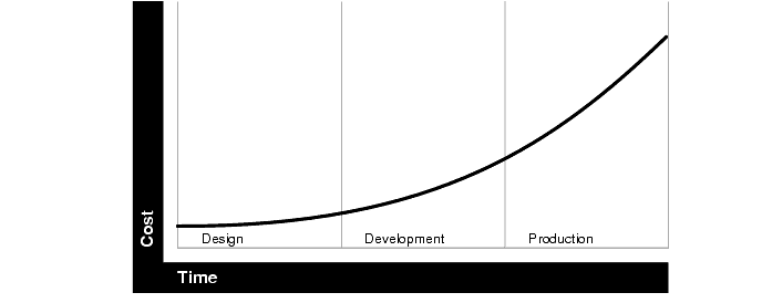

By designing a system to perform well, you can minimize its implementation and on-going administration cost. Figure 2-1 illustrates the relative cost of tuning during the life of an application.

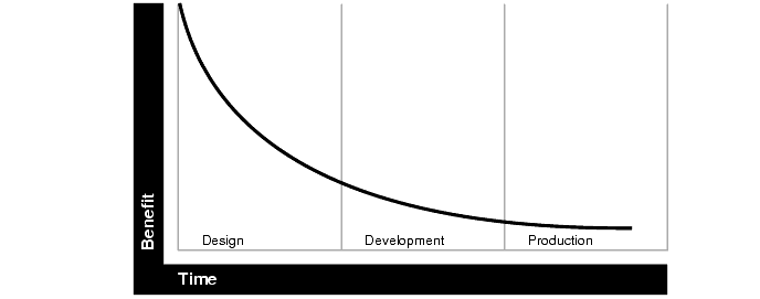

To complement this view, Figure 2-2 shows that the relative benefit of tuning an application over the course of its life is inversely proportional to the cost expended.
The most effective time to tune is during the design phase: you get the maximum benefit for the lowest cost.

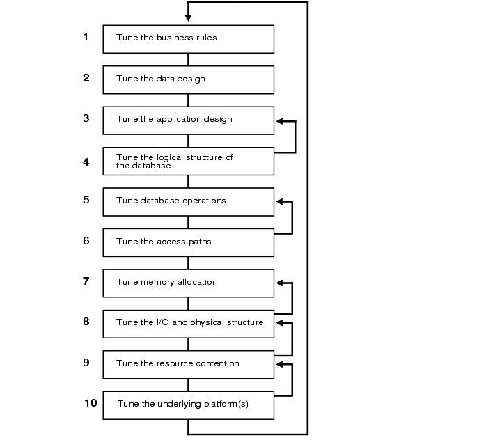

The following steps provide a recommended method for tuning an Oracle database. These steps are prioritized in order of diminishing returns: steps with the greatest effect on performance appear first. For optimal results, therefore, resolve tuning issues in the order listed, from the design and development phases through instance tuning.
Step 1: Tune the Business Rules
Step 3: Tune the Application Design
Step 4: Tune the Logical Structure of the Database
Step 5: Tune Database Operations
Step 7: Tune Memory Allocation
Step 8: Tune I/O and Physical Structure
Step 9: Tune Resource Contention
Step 10: Tune the Underlying Platform(s)
After completing these steps, reassess your database performance, and decide whether further tuning is necessary.
Tuning is an iterative process. Performance gains made in later steps may pave the way for further improvements in earlier steps, so additional passes through the tuning process may be useful.
Figure 2-3 illustrates the tuning method:
Decisions you make in one step may influence subsequent steps. For example, in step 5 you may rewrite some of your SQL statements. These SQL statements may have significant bearing on parsing and caching issues addressed in step 7. Also, disk I/O, which is tuned in step 8, depends on the size of the buffer cache, which is tuned in step 7. Although the figure shows a loop back to step 1, you may need to return from any step to any previous step.
