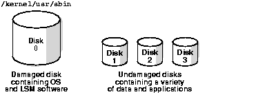

When a disk with the operating system and LSM binaries has been damaged or completely destroyed, you need to replace the damaged disk and reinstall both the operating system and the LSM software. If the disk was not completely destroyed and the operating system or LSM is still operational, use only those steps in this section that apply to your situation.
Use the following steps to guide you through recovering the operating system and LSM software:
disk information
command to make a filesystem for each raw partition that you plan to recover, then mount the block partition. (LSM does not initialize or create filesystems; it recovers data into existing filesystems.)
newfs
or mkfs
. For AIX systems, use SMIT
. For HP-UX systems, use mkfs
You need to fully configure the operating system by recreating any unique configurations that existed before you lost data or experienced a disk crash. If you use a device with a default configuration that is not directly supported by the operating system, you also need to modify the appropriate device configuration files during installation:

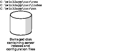

If you lost the LSM indexes and resource configuration files that reside in the /nsr directory, you will need to follow the instructions in the next section to recover them.
If the LSM Server indexes and configuration files that reside in the /nsr directory have been destroyed, you will need to use the mmrecov
command to recover them.
If the operating system and LSM software were also destroyed, they must be reinstalled prior to recovering the /nsr directory contents. See "Recovering the Operating System and LSM Software".
When you use the mmrecov
command to recover the /nsr directory, you actually recover the contents of three important directories:
mmrecov
recovers the /nsr/res directory as /nsr/res.R. Later, you must change the directory name to /nsr/res.
The mmrecov
command asks you for the bootstrap save set identification number (ssid). If you followed the recommended procedures to prepare for loss of critical data, you have a copy of the bootstrap file as a hardcopy printout with the name of the backup media you need and the bootstrap save set ID (ssid).
In the following example, ssid "17851237" is the most recent bootstrap backup:
Jun 17 22:21 1997 mars's LSM bootstrap information date time level ssid file record volume 6/14/97 23:46:13 full 17826163 48 0 mars.1 6/15/97 22:45:15 9 17836325 87 0 mars.2 6/16/97 22:50:34 9 17846505 134 0 mars.2 6/17/97 22:20:25 9 17851237 52 0 mars.3
If you do not have this information, you can still recover the indexes by finding the ssid using the scanner -B
command. See "Bootstrap Save Set ID".
After you locate the bootstrap with the most recent date on your UNIX system, you can run the mmrecov
command, supplying the save set ID and file number displayed by the scanner
command, to recover the LSM Server indexes and resource configuration.
With the operating system and LSM software in place, recover the indexes and configuration files from the backup media by following these steps:
mmrecov
command to extract the contents of the bootstrap backup. (Never run the mmrecov
command from the root directory (/); you can use any other directory.) For example:
# mmrecov Doing mmrecov operation as root on the server !!! mmrecov: Using mars as server NOTICE: mmrecov is used to recover the NetWorker server's on-line file and media indexes from media (backup tapes or disks) when either of the server's on-line file or media index has been lost or damaged. Note that this command will OVERWRITE the server's existing on-line file and media indexes. mmrecov is not used to recover NetWorker clients' on-line indexes; normal recover procedures may be used for this purpose. See the mmrecov(8) and nsr_crash(8) man pages for more details. rd=mars:/space1/DISKDEV1 rd=mars:/space1/DISKDEV2 /space1/DISKDEV1 /space1/DISKDEV2 What is the name of the device you plan on using [rd=mars:/space1/DISKDEV1]? /space1/DISKDEV1 Enter the latest bootstrap save set id []: 17851237 Enter starting file number (if known) [0]: 52 Enter starting record number (if known) [0]: 0 Please insert the volume on which save set id 17851237 started into /space1/DISKDEV1. When you have done this, press <RETURN>: [Return] Scanning /space1/DISKDEV1 for save set 17851237; this may take a while... scanner: scanning optical disk TestBackup.199 on /space1/DISKDEV1 /nsr/res/nsr.res /nsr/res/nsrjb.res scanner: ssid 17851237: scan complete scanner: ssid 17851237: 44 KB, 11 file(s) /nsr/res/nsrla.res /nsr/res/ /nsr/mm/ /nsr/index/mars/ /nsr/index/ /nsr/ / nsrmmdbasm -r /nsr/mm/mmvolume/ nsrindexasm -r /nsr/index/mars/db/ /space1/DISKDEV1: mount operation in progress /space1/DISKDEV1: mounted optical disk TestBackup.199 (write protected) The bootstrap entry in the on-line index for mars has been recovered.The complete index is now being reconstructed from the various partial indexes which were saved during the normal save for this server. If your resource files were lost, they are now recovered in the 'res.R'directory. Copy or move them to the 'res' directory, after the index has been reconstructed and you have shut down the daemons. Then restart the daemons. Otherwise, just restart the daemons after the index has been reconstructed. 7 records recovered, 0 discarded. nsrindexasm: Pursuing index pieces of /nsr/index/mars/db from mars. Recovering files into their original locations. nsrindexasm -r ./mars/db/ merging with existing mars index mars: 2035 records recovered, 0 discarded. Received 1 matching file(s) from NSR server `mars' Recover completion time: Tue Jun 24 16:46:38 1997 Cross checking index for client mars to remove duplicate records The index for `mars' is now fully recovered.
You can use LSM commands such as nsrwatch
or nwadmin
to watch the progress of the LSM Server during the recovery of the index and configuration files. Open a new window (shell tool) to monitor the recovery so that the mmrecov
output does not display on top of the nsrwatch
output.
mars# nsrwatch Tue 16:36:11 server notice: started Tue 16:36:30 index notice: The client index is missing, recover the index or run nsrck -c Tue 16:36:30 index notice: completed checking 2 client(s) Tue 16:36:34 /space1/DISKDEV1 volume TestBackup.199 not found in media index Tue 16:45:21 /space1/DISKDEV1 mount operation in progress Tue 16:45:30 /space1/DISKDEV1 mounted optical disk TestBackup.199 (write protected) Tue 16:45:33 index notice: nsrim has finished cross checking the media db Tue 16:46:24 index notice: cross-checking index for mars Tue 16:46:30 /space1/DISKDEV1 mounted optical disk TestBackup.199 (write protected) Tue 16:46:31 mars:/nsr/index/mars (6/24/97) starting read from TestBackup.199 of 397 Tue 16:46:35 mars:/nsr/index/mars (6/24/97) done reading 397 KB Tue 16:46:38 index notice: cross-checking index for mars
Unlike the /nsr/index directory, the /nsr/res directory containing the configuration files cannot be reliably overwritten while LSM is running. Therefore, mmrecov
To complete the recovery of the LSM configuration files:
Complete these steps after mmrecov
has finished and this final message appears:
The on-line index for 'server' is now fully recovered.
nsr_shutdown
command:
# nsr_shutdown
# cd /nsr # mv res res.orig # mv res.R res
# nsrd # nsrexecd
# rm -r /nsr/res.orig

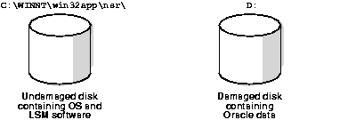

This section describes how to recover from a crash in which one or more files of an Oracle8 or Oracle8i database were damaged on your UNIX Oracle Server.
The first sign of a disk crash will usually be an I/O error. Oracle will usually document the I/O error in the trace file and in the alert log.
If only one database file is affected, your database may have encountered a bad spot on the disk. This can be circumvented by reformatting the disk to make a new list of bad blocks. However, this can be time-consuming, so it is prudent to have a spare disk available to swap in while you reformat.
If several database files are affected, all on the same disk, you could have a disk controller problem or a disk head crash. A bad controller can be replaced, and data on the disk will often be in perfect shape. But after a head crash, you will need to use that spare disk as a replacement.
Keep an extra disk on hand as a "hot spare," in case a disk failure occurs. Format it and verify that it works. If a disk failure does occur, it is much faster to swap in a spare disk than it is to rename database files and update the control file accordingly.
After you have determined the Oracle data that needs to be recovered, you must first restore the relevant files.
You can restore and recover the Oracle database files by using one of these programs:
For more information about the Oracle Enterprise Manager, see "Using the Oracle Enterprise Manager Backup Manager". For complete details about using RMAN, refer to Oracle's Backup and Recovery Guide.

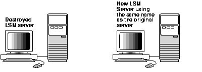

This section describes the situation where your original LSM machine is beyond repair, so you want to move LSM to a new machine. This procedure assumes that you are not updating the operating system or the LSM software.
If you want to make changes to the operating system or the LSM software, we strongly suggest that you configure the new machine exactly like the original, using the same version of the operating system and LSM software. After configuring the new machine, make sure the system is operational, perform a couple of successful backups, and then, update or upgrade the operating system or the LSM software, one at a time.
To move LSM to a new machine, use the same steps for recovering a primary disk and the LSM indexes and configuration files. See "Recovering the Operating System and LSM Software" and "Recovering LSM Indexes and Configuration Files" for complete information.
However, you should be aware of the following requirements for configuring the software:
After LSM is moved to another machine, you must recover the LSM resource database (nsr.res file) to have the same resource and attribute settings on your new machine as you had on the previous one.
After you successfully move your server, check the following:
savegrp -O
command to perform a manual bootstrap backup as soon as possible. See "Manual Bootstrap Backup" for more information.
With the operating system and LSM software in place, recover the indexes and configuration files from the backup media:
mmrecov
command to extract the contents of the bootstrap save set. For example:
mmrecov C:\win32app\nsr\bin>mmrecov mmrecov: Using mars.universe.com as server NOTICE: mmrecov is used to recover the LSM server's on-line file and media indexes from media (backup tapes or disks) when either of the server's on-line file or media index has been lost or damaged. Note that this command will OVERWRITE the server's existing on-line file and media indexes. mmrecov is not used to recover LSM clients' on-line indexes; normal recover procedures may be used for this purpose. Enter the latest bootstrap save set id []: 15132 Enter starting file number (if known) [0]: 9 Enter starting record number (if known) [0]: Please insert the volume on which save set id 15132 started into \\.\Tape0. When you have done this, press <RETURN>: Scanning \\.\Tape0 for save set 15132; this may take a while.. scanner: scanning 4mm tape mars.universe.com.001 on \\.\Tape0 C:\win32app\nsr\res\nsr.res C:\win32app\nsr\res\nsrjb.res C:\win32app\nsr\res\nsrla.res C:\win32app\nsr\res\ nsrmmdbasm -r C:\win32app\nsr\mm\mmvolume C:\win32app\nsr\mm\mmvolume: file exists, overwriting nsrindexasm -r C:\win32app\nsr\index\mars.universe.com\db C:\win32app\nsr\index\mars.universe.com\ C:\win32app\nsr\index\ C:\win32app\nsr\mm\ C:\win32app\nsr\ C:\win32app\ C:\ scanner: ssid 15132: scan complete scanner: ssid 15132: 290 KB, 12 files takin.legato.com: 2247 records recovered, 0 discarded. Cross checking index for client mars.universe.com to remove duplicate records The index for 'mars.universe.com' is now fully recovered. \\.\Tape0: mount operation in progress \\.\Tape0: verifying label, moving backward 2 files \\.\Tape0: mounted 4mm tape mars.universe.com.001 The bootstrap entry in the on-line index for mars.universe.com has been recovered. If your resource files were lost, they are now recovered in the 'res.R' directory. Copy or move them to the 'res' directory, after you have shut down the service. Then restart the service. Otherwise, just recycle the service.
The LSM Server indexes and configuration files should be fully recovered.
Unlike the \nsr\index directory, the \nsr\res directory that contains the configuration files cannot be reliably overwritten while LSM is running. Therefore, mmrecov
recovers the \nsr\res directory as \nsr\res.R. To complete the recovery of the LSM configuration files, shut down LSM, rename the recovered \nsr\res.R directory to \nsr\res, and then restart LSM.
When the mmrecov
program finishes recovering the indexes and configuration files, it displays this final message:
completes:
Once you recover the LSM Server's indexes and configuration files, you can recover the Windows NT system Registry by using the NetWorker User program.
The NetWorker User program is provided as part of your LSM installation. You can start the NetWorker User program by selecting the NetWorker User icon from the taskbar or double-clicking the NetWorker User icon from the Program Manager. For more information about how to use the program, see the NetWorker User online help or refer to Appendix D, "Running the NetWorker User Program".
To recover the Windows NT system Registry on your LSM Server, follow these steps:
The system should be restored to its status prior to the disk crash.
This section describes how to recover from a crash in which one or more files of an Oracle database were damaged on your Windows NT Oracle Server.
For more information about the Oracle Enterprise Manager, see "Using the Oracle Enterprise Manager Backup Manager" .
To recover an Oracle8 or Oracle8i database using Recovery Manager, please see Oracle's Backup and Recovery Guide.
If you want to make changes to the operating system or the LSM software, we strongly suggest that you configure the new server exactly like the original, using the same version of the operating system and LSM software. After configuring the new server, make sure the system is operational, perform a couple of successful backups, and then, update or upgrade the operating system or the LSM software, one at a time.
savegrp -O
