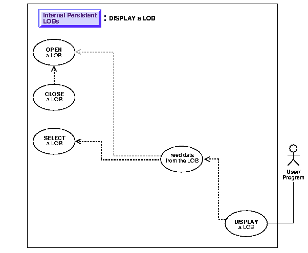

This procedure describes how to display LOB data.
The most efficient way to read large amounts of LOB data is to use OCILobRead() with the streaming mechanism enabled.
See Chapter 3, "LOB Programmatic Environments" for a list of available functions in each programmatic environment. Use the following syntax references for each programmatic environment:
As an example of displaying a LOB, our scenario stream-reads the image Drawing from the column object Map_obj onto the client-side in order to view the data.
Examples are provided in the following programmatic environments:
