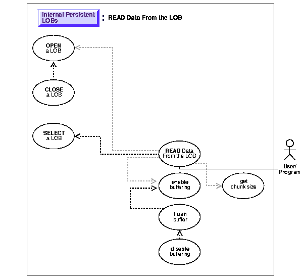

This procedure describes how to read data from LOBs.
The most efficient way to read large amounts of LOB data is to use OCILobRead
() with the streaming mechanism enabled via polling or callback.
When reading the LOB
value, it is not an error to try to read beyond the end of the LOB
. This means that you can always specify an input amount of 4 gigabytes - 1 regardless of the starting offset and the amount of data in the LOB. Hence, you do not need to incur a round-trip to the server to call OCILobGetLength
() to find out the length of the LOB value to determine the amount to read.
Assume that the length of a LOB is 5,000 bytes and you want to read the entire LOB value starting at offset 1,000. Also assume that you do not know the current length of the LOB value. Here's the OCI read call, excluding the initialization of all parameters:
#define MAX_LOB_SIZE 4294967295 ub4 amount = MAX_LOB_SIZE; ub4 offset = 1000; OCILobRead(svchp, errhp, locp, &amount, offset, bufp, bufl, 0, 0, 0, 0)
amount
' parameter after each OCILobRead
() call to see how many bytes were read into the buffer since the buffer may not be entirely full.
len
' parameter, which is input to the callback, will indicate how many bytes are filled in the buffer. Be sure to check the 'len
' parameter during your callback processing since the entire buffer may not be filled with data (see Oracle Call Interface Programmer's Guide.).
