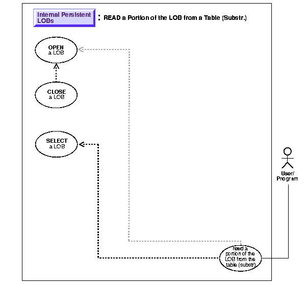

This procedure describes how to read portion of the LOB (substring).
Not applicable.
See Chapter 3, "LOB Programmatic Environments" for a list of available functions in each programmatic environment. Use the following syntax references for each programmatic environment:
This example demonstrates reading a portion from sound-effect Sound.
Examples are provided in the following programmatic environments:
