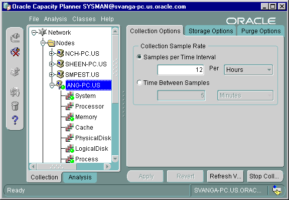

When you first connect to a service, Capacity Planner displays the Collection Options property page. The values you select on this page determine how often the Agent data gathering service will collect information about the selected service and save it to disk. On the Collection Options property page, you can set the frequency of collection samples using either of these two methods:
For example, to collect information 3 times every hour, select Samples per Time Interval, enter 3 in the text field, and choose Hours from the drop-down list.
For example, to collect information every 20 minutes, select Time Between Samples, enter 20 in the text field, and choose Minutes from the drop-down list.

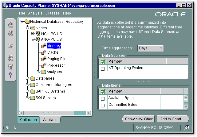

Figure 4-3 shows a typical collection class for a node service and the data sources and data items available for the class.
The following list explains classes, data items, and data sources in more detail:

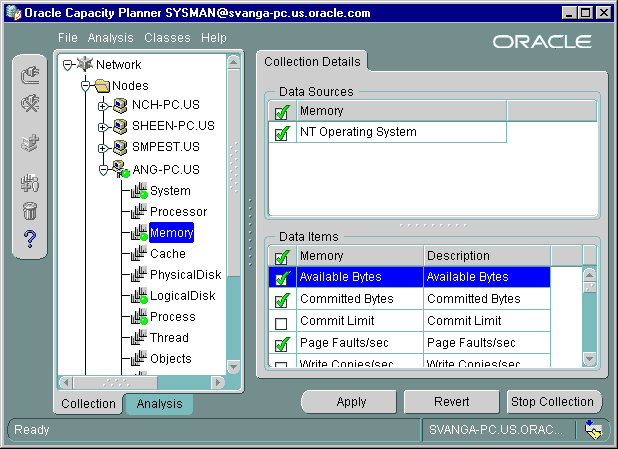

A class is a container for a particular category of data. For example, a node (or operating system) service might include the following classes:
When you select a service in the navigator, Capacity Planner displays the names of the classes below the service in the tree view.
You can collect data from none, some, or all displayed classes for a service. A class may also be a container for other classes, to provide logical groupings of the performance data at higher levels. For example, an I/O class may be a container for other more specific I/O classes.
In a class, each of the related statistics is referred to as a data item. For example, a LogicalDisk class might include the following data items:
A class can contain one or more data items. When you select a class in the navigator, the names of the data items and data sources associated with the data items are displayed on the Collection Details property page. Select the data items that you are interested in collecting.
A green check mark appears next to the name of each data item that is selected for collection. You can toggle the state of all data items between collected and not collected by clicking the Data Items column header that contains the check mark.
A data source is a description of where Oracle Capacity Planner can collect the data items for a class. A class can contain one or more data sources. When you select a class in the navigator, the names of the data items and data sources associated with the class are displayed on the Collection Details property page.
The type of data in the class determines the data sources for the class. For example, in a LogicalDisk class, the data sources might be the individual disks for the operating system (for example, disk1, disk2, and so on). In a CPU Utilization class, the sources are the individual CPUs for the host (for example, cpu1, cpu2, and so on). You can collect data items from one or more data sources.
When you select a data source, a green check mark appears next to the name of the data source on the Collection Details property page. You can toggle the state of all data sources between collected and not collected by clicking the Data Sources column header that contains the check mark.
After you select the data items that you want to collect from the available data sources on the Collection Details property page, click Apply to confirm your selections, or click Revert to cancel the selections.
When you click Apply for a class of data, Capacity Planner marks the icon for the selected class and the selected service with a green dot in the Collection view of the navigator panel. A green dot on a collection class icon indicates that one or more data sources are selected for the class. A green dot on a service icon indicates that Capacity Planner is collecting data for one or more classes in the service.
For example, in Figure 4-4, Capacity Planner is actively collecting data for the Processor, Memory, and Cache classes for node ANG-PC. Capacity Planner is not collecting data for the System collection class.

The Class Data Items table on the Collection Details page displays the data items in the user-defined class. Use the Class Data Items table to remove, modify, and add data items in a user-defined class.
Select the data item that you want to remove from the class, then click Remove. This removes the data item from the Class Data Items table and the user-defined class.
Select the data item that you want to modify, then click Modify, which displays the Add/Modify Collection Details page.
On the Add/Modify Collection Details page, you can change the label of the data item. You can also specify how the data item is derived. After you finish modifying a data item on the Add/Modify Collection Details page, the information for the data item is updated in the Class Data Items table.
Click Add, which displays the Add/Modify Collection Details page. On the Add/Modify Collection Details page, you can specify a label for the data item. You can also specify how the data item is derived. After you finish defining the data item on the Add/Modify Collection Details page, a row for the data item is added to the Class Data Items table.

When you expand a service in the navigator under the Historical Database folder, two forms of data are displayed below the service:
The classes displayed for the service are the collection classes for which data is available in the Oracle Capacity Planner historical database. You can select and view data from these classes by selecting a class in the navigator, specifying the selection criteria, and then clicking Show New Chart. These operations are the first step in creating an analysis.
Below each service in the navigator is an Analyses folder, which contains predefined and user-defined analyses. Predefined analyses are provided for some services. You can create user-defined analyses by selecting a class of data, displaying an analysis of the data, and then saving the analysis. You can also create a user-defined analysis by using an existing analysis as a template, making modifications to the analysis, and then saving the analysis under a new name.
To browse the collected data for a particular service:
You are prompted for the credentials for the historical database that contains the collected data that you want to analyze.
The navigator displays the:
To view an analysis chart for a selected class of data:
Capacity Planner displays the property page for the class (Figure 4-6).
Capacity Planner displays the Analysis window, which contains two or more pages. The Chart page displays the chart. The remaining pages are Details pages. A separate Details page exists for each class from which one or more data items are included in the analysis.
For information about the Analysis window, choose Window from the Analysis window Help menu. For information about modifying the analysis or changing the way the data is displayed, see "Working with Analyses" .
After you view an analysis for a class of data, you can save it as a user-defined analysis to view later.
To save the analysis:
Performance Manager places the new user-defined anlaysis in the Analyses folder of the navigator panel.
When you select a class in the navigator panel in analysis view, Capacity Planner displays a property sheet that contains options available for selecting data from the Oracle Capacity Planner historical database for that class.
Before you display a chart of the collected data you must:
For example, select Hours if you want to analyze hourly data, Days if you want to analyze daily data, and so on.
A check mark appears next to each data item that is selected for analysis.

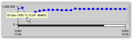

To view the value for a data point (that is, one plotted point of a data item) on a line in an analysis chart, position the cursor over the data point. If there is a point beneath the cursor, Capacity Planner displays the date, time, and value for that data point displays in a box above the point (see Figure 4-7).

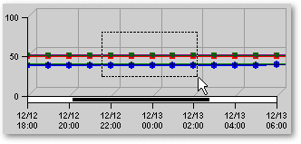

To view more detail or less detail, click the Zoom In and Zoom Out buttons on the Analysis Chart window toolbar.
You can also zoom in on a very specific part of the chart by dragging a rectangle around the area you want to magnify (Figure 4-8). Release the mouse button to zoom in on the selected area.

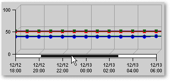

Often, the chart data will extend beyond the width of the Analysis Chart window. You can view the data that extends beyond the edges of the window by resizing the Analysis Chart window or by scrolling to the right or left.
To scroll the Analysis chart window:

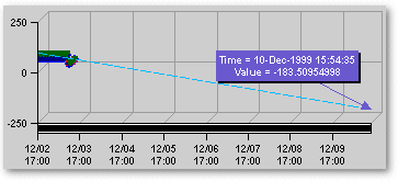

A trend analysis infers or estimates future values by projecting and extending known values. Oracle Capacity Planner can perform the following types of trend analyses:
In a trend analysis to a point in time, you provide a goal time for a data item. Oracle Capacity Planner uses the specified values in the historical database to project the value of the data item at the goal time.
A trend analysis to a point in time is used to answer questions such as, "How full will this disk be at the end of the year?"
In a trend analysis to a value, you provide a goal value for a data item. Oracle Capacity Planner uses the specified values in the historical database to project the time at which the data item will reach the goal value.
A trend analysis to a value is used to answer questions such as, "When will our CPU utilization reach 95 percent?"
