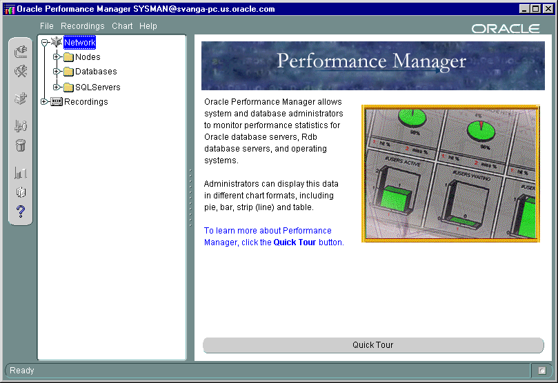

The primary component of the Oracle Performance Manager user interface is the main window (see Figure 3-1), which contains two panels. The navigator or tree panel appears on the left side of the main window and the property sheet panel appears on the right side. When you select an item in the navigator panel, the property sheet panel displays the properties of the selected item.
When you first start Oracle Performance Manager, the navigator panel displays the service type folders and the property sheet panel displays the Performance Manager welcome screen.
A vertical toolbar appears on the left side of the window and a menu bar appears across the top of the window. For more information about the buttons in the toolbar and the commands available from the Performance Manager menus, choose Window from the Performance Manager Help menu.

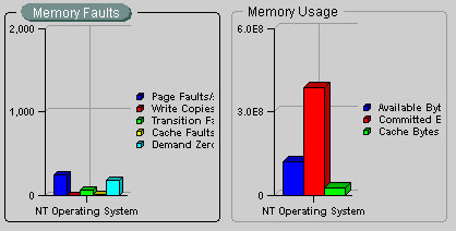

Some types of data include a chart group, which is two or more charts that are displayed within a single Chart Display window. You display a chart group the same way as you view any other chart (see "Viewing Performance Manager Charts").
You can display a special chart group that contains the Overview Charts for a selected service:
Performance Manager displays a chart group containing some key statistics most likely of interest to database administrators monitoring the selected service.
Charts in a chart group are displayed within a single window. You perform actions, such as setting options and displaying drill-down charts, on one chart at a time within a chart group. The currently selected chart within a chart group window is identified by a highlighted title. For example, the Memory Faults chart is the currently selected chart in Figure 3-2.
